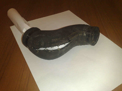

Anyway car looked right and engine sounded ok surprisingly, (although I'll give it a while to settle down again, before getting to happy), so I paid the bill and left. Drove around for a bit and the car pulled and drove like it should, so I got on the M4 and headed for home. After 70ish miles of trouble free motoring I looked out the back window to see a plume of steam (think entire coolant leaving the car quickly) and the temperature started to climb again. This time I stopped the car before the temperature got to the red and shut it off. Called the breakdown people (again) and got them to recover me. Since I was only 30ish miles from home I got them to recover me there (cost about £80 extra mind, might think about extending my breakdown cover next year). Phoned the garage that had done the work looking to kick off but they had all gone home for the day.
The next door neighbour has a friend who is a mechanic for Rover who happened to be in the area so he popped round and had a look at the car for me. After popping up up on some ramps and looking at the back of the engine, he reckons that a pipe is leaking and not the water pump. I'm did kinda suspect that is wasn't the same problem as the water did seem to be coming from somewhere slightly different this time. It will make my life much easier if it isn't the water pump as I won't have to get into a massive argument with the garage about it.
So another question, what part is it that I need to order? X20XEV engine, apparently it is an s shaped hose from the tank to the back of the water pump / block... I'll hopefully get that fitted this week, and then I can see what the next thing wrong with the car is
