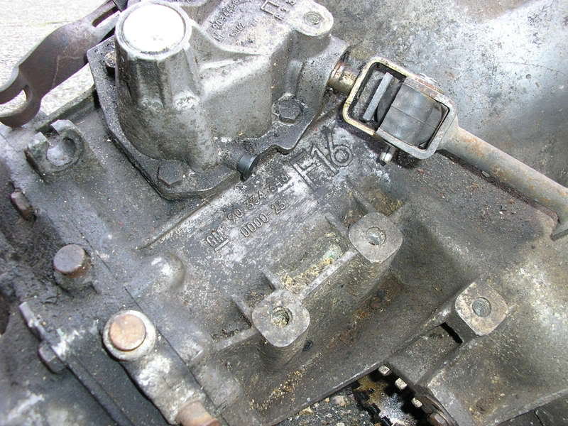

My car is a 1995 opel vectra 1.6 GL 8v , how wud i tell which gearbox it is??
, shud it say on the top of gearbox , F16 etc>?
I just assumed my own gearbox was F16 but i'll hav to double check wen i get home later. The 2 gearboxes are different to look at so the 1 in my car now must be the F13

the gearboxes usually have a plate with the gearbox code printed on it.

checked 2day and gearboxes are definitly different cos theres a smaller main shaft in my original gearbox . So 2moro iafternoon im gonna start and hopefully get it changed , any more info i shud know b i start??

From reading threads on various forums, it appears that the number after the F is the amount of force that the gearbox can handle
F16 = 160 lb/ft
F20 = 200 lb/ft
I also believe that the innards of the F20 is just an unprated but identical version of the F16.
There are also 3 versions of the F16,
Standard wide ratio, SRi version with close ratio, and you can also get an Astra GTE (mk2) super close ratio.
On some gearboxes, there is a plate with the following details..
Four digits - box ratio type - box ratio value..... eg
1234W412 = box number 1234- wide ratio box and ratio = 4.12 : 1
****Cxxx = box number **** - close ratio box and ratio = x.xx : 1
Note though that not all boxes have this coding on the end plate.

thanks , must check to see if the box im puttin in is close ratio or other .

Re: 1.6 to redtop conversion problems!!!!please help
every gear , but a friend said its suposed to be like that , i'll know wen i get the hair off the jacks . Wen i fitted the driveshaft i got i went to put on the nut thats goes at the end of drive and it would not thread , think i'll take the drive to a garage and get the boots renewed too .
I think the thermostat housing part will be here on wednesday
