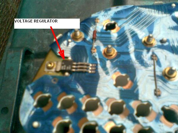

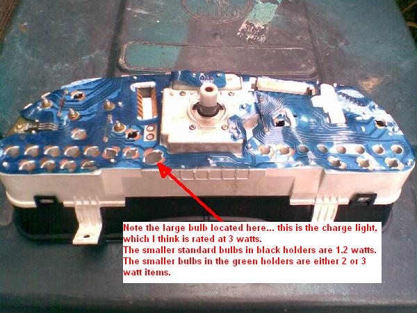

Like I said - Voltage is too high.
So as suggested you should check
1) Voltage regulator on the back of the instrument cluster
2) The Battery light, as I believe the alternator uses the bulb in some way as a reference for charging / output voltage. I do stand to be corrected though.
3) You may need your alternator checking - or at least the components on it.
If you are unsure how to check and fix these items, then try tracking down your local auto electrician.
THE VOLTAGE REGULATOR
THE REAR OF A STANDARD INSTRUMENT CLUSTER.

The regulator on the back of the instrement cluster won't affect the voltage from the alternator, it is there to stabilise instrement readings. The battery light is fed with 12v which is earthed back through the alternator to bring the light on when not charging. This voltage (IND) also feeds the windings and without it the alternator doesn't start charging, although once charging it will continue if it's taken away.
The regulator on the alternator will be the one that is suspect, if you measure voltage across the battery terminals with the engine running at around 1500rpm you should be seeing somewere between 13.5 and 14.5 volts. Lower than 13 will give you probs as will higher than 15. Also remember to check this with a load, turn on the headlights and heated rear screen as a weak alternator or poor connections will often look ok until loaded.
Overcharging at 17v is very bad, and should not be left. This will lead to other problems, in a worst case situation an exploded battery or even fire, get it sorted for your own safety.
