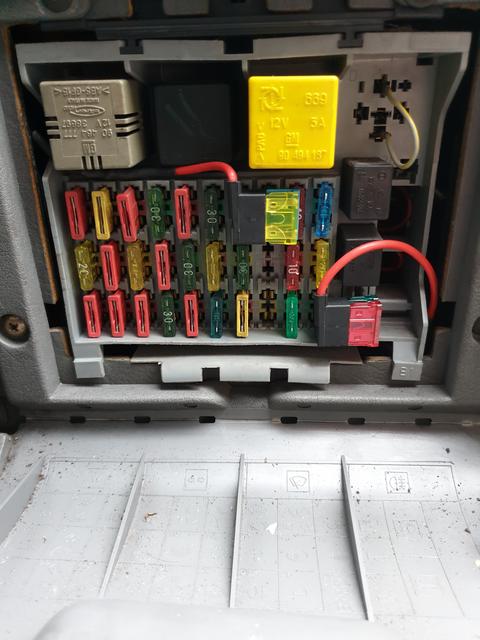

RELAYS IN THE DASH FUSE BOX
There are 6 relays in the fuse box.
1 to 4 are from Top Left to Top Right,
5 is below 4 and 6 is below 5.
My 1994 Fuse Box and Relays shown.
In order -
1 - Grey warbling lights on warning sounder.
2 - Black flasher unit with extra pin for tow-bar tell-tale on dash.
3 - Yellow Omega-B variable intermittent wiper delay relay.
4 - Rear Fog bypass wire.
5 - Front Fog Relay
6 - Fanfare Relay.
Here are the "
Proper" listings.
Model Years 1989 to 1990
1 = H19 - Headlamps on Warning Buzzer
2 = K10 - Turn Signal Flasher Relay
3 = K8 - Wiper Interval Relay
4 = K89 - Rear Fog Lamp Relay or Bypass Wire
5 = K5 - Front Fog Lamp Relay
6 = K1 - Heated Rear Screen or K63 Dual Horn / Fanfare Relay
Model Years 1991 to 1995
2 = K8 - Turn Signal Flasher Relay
3 = K5 - Wiper Interval Relay
5 = K1 - Front Fog Lamp Relay
6 = K10 - Horn Relay or K63 Dual Horn / Fanfare Relay
