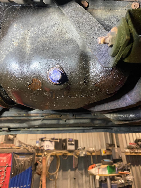

I had an advisory last year for a f/n/s tyre wearing on the outside. Bit p'd off with that, i've never had that before and the tyres aren't old. I wonder if all these potholes and speedbumps are the cause, knocking the tracking out?
I know i need some welding done and have a leaky oil pan;
More pain

Ouch that hole appearing in the subframe looks like it's in exactly the same place as mine started to 'go' (pics 1,3 and 4).
You might better trying for another subframe, or better, one of the already coated painted ones available. I still have my old subframe (but it's the part-open, not fully boxed-in type), but it's better than that one (repairable) as the rot was only in one place. Free to anyone who'll take it away

Re: Matts CDX - Work In Progress.
That subframe is borderline past it, but getting replacements will be hard. Very wet engine, are you sure its the sump leaking and not the gaskets?
It could even be the weakened subframe causing the tire wear when I think about it.
Hopefully you'll get it sorted.

thomas wrote: ↑Fri Feb 21, 2025 7:24 pm Ouch that hole appearing in the subframe looks like it's in exactly the same place as mine started to 'go' (pics 1,3 and 4).
Aye it's not looking too cute. Hopefully I can get through the mot this year, probably second time again thoughEnvoy CDX wrote: ↑Sun Feb 23, 2025 8:06 am That subframe is borderline past it, but getting replacements will be hard. Very wet engine, are you sure its the sump leaking and not the gaskets?
Sorry, I should have been more specific about the leak, it is the sump gasket leaking at the front. Personally i'd have pinched the bolts up a little and see what happened.
I do have most of the parts i need, bought years ago at better prices. The x20xev couldn't be just a simple cork one of course, that would be too easy, it had to be metal and rubber one requiring sealant
I have victor reinz gasket and sealant, a perfect condition oil pan with a sensor (that's hopefully working, i intend to test it). The downpipe needs removed to do this apparently so I'll need to replace that too, it's been temporarily patch welded recently.
It's been a couple of weeks since i've had to open the bonnet and after seeing pics in my postimages gallery i wonder if my top strut mounts have gone already. Maybe bilstein gas shocks and sports springs have taken a toll? I'll let the mot tell me, might as well get all the pain at once
It will pass this year, eventually. After that who knows?
At no point in my car ownership did i think 'what if i'm not fit enough to do the work anymore?'. That time has come and it p's me off that I have to pay a fortune for repair work when my mantra was prevention is better than cure, hence buying so many parts in anticipation of future problems that would have been fitted.
The car has now become a serious money pit for these reasons yet i still can't give it up, i can't envisage me driving anything else. What's wrong with me

That subframe looks toast, I did see a couple on facebook marketplace recently and the new one I got was from here:
https://achse24.de/ger_m_PKW_Opel_Vectr ... 2_3%5D=290
Not a bad price considering it's basically a brand new subframe fully coated / painted.

Nice find Andy, i've never heard of this site.
I'd gladly pay the price but sadly they're all 'not available'
Would I be right in assuming astra f parts are suitable? It might help with my search. What i really need to find are reliable part numbers for the cavalier, i can't afford to buy the wrong thing.

I didn't notice they weren't available, might be able to put your email address in to get a notification if they do become available, but it's when if ever they do. For part numbers you can check here:ilovedmymantas wrote: ↑Mon Mar 03, 2025 2:28 am Nice find Andy, i've never heard of this site.
I'd gladly pay the price but sadly they're all 'not available'![]()
https://opel.catalogs-parts.com/#{clien ... group:1-1}
There's a list of numbers for different variations but I'd reckon probably most of them would fit the bill; if anyone knows any different hopefully they
can chime in with more accurate part numbers per model. I know there is one type that the legs are hollow and one that's got a plate built over it. I think that one might be for the bigger engines, 2.0 and above. My 1.8 had the hollow type frame leading me to think 2.0 and above. This is the one I bought and I can't see any discernable difference in them apart from the strengthening plate on the legs of the subframe.
They do come up from time to time on marketplace so worth keeping an eye out there.
Cheers
Andy
P.S. I do have a spare subframe lying round the back of my garage, if your're really desperate I could dig it out for you.

In addition to the previously mentioned parts i have a gm oil filter and have just picked up 5l of Castrol 10w40 magnatec for £31.49 - halfords had an online offer of 4l + 1l free and an email discount voucher for 10% off, bargain!
All I need now is a downpipe to get the car almost back to normal-ish. The main problem is i need to get it all done at once.
No point changing oil& filter if there's a leaky sump gasket, if the downpipe's coming off then i might as well replace it too.
Vibration is seriously doing my head in. I do really want to refurbish the cam followers/hydraulic tappets (they must be effecting emissions?) as i'm sure two or three are sticking but i just don't have the ability or confidence to do it anymore![]()
It would be nice to get all the mechanical things fixed for a while, then i could focus on the declining bodywork for a change
When I initially thought 'this car is my last' I didn't expect health and inability to factor into it.
Despite the looming costs i still can't see me driving anything else though, just not as pretty as i'd like.
I'll probably need a new tyre for the mot.I like to keep them all the same, this time goodyear efficientgrip, expensive but worth it.
But its always nice when cars get a nod of approval,tyres are important but that subframe is questionable sadly. Hope you get it through another year though. But based on the type of work needed, its almost like its time to pull the engine and do everything at once. Fingers crossed you can get a good price on the downpipe, and labour if you're not doing it yourself, the sump goo takes forever to go off though - the genuine gm stuff is damn sticky.. I mean the over-alls I was wearing went in the bin as they stuck to themselves and yeah... fun :/
