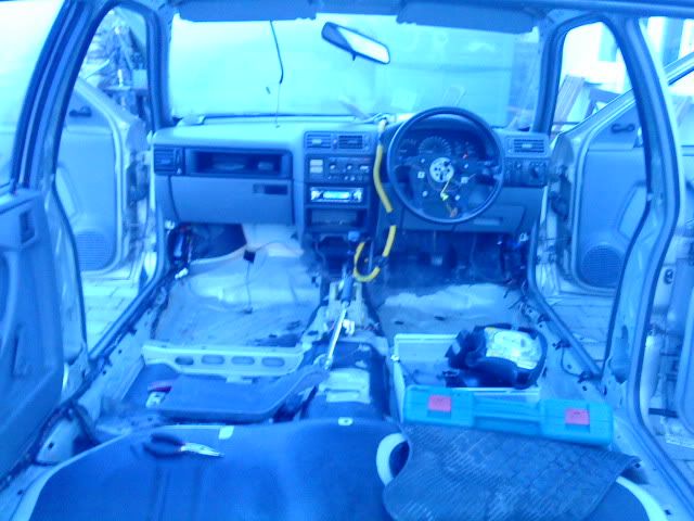

This is how the car started off:
Back at mine:
Let the fun begin!
First off, some decent rubber.
Boot full of crap
Under powered engine:
Temporary improved intake
What it will look like lowered
The only rust patches:
And how the car now looks
I hate sound proofing
My steering wheel in place
Sorry for the random assortment of pictures but its late lol, but you get the idea

My plans are to make it a super light cavalier, today i removed the bumper (well ripped it off lol) wings, bonnet etc. There was 1 bolt for each wing inside the car behind the electrical boxes down by your feet if sat in the car.
Found that the cavalier has a "charcoal canister" like on the Rovers.. But it looks more of a pain to remove.
Noticed the battery tray is stuck to the chasis so that will be removed and have the battery in the boot and also the washer bottle inside the car. I like minimal engine bays.
Iv got the steering wheel off and removed all the bolts rob said, how do i remove all the controls and cluster to disconnect them so i can fully remove the dash?
Also has anyone ever removed the charcoal canister? It seems to have a fuel trap, connects to the inlet under the butterfly and connects to the brake vacuum pipe to, but i cant see where the other black pipe goes to from the canister. Its amazing how much weight is actually coming out of the dam car! Theres foam everywhere lol. Il get up some pictures later im just going to finish removing as much as possilbe before it gets dark..

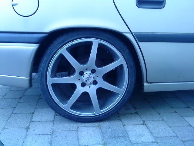

And hell no they are ugly lol, these alloys give me 30mm more tyre coverage and look good.HAIRIBO wrote:If you want a fast light car, get shot of those 17" Dotz. and stick to the standard ls steel wheels. Smaller rolling raius so quicker accleration and they are much lighter.
Re: Jamies Stripped Cavalier..
Pimpvehicle wrote: And hell no they are ugly lol, these alloys give me 30mm more tyre coverage and look good.
But they are heavy as F@ckl and your making the car slower so Your just wasteing your time taking all the dash out. Plus the stopper on the accelerator is to stop the butterfly opening too far and closing it self again.

All that will be in the interior is, Dashboard, seats, front door cards and centre console all the rest will be ditched. Will alloy plate the roof to loose the sunroof, exhaust heat shields have gone, almost everything that can go will

Did a little more work today, really do need to get some pictures up! Today i;
Removed both back door cards finally
Removed rust from front slam
Removed rust from bumper mount
Painted inner arches black
Painted slam panel
Painted bumper mounts
Removed all the rust from the drums
Painted drums black
Got a lil more glue off the car.
Slow but sure progress. I promise to get some pictures up soon, and thank you to everyone for the advice that has been given and the help.
