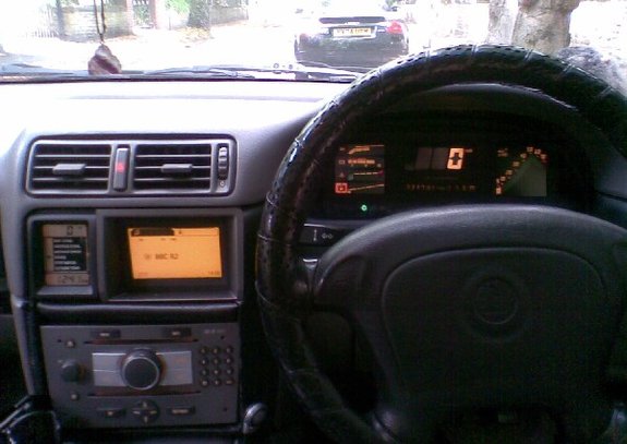

Well minor update..
Fitted the newer Digi Dash today... I do prefer this version.
Also quite odd to see the original colours after all this time.
Incidentally, I read the Astra Owners Manual last night. I have a full user pack, which I bought years ago for info about the Digi-dash.
Anyway, it says somethings on the lines of...
"The oil light may flash or flicker at idle when the oil is at full running temperature. This is not a problem, as long as the light goes out as soon as you come off idle."
Virtually the same wording that PlanetC (Paul) has been telling me for six months.. :geek:
So here it is this evening.. note the torque tick rev counter / tacho

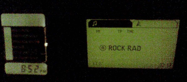

Also today, I looked at my Sat-Nav / Radio display as the top half has been going off.
So I took it from my central dash panel and split theinternal gubbins from the casing.
All the solder joints and components looked in perfect condition... :scratch
But Idid notice that one of the two ribbon cables to the screen was quite loose.
I rechecked all connectors, and then re-fitted them all, including the ribbon connectors and clamp bars.
Re-assembled the display and refitted to the central dash panel..
Turned on, and we have a full display screen - woohoo

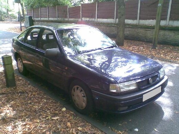

As people often tell me..
No pictures mean it didn't happen, so I took some nice pics whilst I was parked on a leafy side street.
So, the Cav in a leafy lane :cool
and the dash all repaired / replaced

The Original Digi-Dash conversion was about a day - but then I am really anal about soldering and sleeving my joints..
The CD70 Sat Nav was probably a full day, the hacking of the dash was done in a very ad-hoc style, but one afternoon I simply took a hacksaw to my centre section, until my double din unit would go in.
The one-touch sunroof and the delay bug-eye map lights, well about three hours work.
