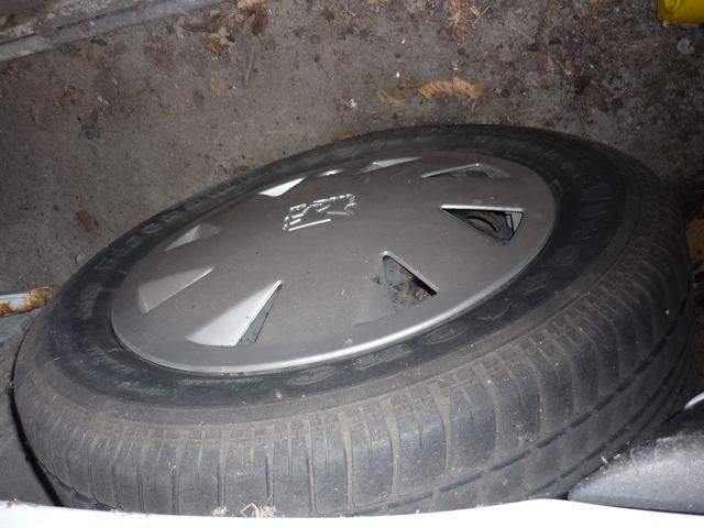

Hi,
here are some images of my Grandpa's dusty Vauxhall.

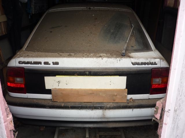

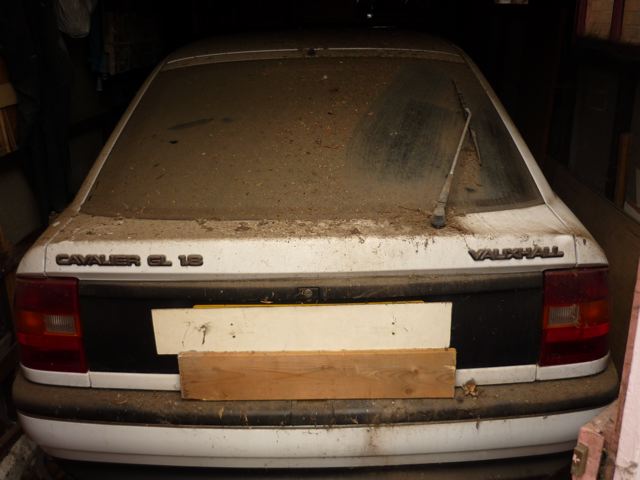

now THAT's a lot of dust! ha! :lol: i hope you've got the key for that steering wheel lock... :p
Re: Images of my Grandpa's Vauxhall
humbucker wrote:now THAT's a lot of dust! ha! :lol: i hope you've got the key for that steering wheel lock... :p
easy to get those off, less than 5mins if your nice

Yep I definitely have the keys to the steering wheel lock!

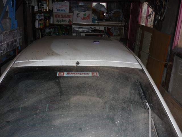

lots of dust!

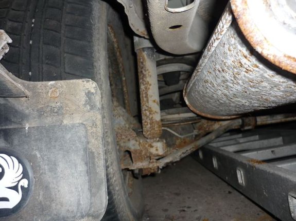

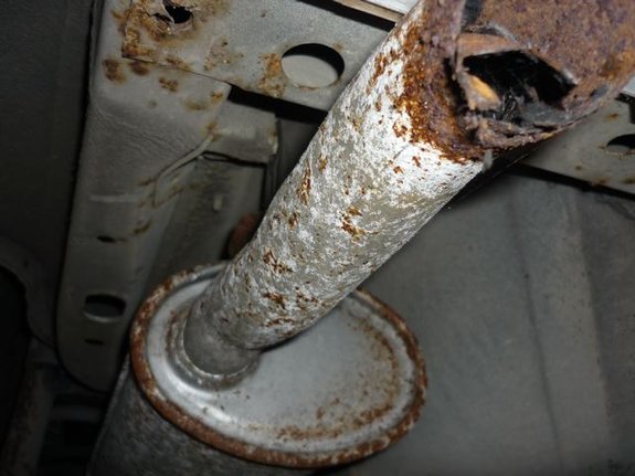

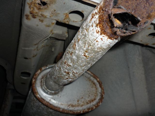

Looks like damp has got inside the garage, and it shows underneath the chassis. Unfortunately for such a low miler, the rust is setting in. However it's not a disaster, looks only surface deep to me. New exhaust, rear anti roll bar, bushes, bit of sanding and a good few coats of underseal and she'll be back in her glory in no time. And a good wash as well. :thumb

hmmm yeah the rust is a bit of a worry, but hopefully isn't too deep!
Doesn't look it from the pics.

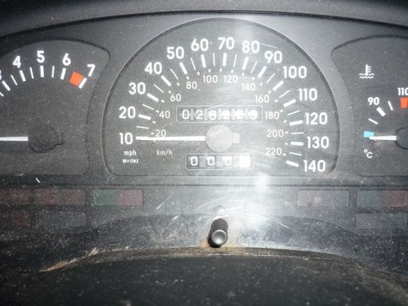

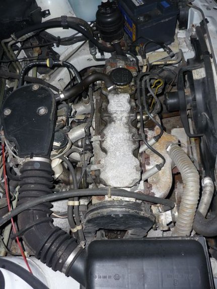

Give her a good clean over, inside and out to make sure all the seals don't get too brittle and start peeling away. Window and door seals, as well as sunroof. Is the cam cover gasket leaking? Surprising, if it is, at that mileage.
Cavalier342 wrote:Doesn't look it from the pics.
i wouldnt be surprised if an engine thats been sat around for that long will need all the gaskets replacing as a matter of course. theyre either going to be brittle or compromised. engine will need more than a little service.

Looks OK but will need a lot of time and effort putting into it, plus a fair amount of money, new exhaust, tyres, cambelt, seals, etc but worth it in the end. Going by the pix i`d be wanting a peak at the cambelt before trying to start it and change all fuel lines too.
