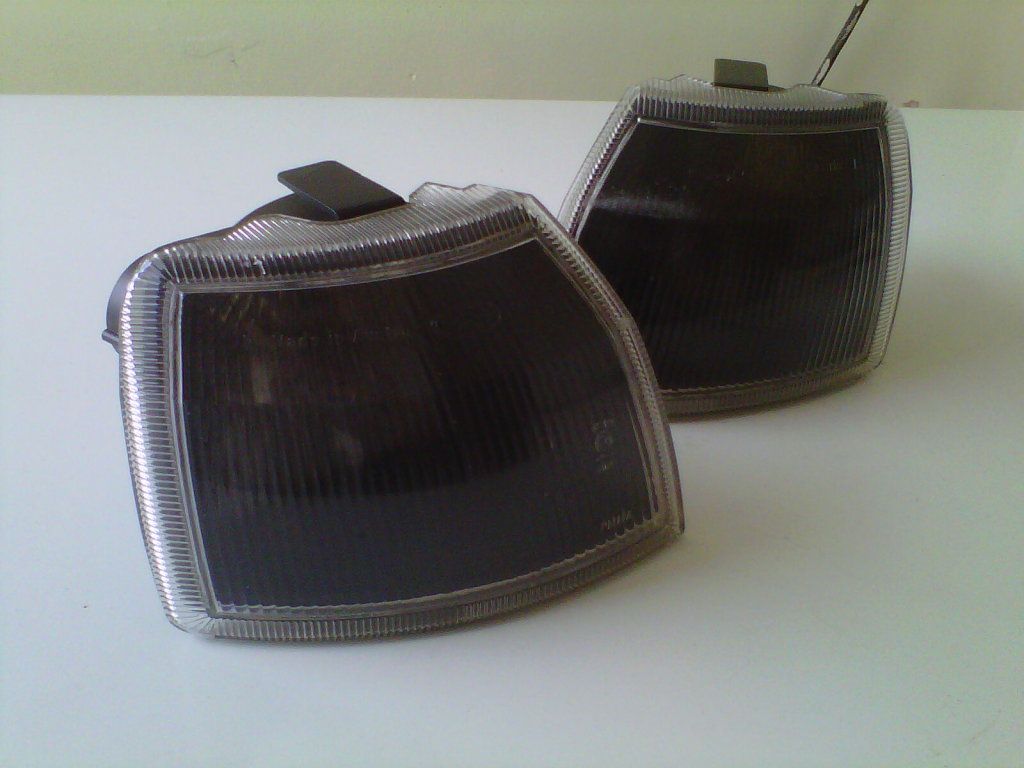

Started and finished my new indicator tinted lights today, well happy with the results. Turned out very dark!

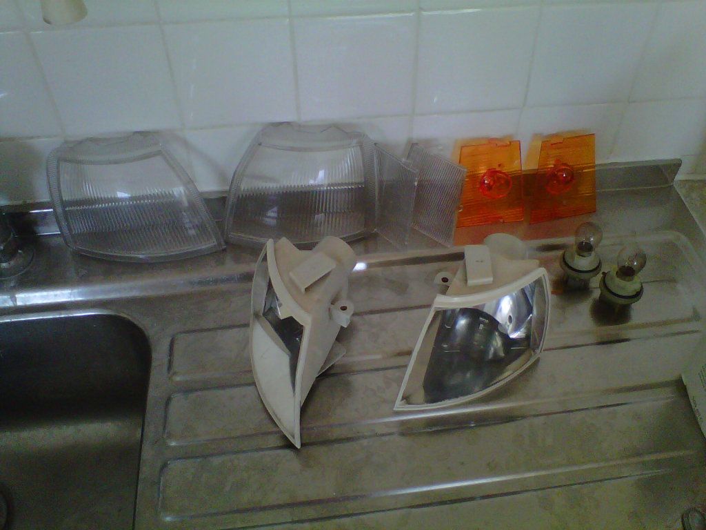

So step by step, here's how I did it this time

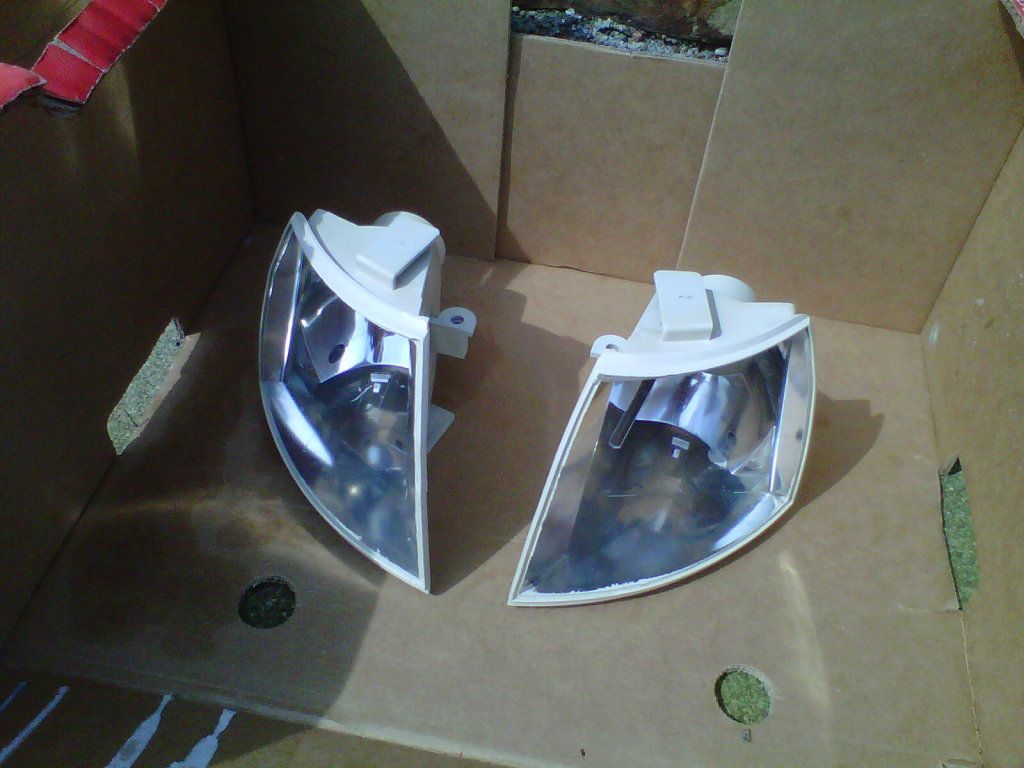

First of all, I soaked the lights in a sink of hot hot water until they were submerged and left them in there for an hour or so. For me this worked a lot better than the hair dryer I used for the last set I did. Not a single crack
Although they didn't just pop off.

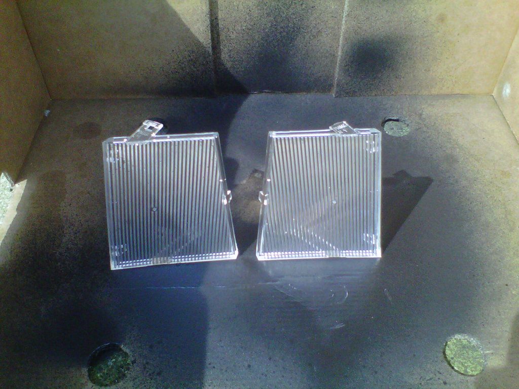

Took out the orange lenses and binned them and sprayed the whole shells black...

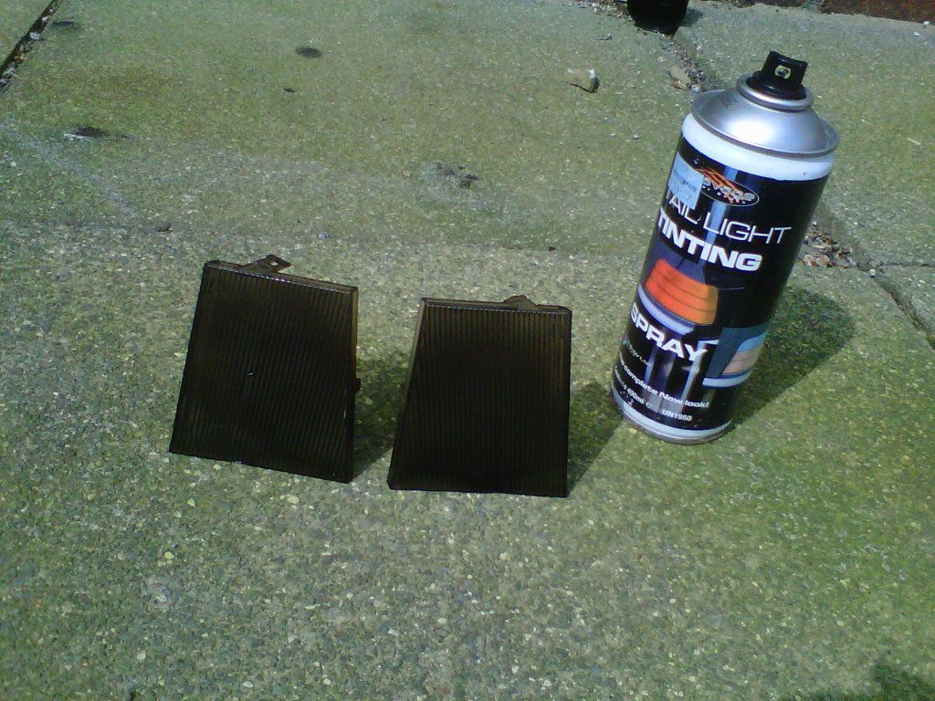

I decided to keep the reflective lenses but instead of just popping them back in (where they would be very noticeable against the black shell later) I sprayed them both black with tail light tinting spray. Although I removed the orange lens, I've bought a set of amber bulbs to replace them.
And the pair finished
Just got to wait for the amber bulbs to arrive now and then I can see how they look against the painted headlights! Will upload some photo's when they're fitted and working

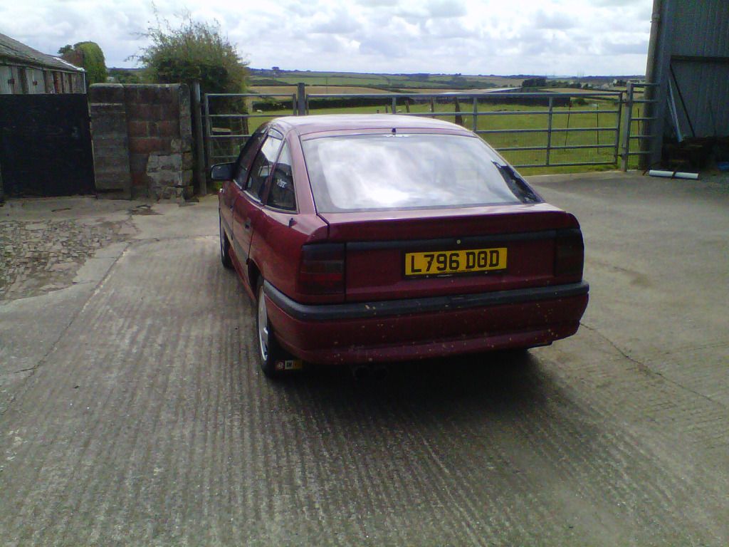

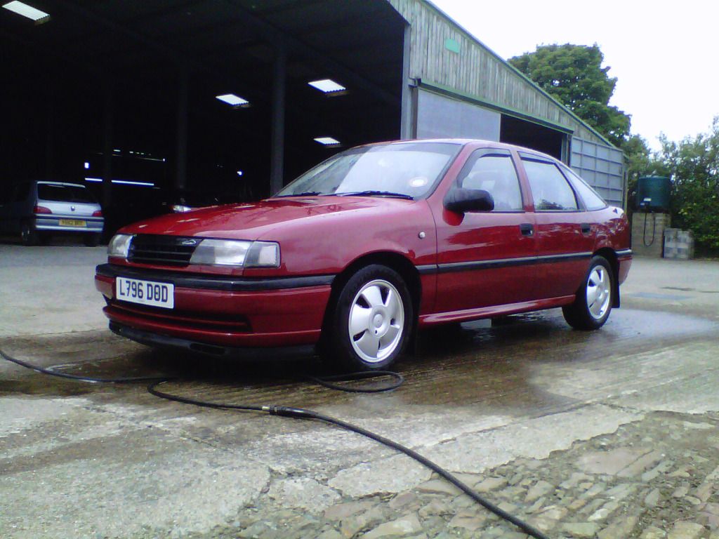

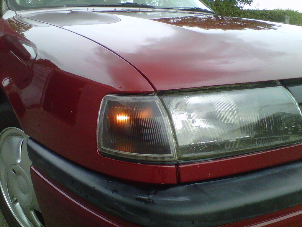

Gave it a good wash down and shampoo at the weekend after parking in a muddy field in Bude, I also tried out and fitted the new modified indicators I sprayed up.
Muddy
Clean
I also finished the rear panel that I had been working on for quite a while now on and off, it isn't an amazing job but it looks better than the faded mess and bubbling arches that was there before. You can see how the rear door has faded too so it doesn't match up too well against it. But not bad for a first attempt?
Here's the indicators, old vs new...
And the new bulbs

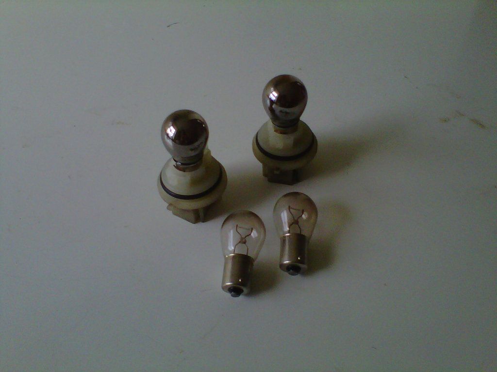

Looks awesome and exactly how I wanted them to look, but unfortunately an unsuccessful mod as the amber bulbs do not shine through bright enough to consider them legal lol... So I'm going to play about with them a bit more, I'll probably take the clear lens out of the old and put them in these new, the bulbs don't shine very bright at all either... perhaps a combination.

Ye, the Silvatecs work better on non-smoked indicators like mine.
They aren't as bright as regular bulbs but completely lose the amber yoke effect... If it shines amber, it's legal, there's no specification of brightness.
