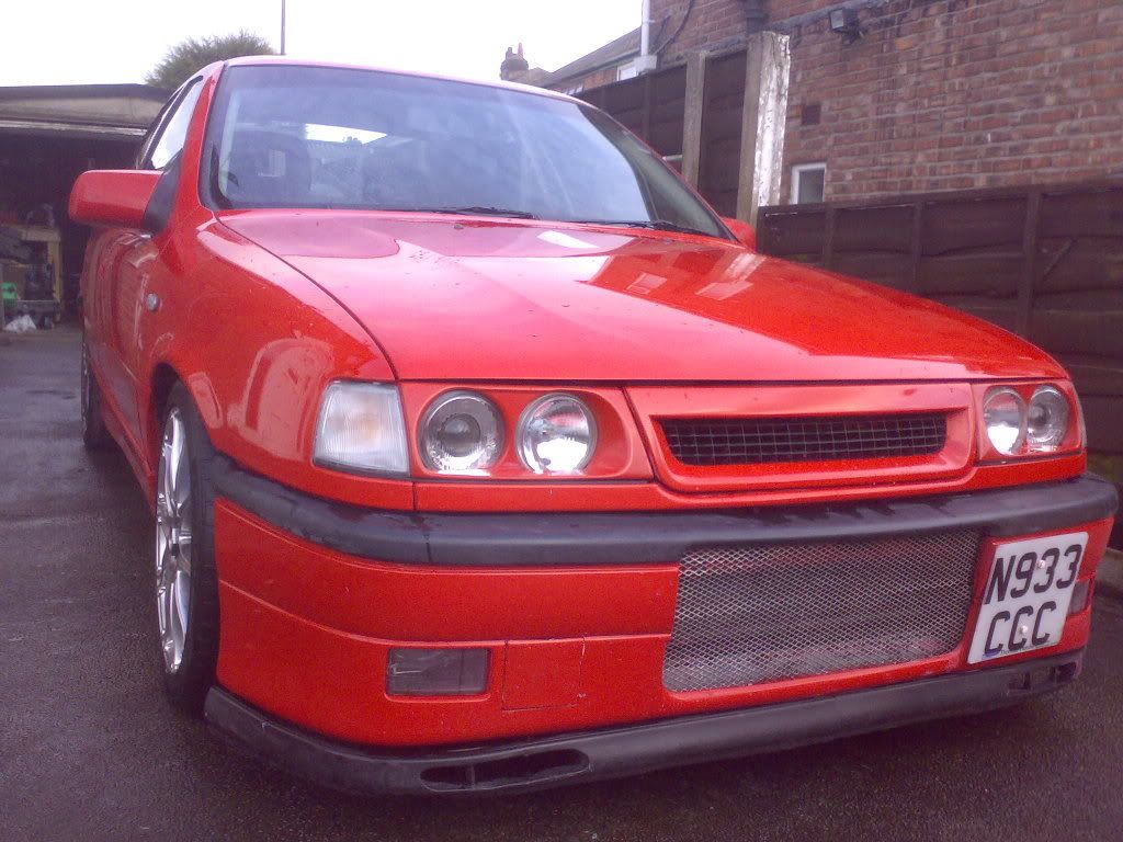

Todays progress,
Removed the headlights indicators and grill, to give the coloured bits a polish and a clean up.
Gave everything behind the lights a clean up as it was a bit grubby and may as well while it was all off.
Took the surrounds off the lights and noticed that they were set to LHD- well done last owner, theres was 3 screws, and there is a marker you just loosen the screws right off and twist the unit till its on rhd, took 2 mins to do one side and about 10 to do the other as the range adjuster was in the way, but at least its right now
Removed the coloured panel off the grill to give it a clean and remove the bits of overspray off the center section (not sure why they didnt do that when they painted it but its done now)
Removed the rubber seal from under the lights and fitted it back to the panel as it should be rather than having a gap at the bottom of the lights.
Fitted the preface indicators from vboa and the front end looks a lot better and less lashed together than it did.

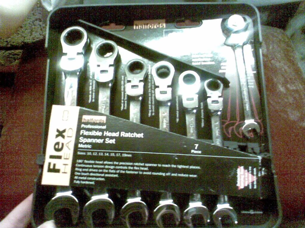

Not done anything but a mate of mine rang me last night and long story short
http://www.halfords.com/webapp/wcs/stor ... yId_165572
Got a set of these spanners in metric for £20
Words fail me at your jamminess!
Re: Gaz' Cav.
Squig wrote:Words fail me at your jamminess!
I did have to take a detour to wigan to get them, but as it was anitas petrol its not the end of the world.
They even come with a little rack for them to sit on.
saves me having to get something else for the toolbox that i need.
*ive just realised those are the fixed end ones and ive got the ones with the flexible heads :D
apparently they were at £15 retail but cos he used his trade card it added £4 somehow (i let him keep the change) , but either way still cheap and from what terry told me there are next to non left in the country.

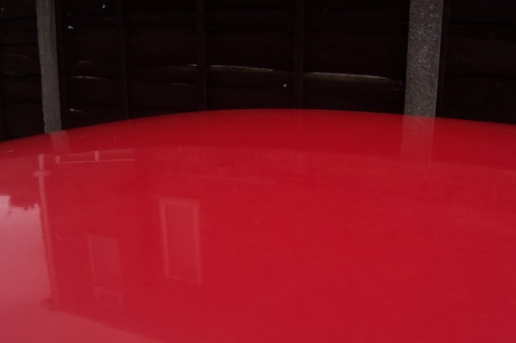

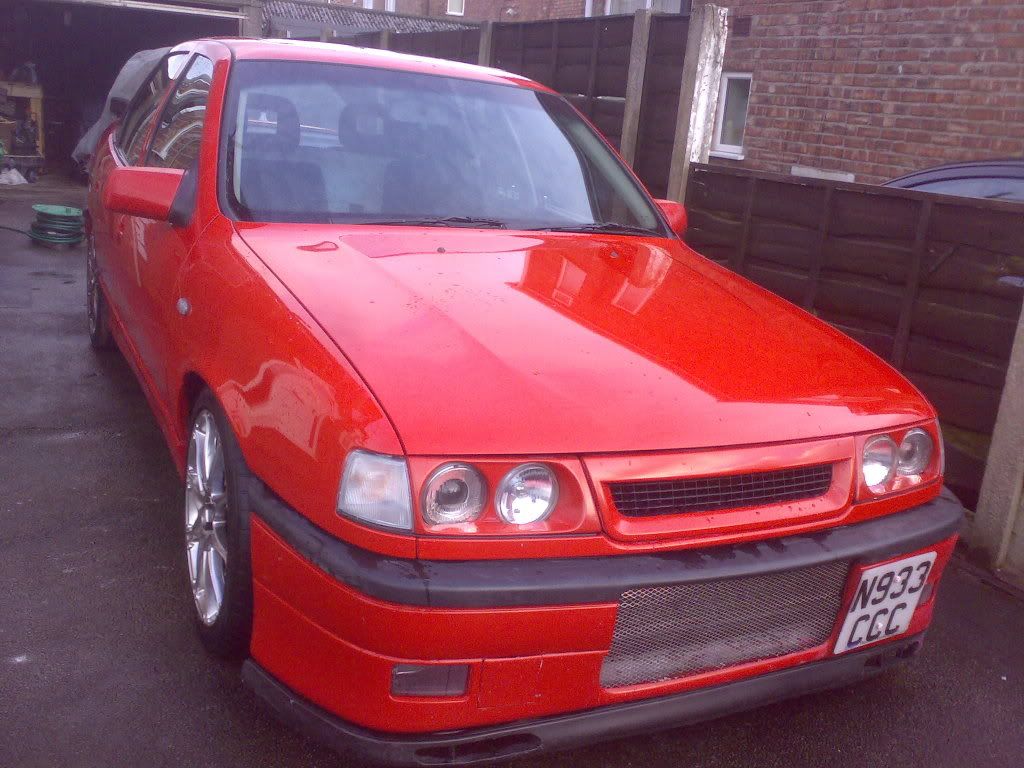

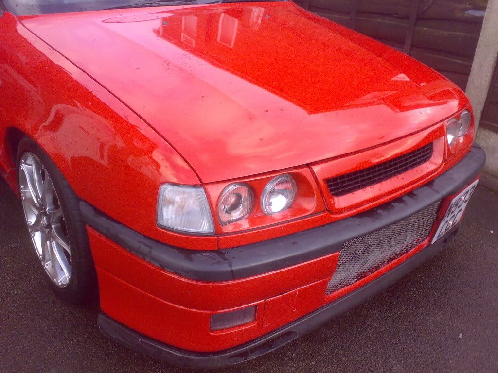

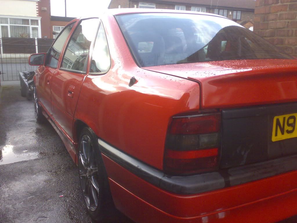

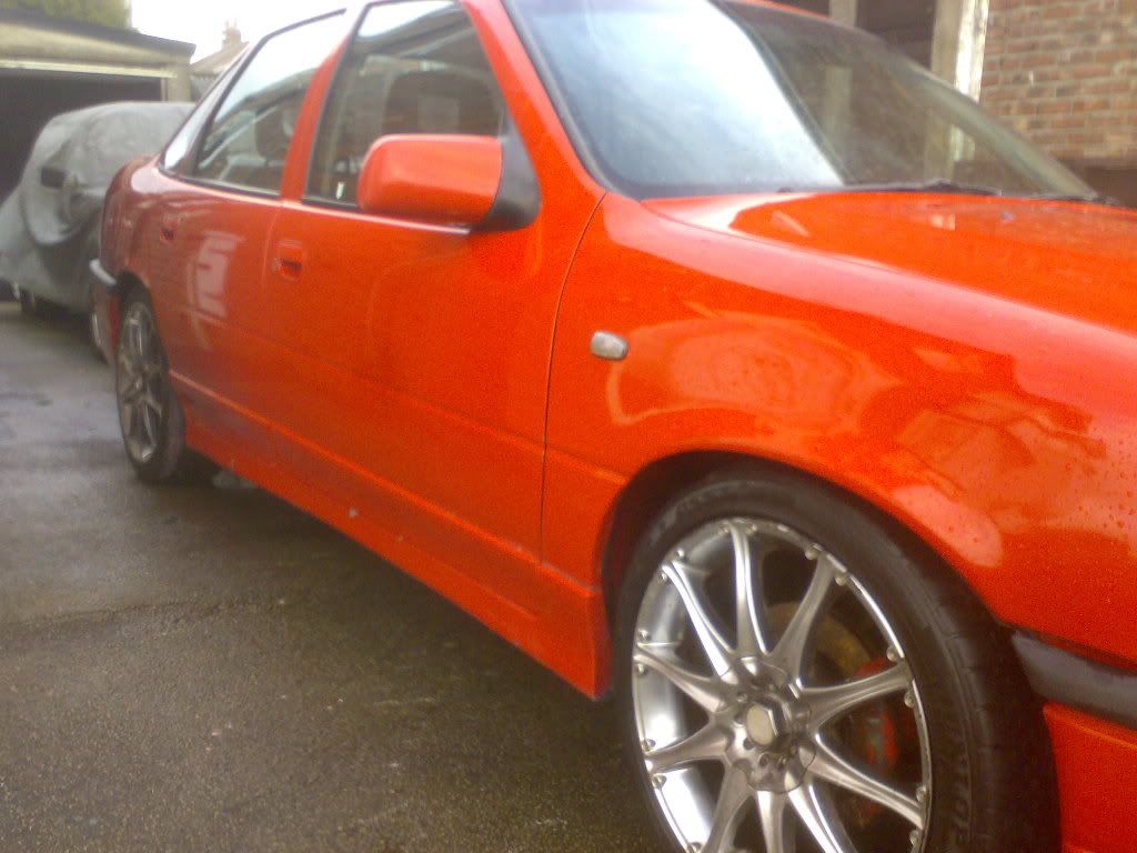

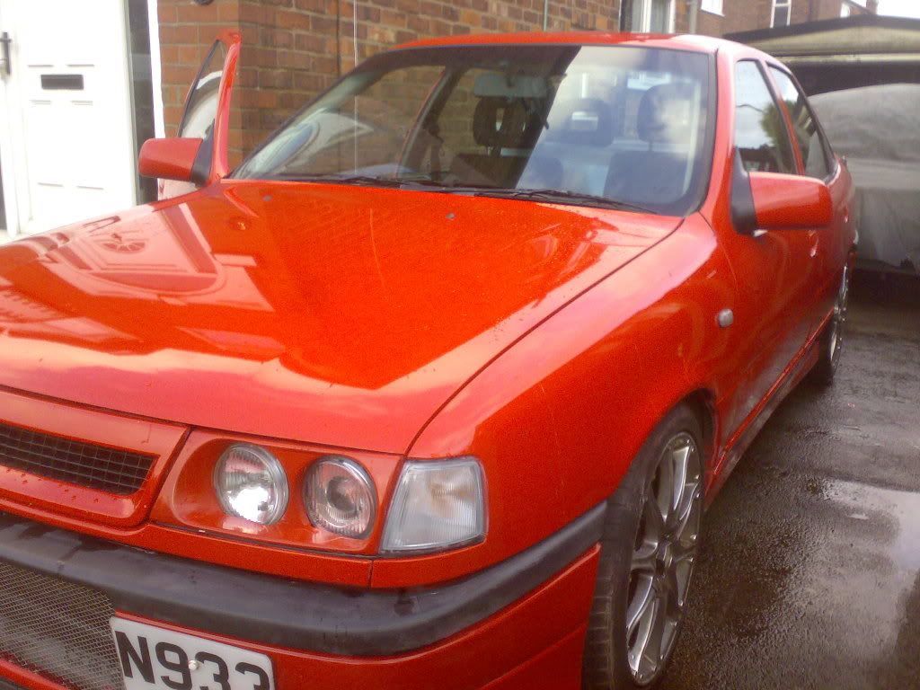

Today's work, terry and my mate Dan turned up to give me a hand, after giving the car a wash we started on the buffing, first tried some wonder compound (i'll let terry tell me what it is) but it wasn't quite upto the job, so out came the g3, after doing the roof and the bonnet (and covering my neighbours car in watery buffing compound- i had to wash it later on) dan decided i was rubbish and did the car himself, doing a damm fine job. dont you love people who work for pizza and penguins.
Thats before, even after the paint isnt the same colour but my camera makes it look a lot redder and better than it actually was.
Me and terry got on with getting the grey dash swapped out for the black one, as i dont have a haynes we had to work out how stuff cam out eventually we got the dash out and called it a day, we managed to get the loom out without breaking anything at all and i rescued a few clips and such off the old dash.
Tomorrows jobs, i'll polish and wax the car tomorrow and start on putting in the dash.
Pics to come
Re: Gaz' Cav.
Ive waited on dans phone pictures, and they have come out a bit weird but i'll get some more when its hand polished
Ive still got the black bits to do but it is looking a lot better than it did.
Can you spot the dash?

Lol nope it is in one of the pictures.
Re: Gaz' Cav.
ok. its on the drive.
