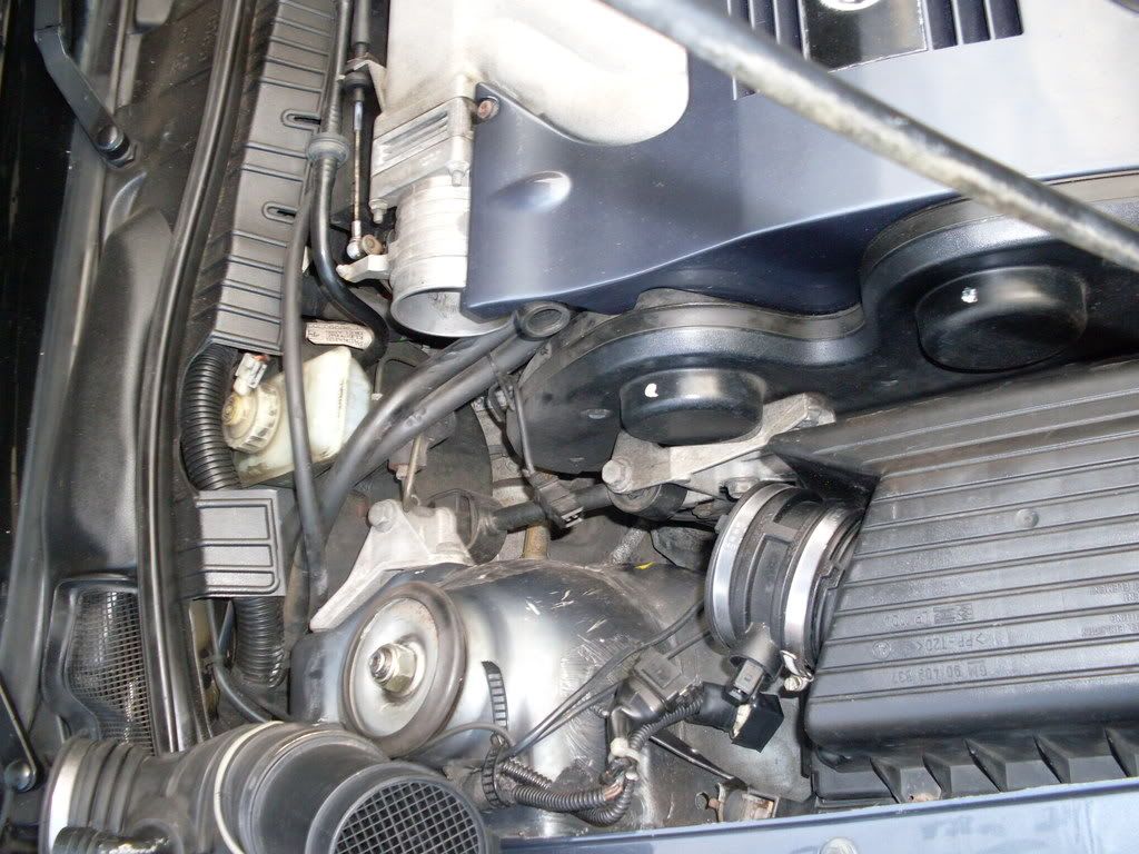

Now for more power... after seeing all your cars I've decided to put up or shut-up... the 3 litre cams are going in... now my engines in bits too so no back tracking!
the inlet ducting and sensor removed...

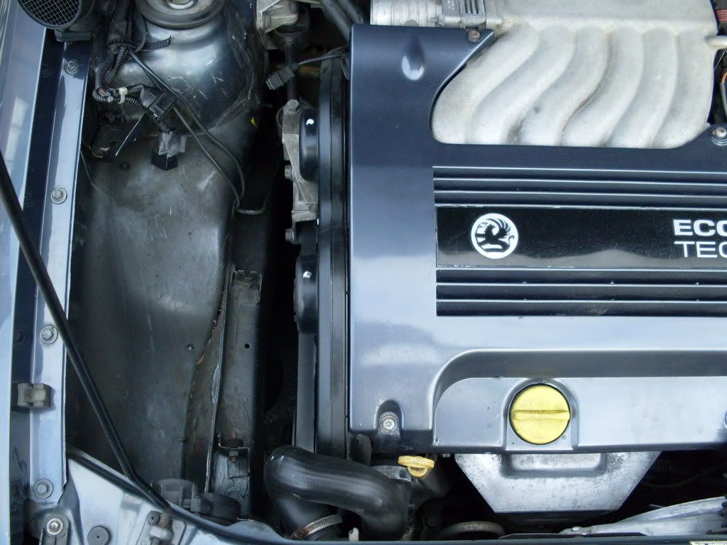

Cover off...

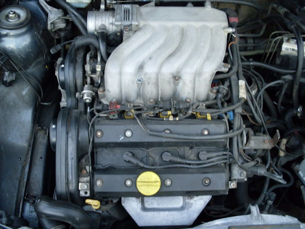

Manifold with last few attaching hoses...

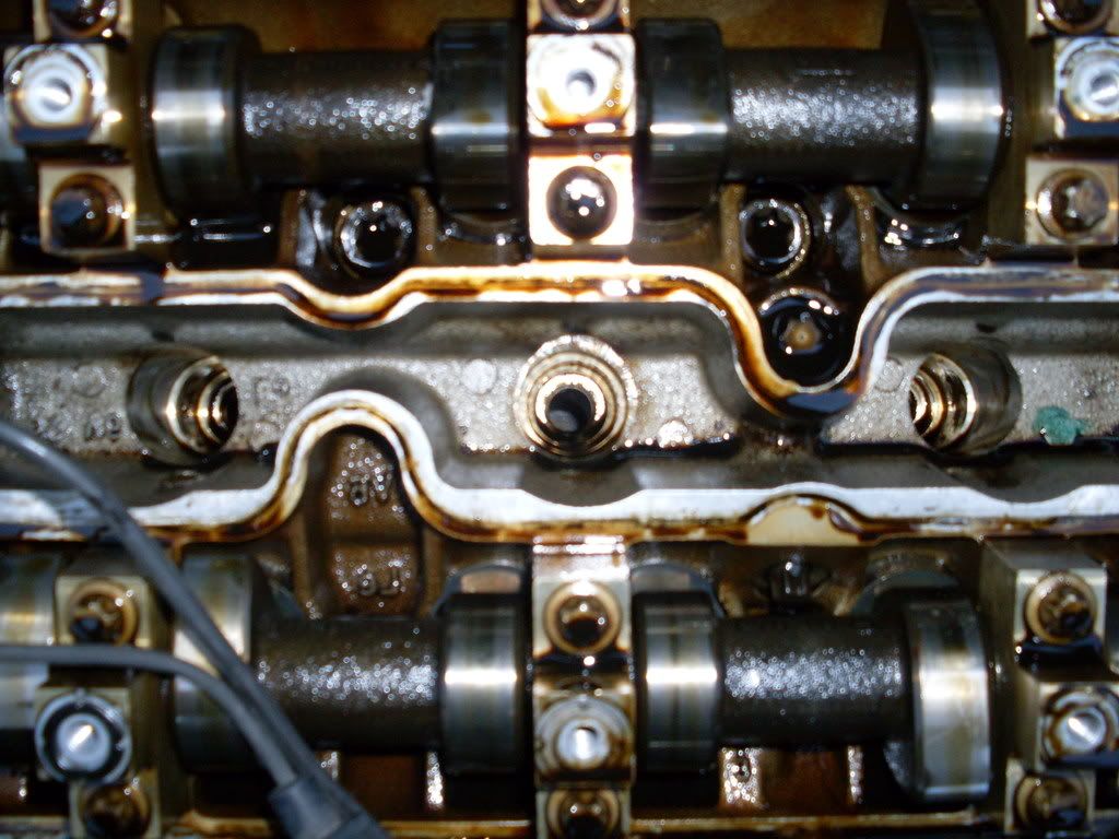

Cam covers off and sparks removed so we can align the engine before removing cams...

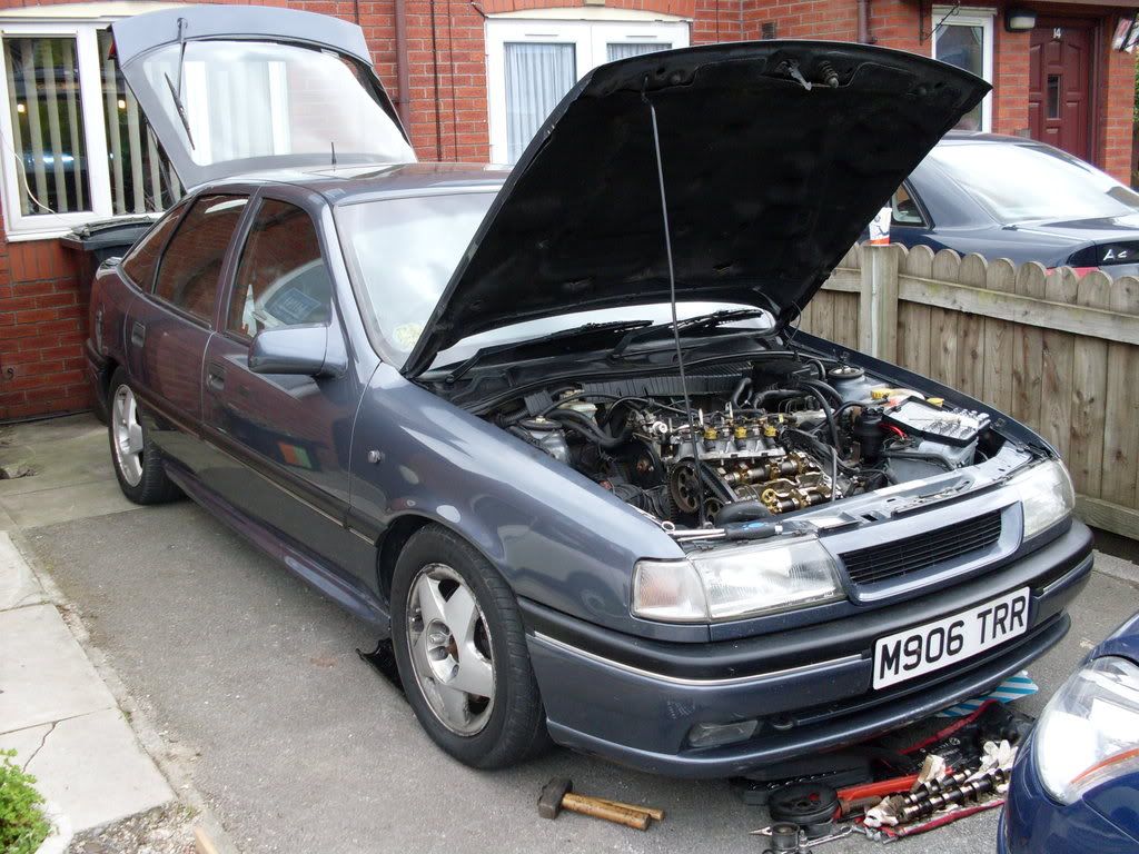

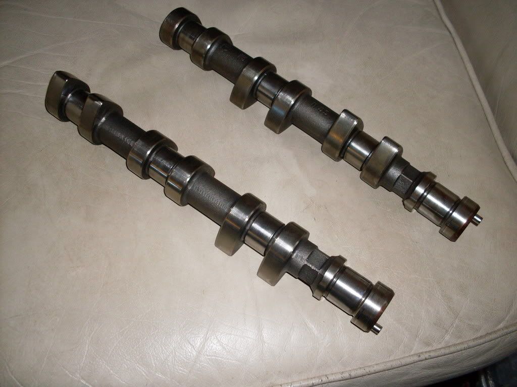

ohh and the inlet cams

should notice a fair difference, i know i did after i had my inlet 3litre G cams fitted to mine.

Cams on the couch!, did they come round for a cup of tea and chat first? And I though putting carparts in the kitchen sink was bad. But having them join you in living room!
So soon you'll have around Vectra Gsi power! cool. would be interesting having urs and Young Daves car on the rollers and see how the compare now with the same cams in.

Right the cams are in and she's running beautifully, put them in and fired her (without checking the timing
if I blow this lump up I'm getting a 500cc upgrade
)... no problems we have a 2.5 with G inlet cams and she, Emma and I decided to do a full bore no messing 0-70ish then cruise with some 60-90 checks so the 3 lane "private road" was visited. Giggles were provided courtesy of more power and torque everywhere, we were happy.
Then the EML lit up and I lost power everywhere, felt like I was dragging a 2 car trailer. We were NOT happy... pulled off and crawled to my friends house too have a look.
What we found caused Emma to creep and crawl in undisguised repentance... someone had replaced my rocker cover gaskets (thought I might as well while I was there with the omega lower divider, cheers Hairibo
) and trapped whichever sensor runs up the front right hand side of the engine and across the injector rail... then bolted them down, nice and firm, partially severing the sensor wire and causing an oil leak. All fixed we drove home... LOVE IT!

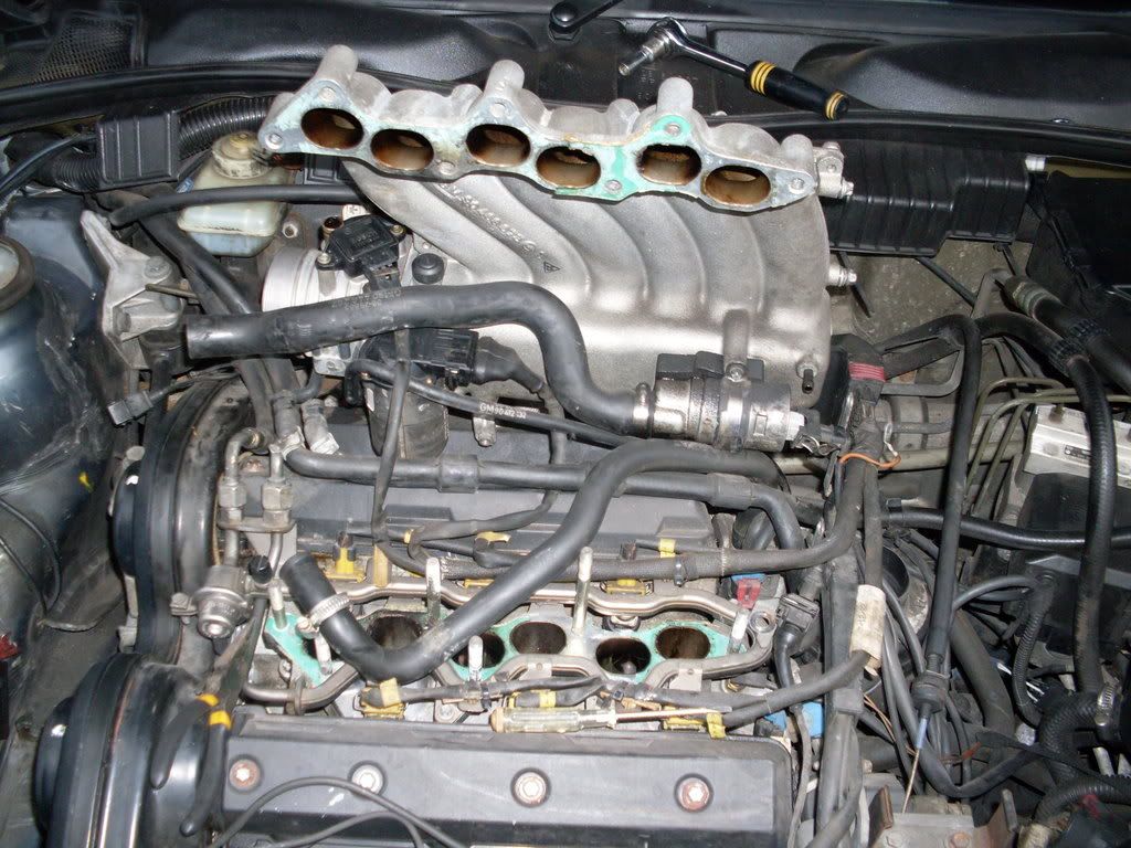

Manifolds next...
