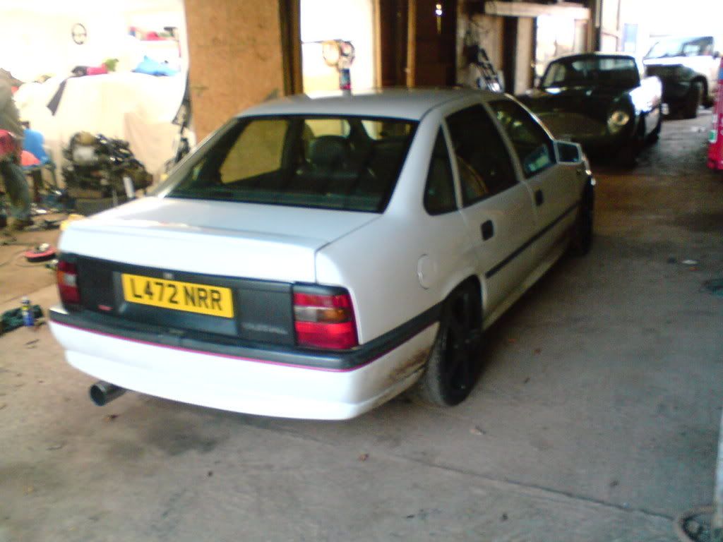

94 XE SRI , started to do a few small jobs on the cav today :) .
fitted front 288,s of the astra , made stopping a lot better :mrgreen: .
sorry for the pic quality , using the mobile , left the camera up vanweez,s lock up , DOH !!!

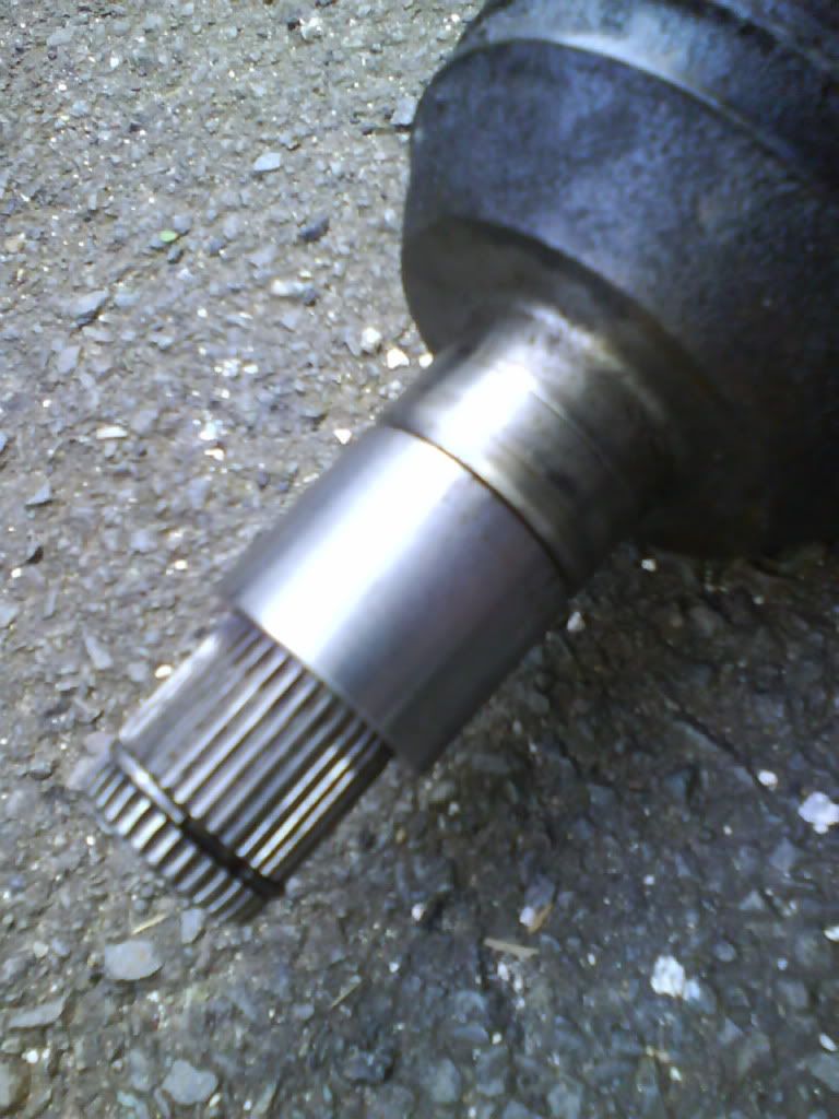

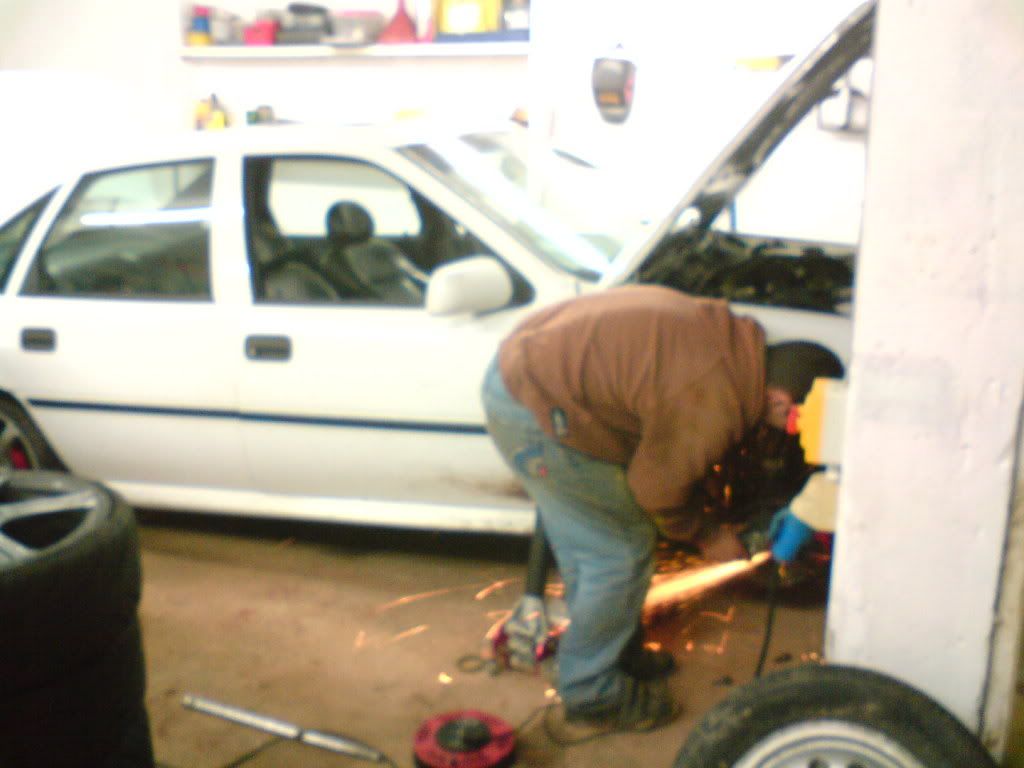

had to get the cutting disc on the end of the driveshafts , the socket i had wasent deep enough to fit :( ,
will put the better quality pics up tomorow :D .
fitted the black 17,s off the astra , as the original tyres wear a pit to worn ,
some random pics of the interior

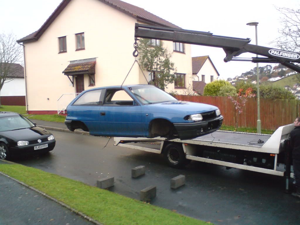

the astra got picked up yeasterday :(
going to fit some uprated shocks tomorow , still on standard GM,s , a bit to soft , feels like a sponge !

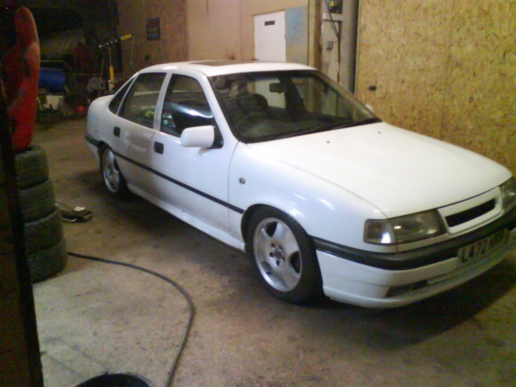

made a few changes to the cav this wknd ,

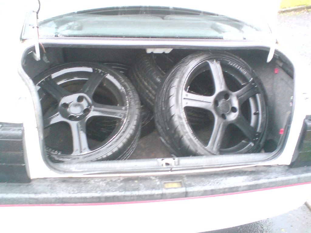

changed the wheels over as the tyres where shot on the silver 17,s managed to get all 4 in the boot :mrgreen:
changed the rear shocks for some cheap G-MAX , the standard GM,s were popped , took the rubbers out of the rear springs , sat a bit lower 8-)
gave the rear calipers / discs black as they were red when i got it .
T-cut the black tinting spray off the rear lights aswell as painting the bumper strips black as red didnt look right , will post a pic of the bumpers with black

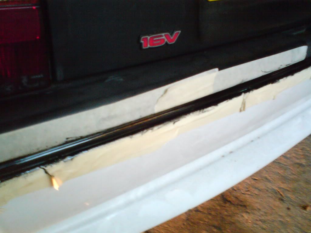

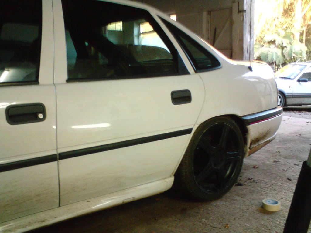

pic of the bumper strips masked off and painted , looks better with the masking tape off :lol:

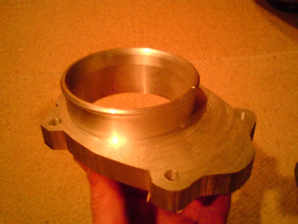

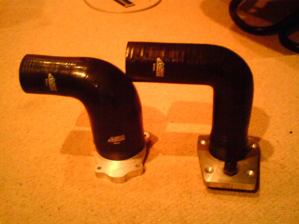

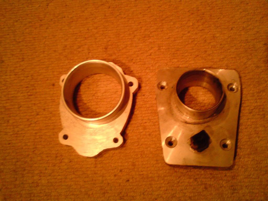

work was a bit slow today , so made a 3" ally top hat , needs some tidying up .
still need to drill / tap the charge sensor hole . Pic of the old 51mm tophat i was running when it was in the astra
and some silicon hoses i have , will have to trim it down to get the over 90 angle , will be reducing it back down from 76mm to 51mm for the time being

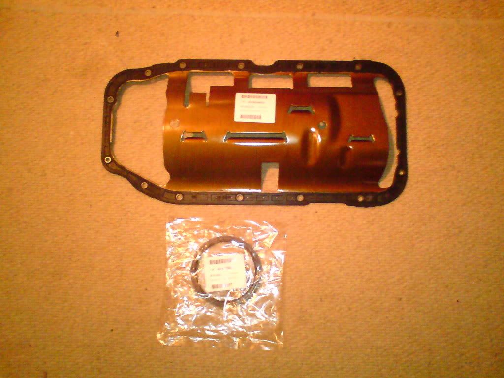

new 8v baffleplate with bonded gasket , and crank seal , found under my bed , been there for a while :?
engine will be getting a stripdown and once over , then take it from there , once my bank balance has recovered from cut back hours / christmas :(

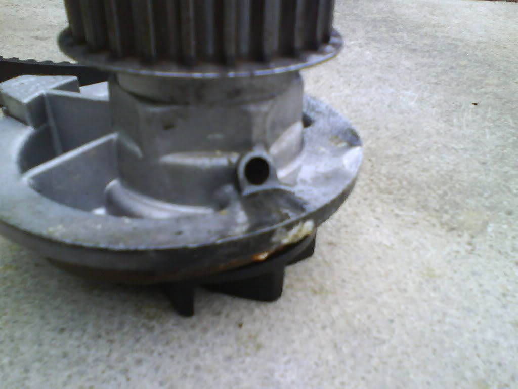

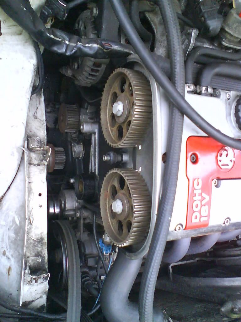

few issues , water pump started leaking , well pouring out the side
luckly managed to get it home , without cooking it :(
day off work on a cold frosty morning !

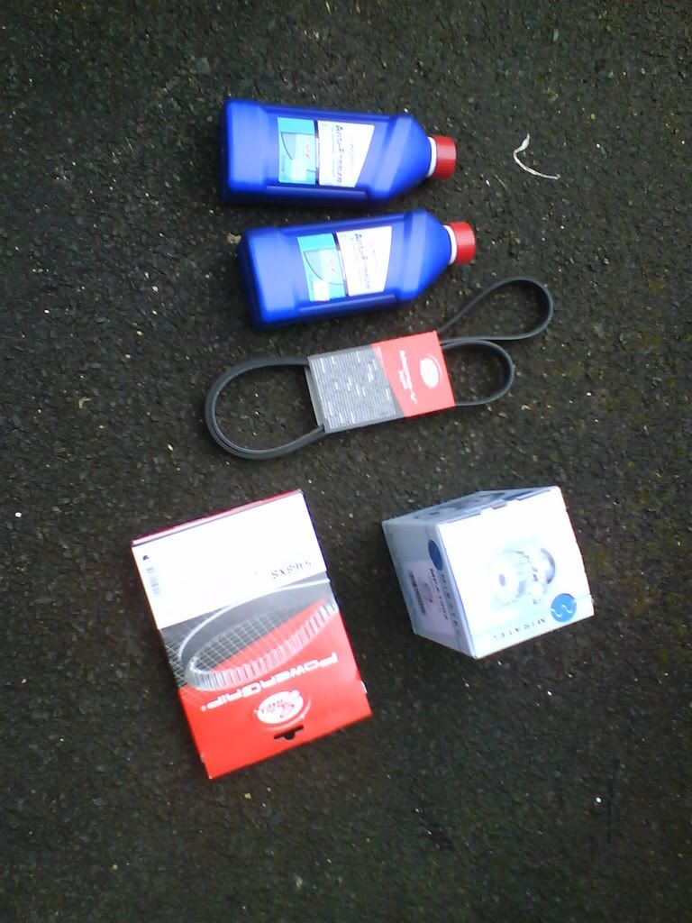

new waterpump auxillary belt antifreeze & cambelt ,tensioners were still in good nick :mrgreen:
back on the road all mended , issue with a fault code for the AFM , but its seems to have fixed itself , and dosent trow a fault code now

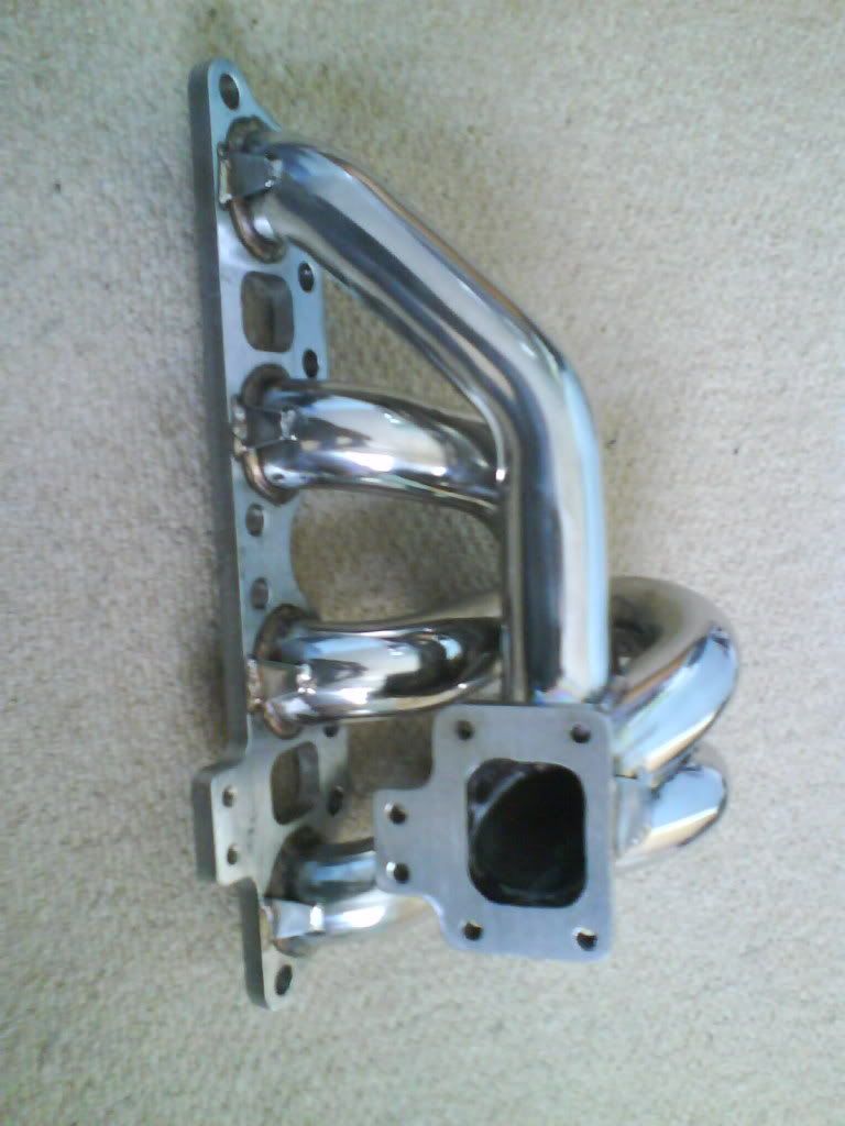

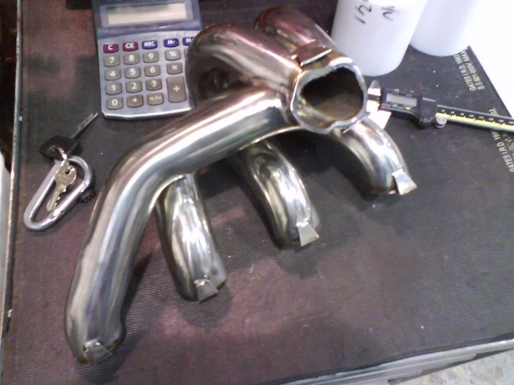

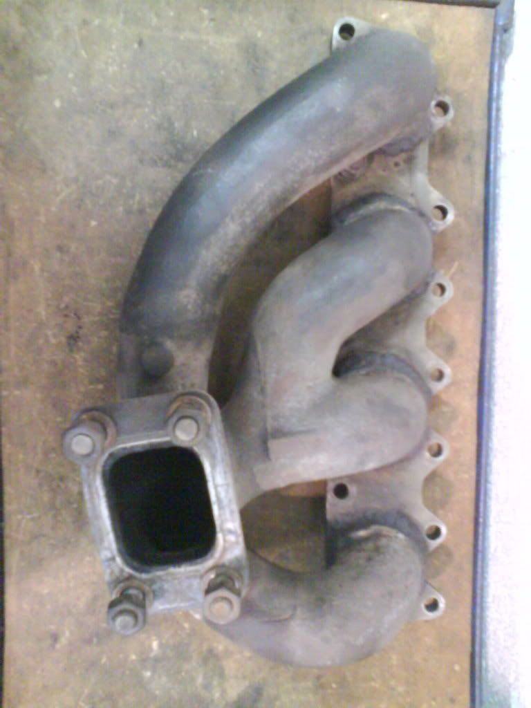

After the cav was mended , made a start on the C20let lump that is a paper weight in the garage
this was the old escort Rs turbo manifold welded to a C20xe flange i was using when it was in the astra
think it got a cooking at 17psi :D

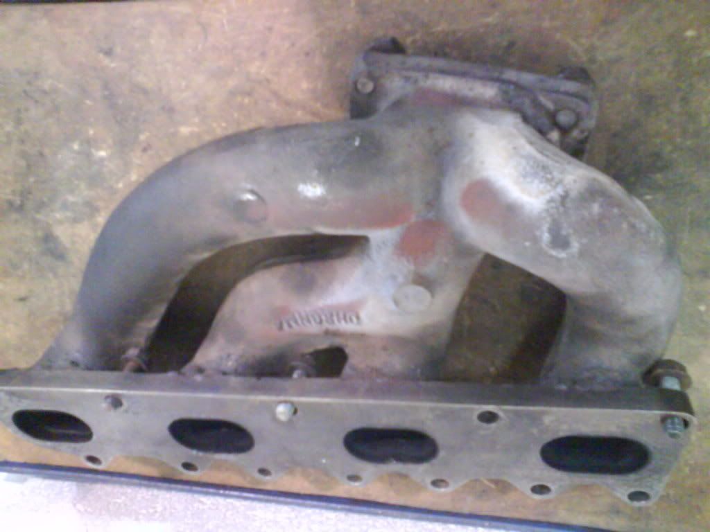

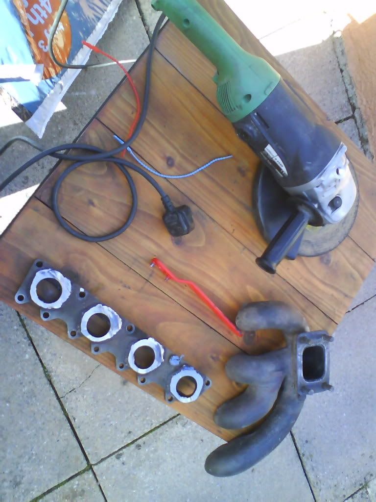

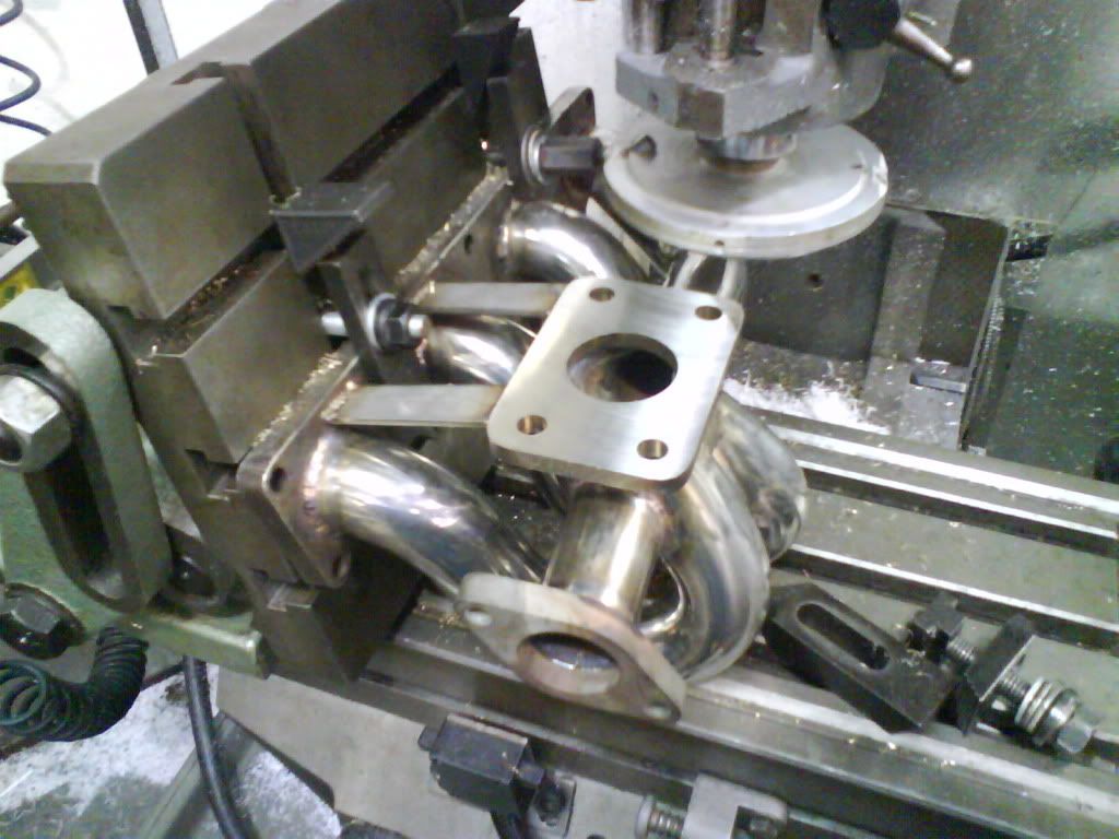

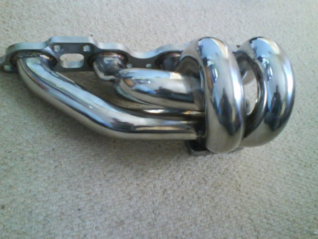

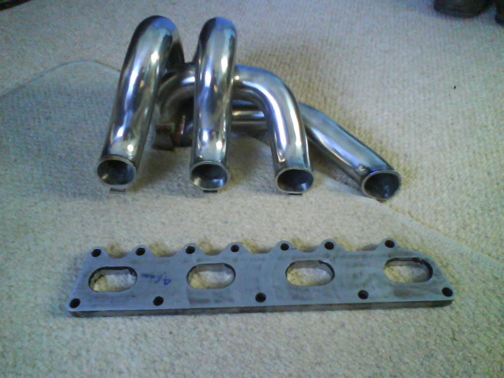

brought this s14 megan racing manifold for cheap
got the 9" disc cutter out , to relive it of its flange
a mate will be tig welding the flange on , aswell as a T3 flange , as soon as i face the flange up on the surface grinder

T3 is back together and balanced , like always had to try it on the manifold for looks :lol:
removed the exhaust / turbo flange

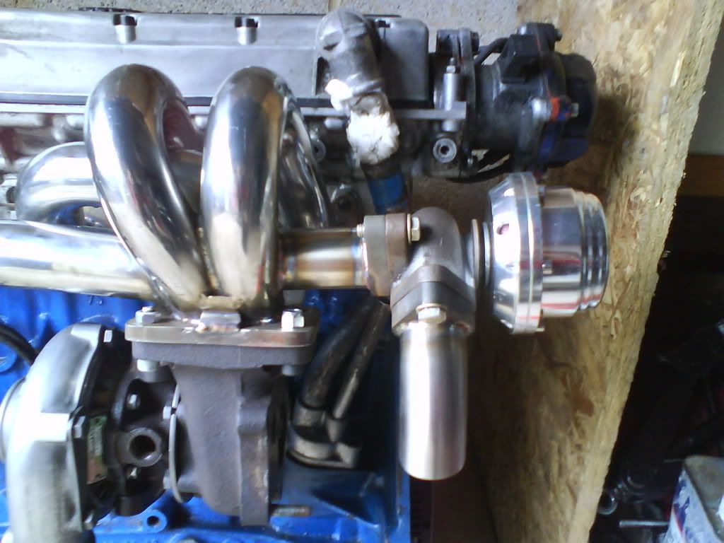

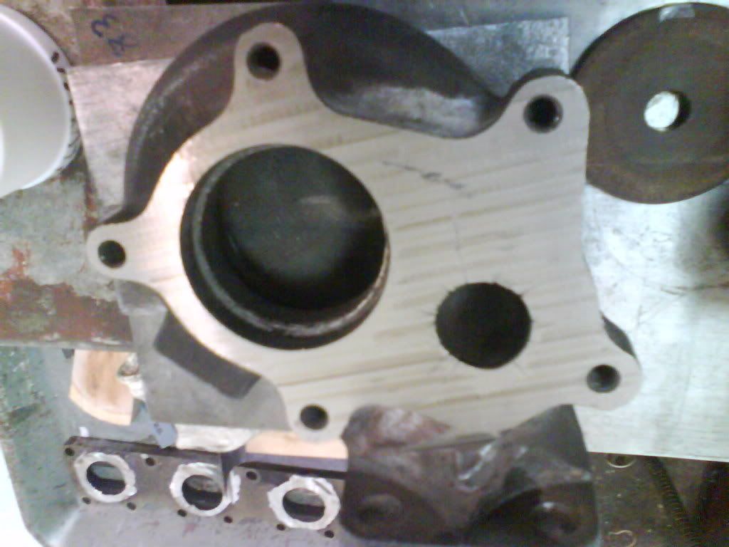

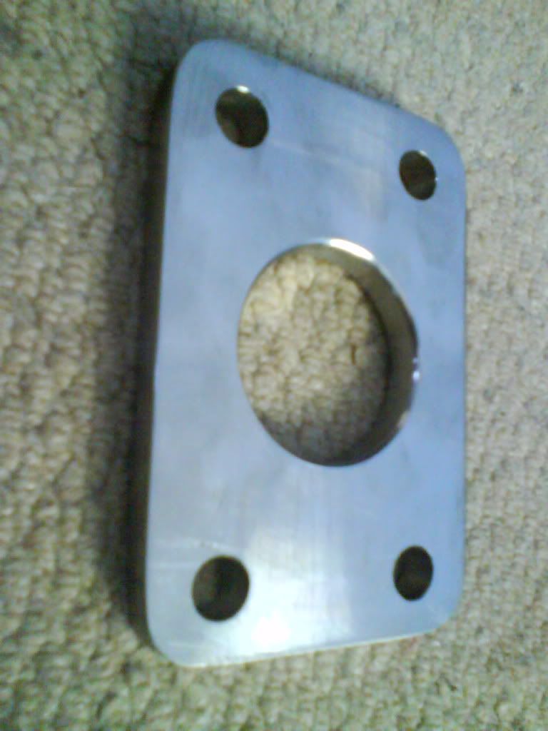

made a stainless T3 flange to replace the standard s14 T25 flange

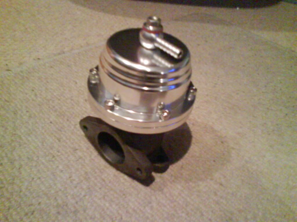

external wastegate sourced through a mate of a mate , brand new
made an exhaust flange to fit the T3 and to cover the wastegate penny valve :mrgreen:

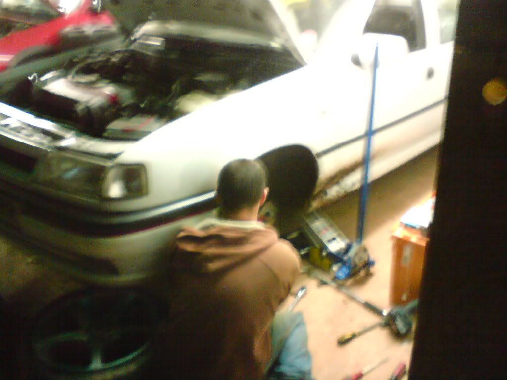

hi folks , things have been a little slow , due to work hours taking a major crash ,

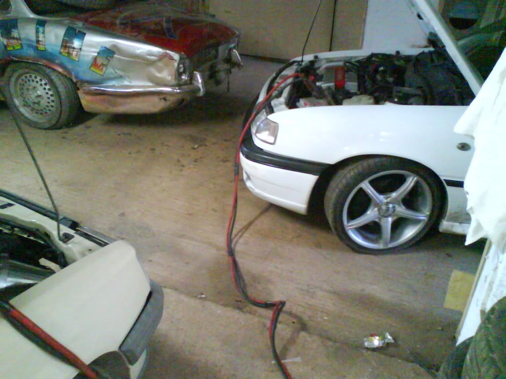

cav is still going , had to change the alternator last week , battery light was blinking its tits off ,multimeter confirmed it was shot
what a job that was , had to drop the alternator out the bottom of the car :wall , then had to jump it off my mates C16xe nova saloon lol

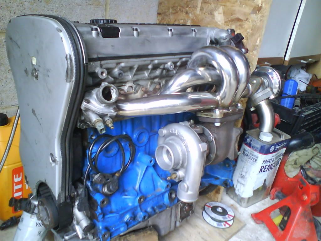

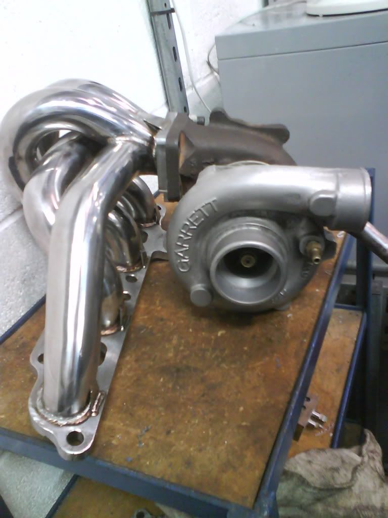

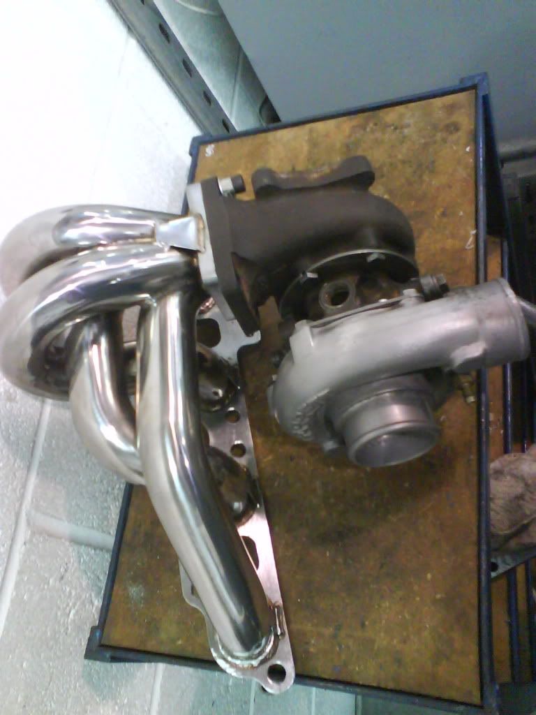

got my manifold back off my mate , after 2 x flange swaps and external wastegate / screamer pipe :cool
trial fitted , clears the rocker cover / breather pipe

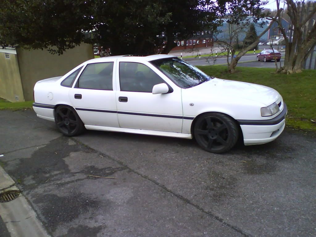

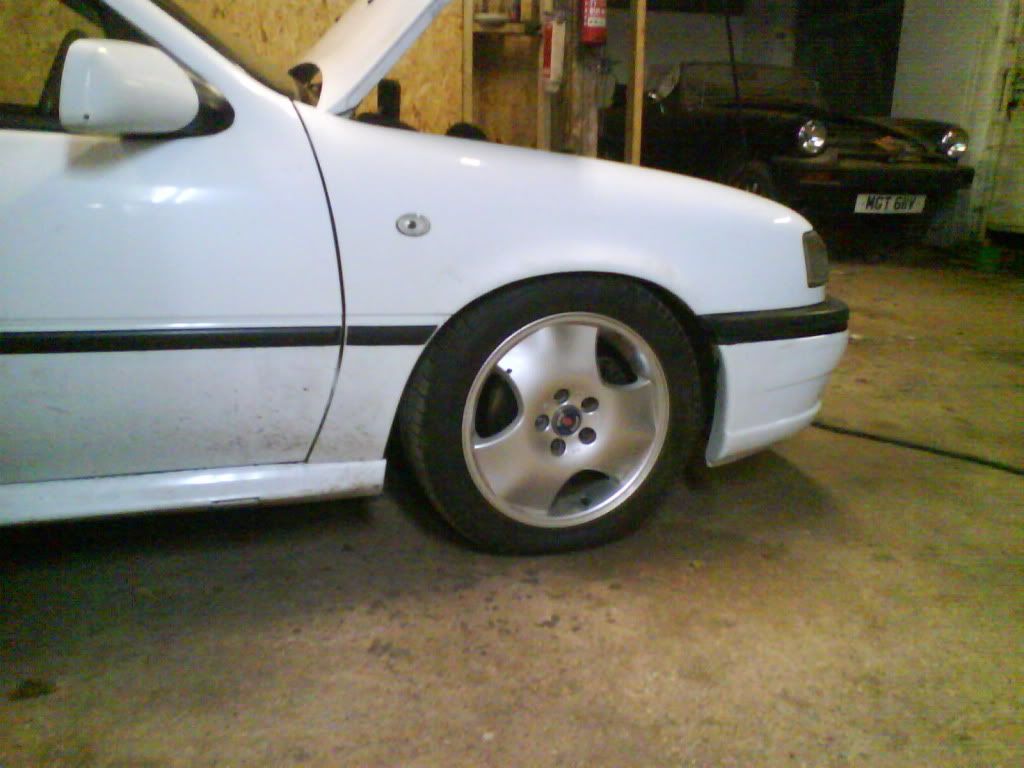

small update , decided on the 5 stud conversion , so dont have to keep drilling 288 discs for 4 stud :lol:
used saab 900 rear hubs , same as vectra rears , but the handbrake is up the top :mrgreen: and vectra hubs pressed into the front legs with new bearings
borrowed a set of retro looking saab 900 16" alloys , until get the turbo rims sent down from up north
not keen on these wheels they look so 1991 max power :roll:

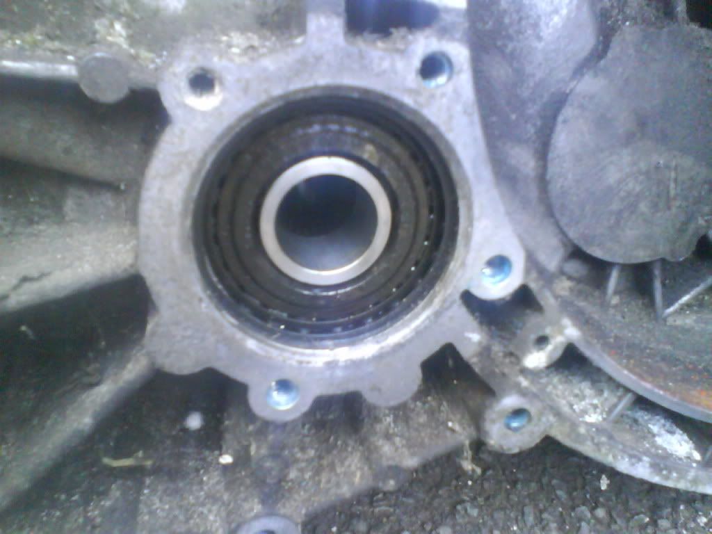

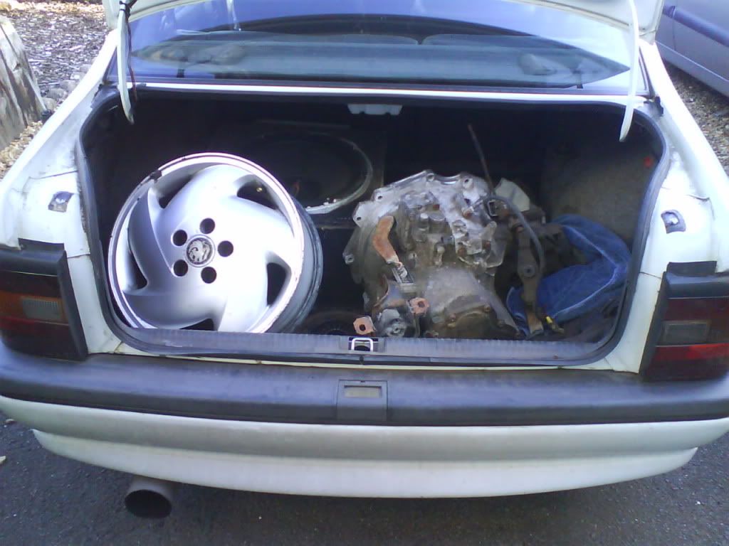

went over to a mates last night , picked up an F28 for cheap in good nick , came with standard rear mount , front mount and linkage
aswell as 4 x cav turbo rims , other 3 are on the seats :D

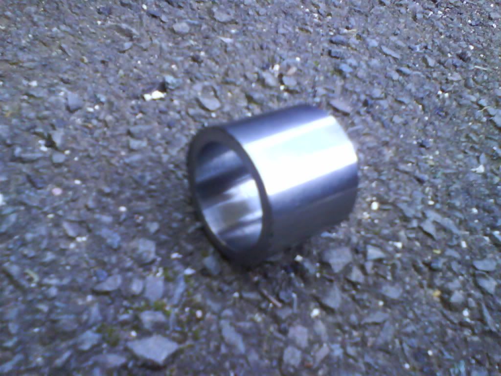

made an f28 collar , for the 2wd conversion plate
takes up the space where the transfer box went
got a couple F20 gearbox seal plates to macine to fit an F28 box , aswell as the drive shaft collars :D
few holes to tap and away i go , will update with pics soon
