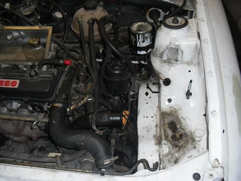

Well the reason I never started a project thread for this to begin with, is because basically it started off as my daily driver when I was working at other projects. When I 1st got the car it was a bog standard envoy with the worst interior ive seen in a cav, everything was blue, dash seats, plastics even the door rubbers.

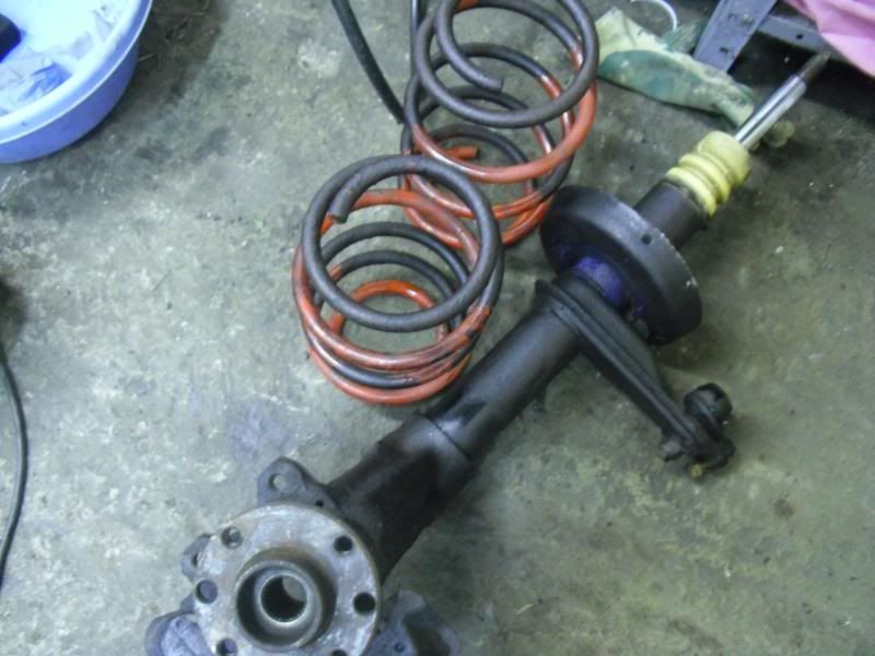

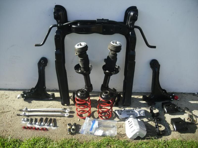

I got lowering springs, an sri interior and kit off a fella in dungiven who was breaking a another white one and everything was put on and every bit of plastic swapped for black ones from about 5 different cavs lol. The car also got a new clutch and I replaced the crank oil seal when the box was out. At the same time I relpaced the driveshafts and put on new CV boots. It got new handbreak cables and shoes. Probably a few other things too that im forgetting.
I was never really happy with the finish of the outside, wee bits of rust on the bottoms of the doors, scabby bumpers etc. So when I got the black 406 MOTd this was parked up with the intention of tidying it up. It lay there for a half a year and then at the end of the summer I decide to get stuck into it and get it ready for the mot which was due in sept. What started as an camshaft oil seal change ended up doing all of the following. lol
Rather than ramble on il just throw up the pics....

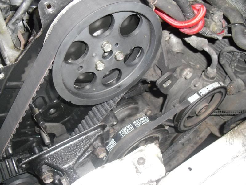

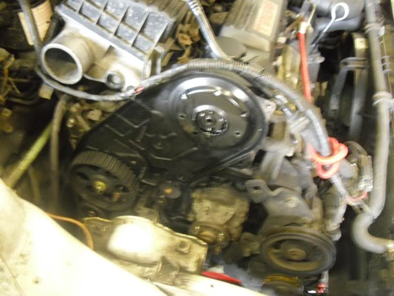

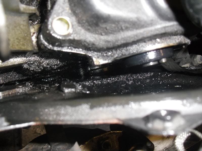

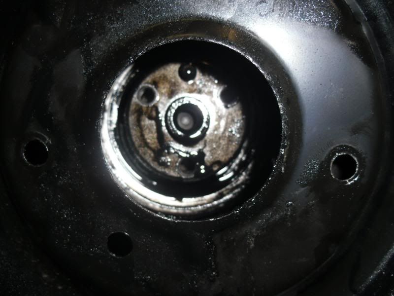

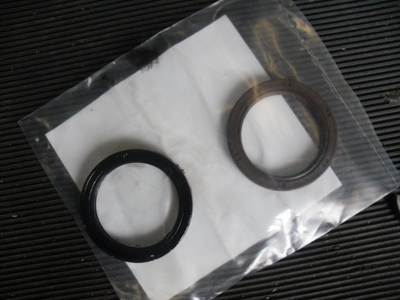

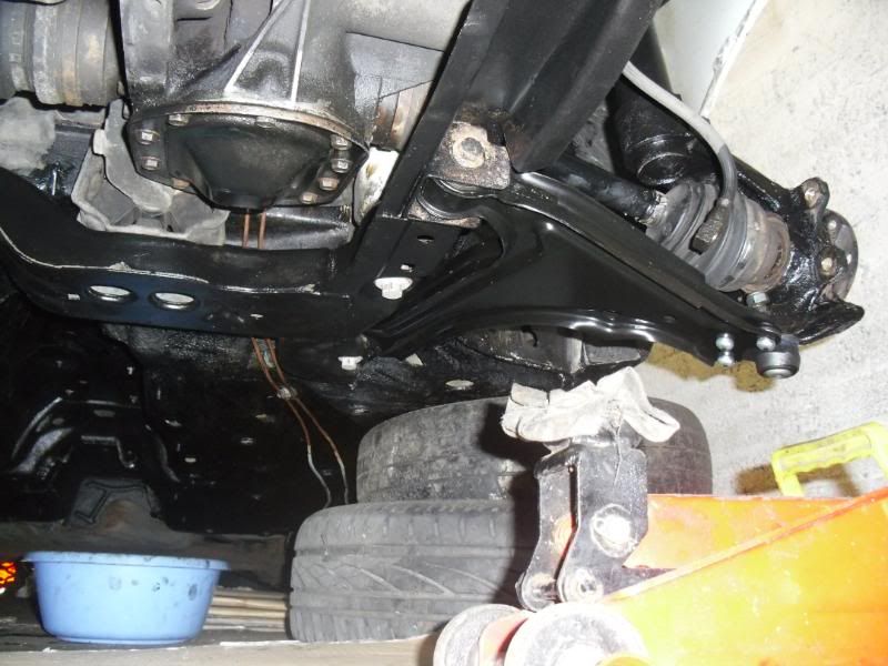

So on with the oil seals and new belts...

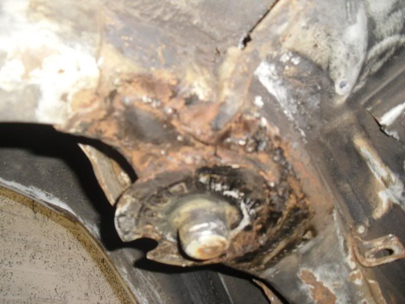

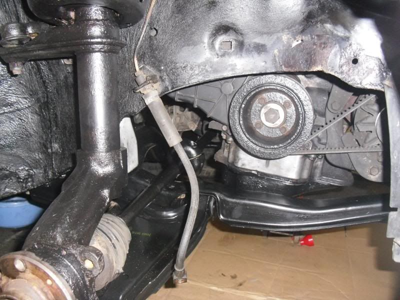

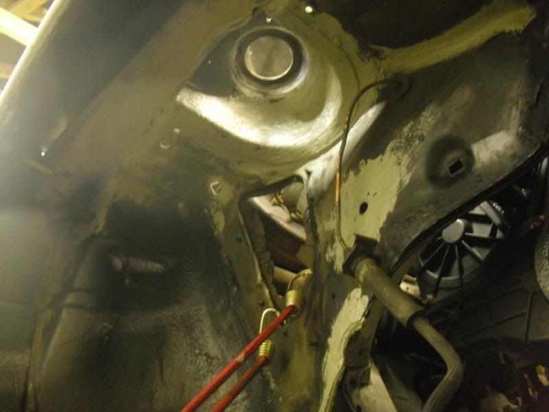

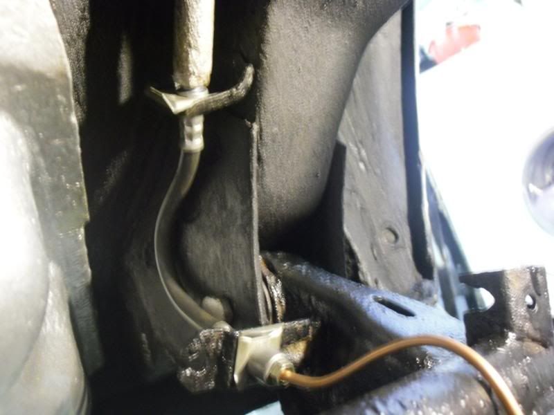

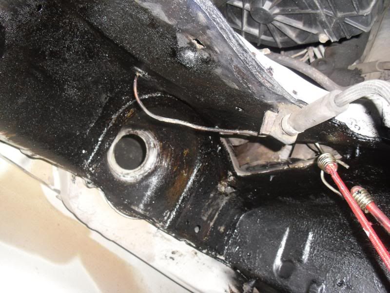

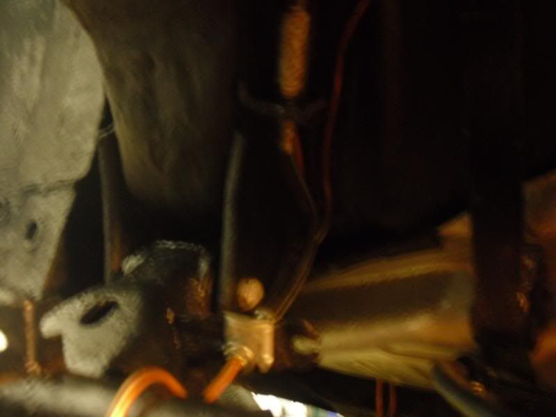

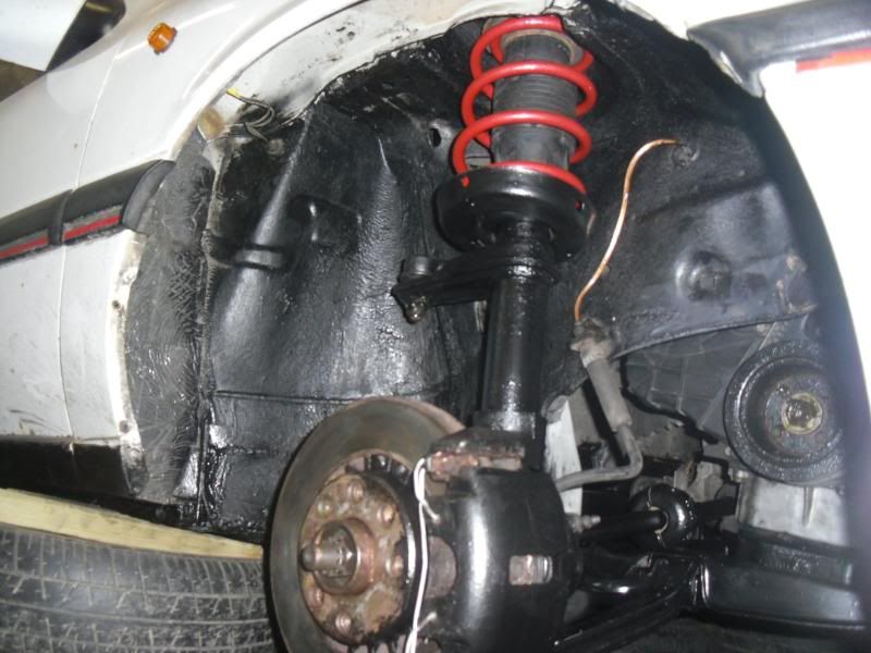

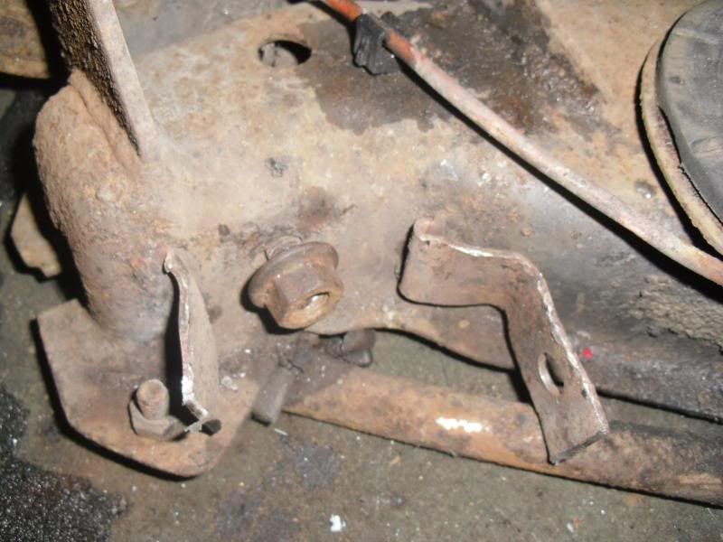

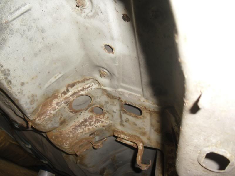

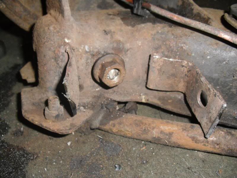

The car was also over due a bottom ball joint, but I couldnt get the bolts shifted so decided to get another subframe and put on two new bottom arms. As the subframe was off and front end stipped this resulted in a bit more unplanned tiding...

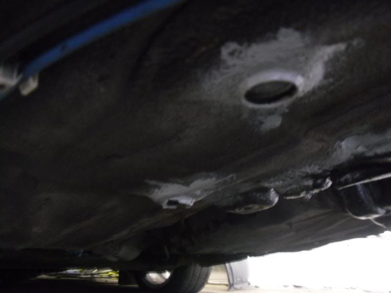

Small hole, later sorted...

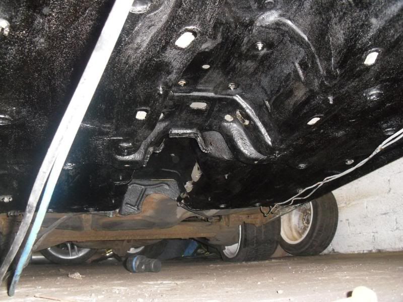

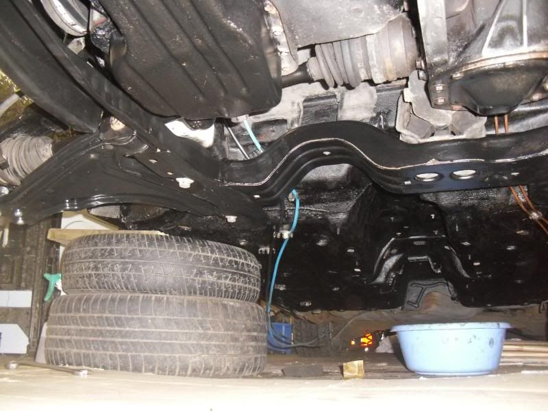

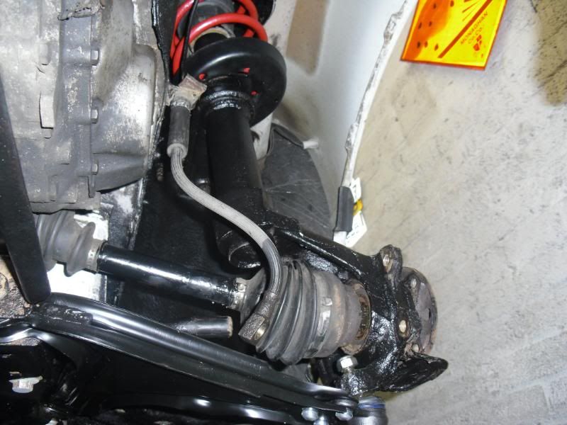

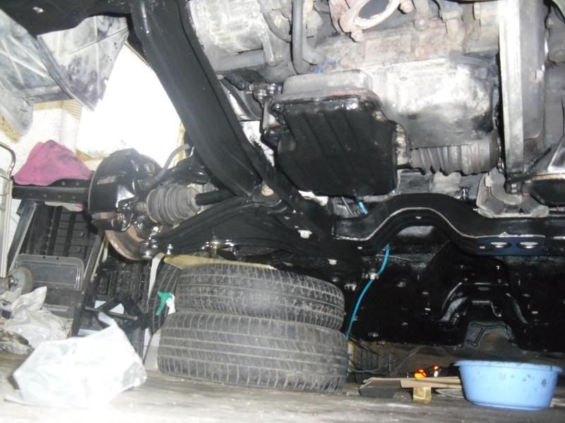

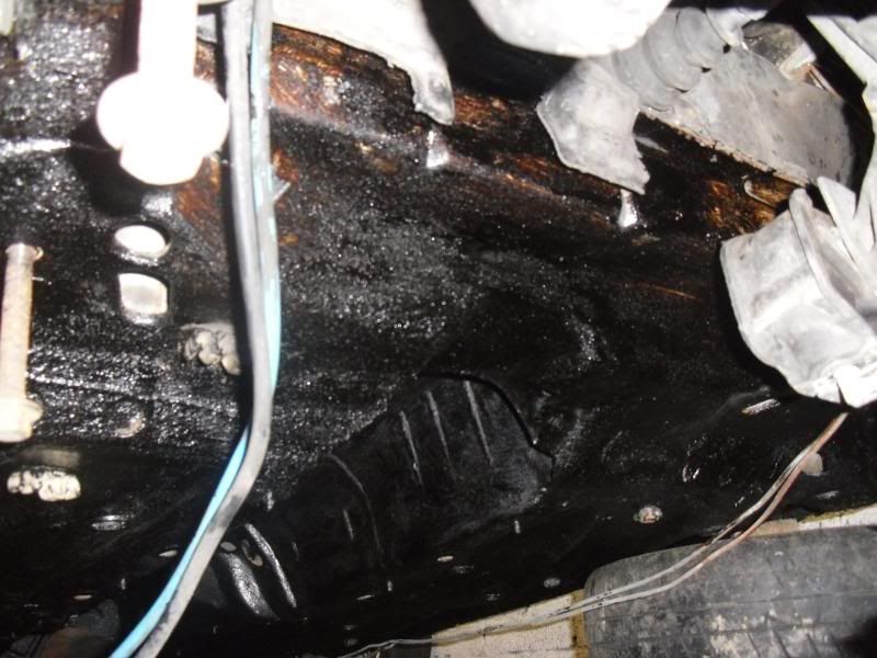

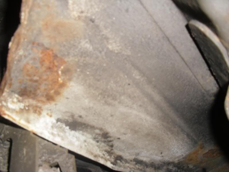

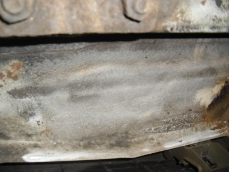

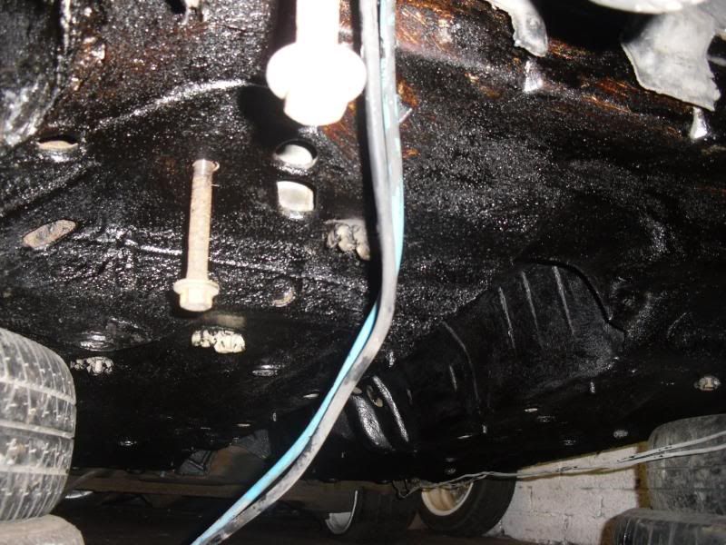

I spent a week wire brushing and removing surface rust before undersealing...
All cleaned up and new parts ready to go back in...

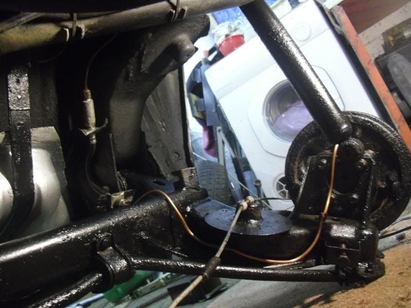

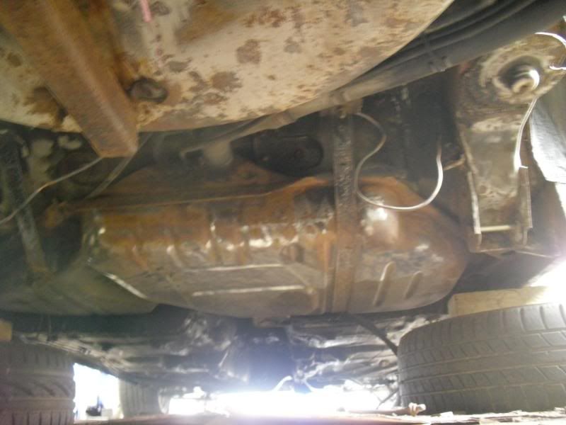

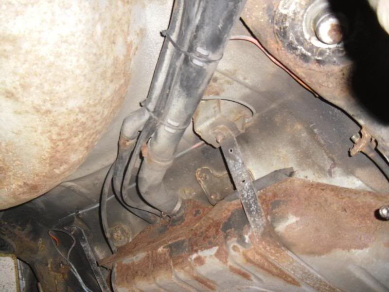

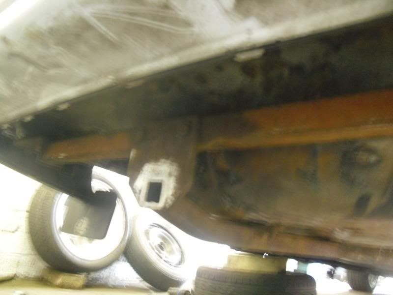

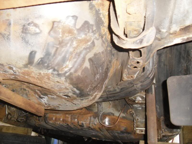

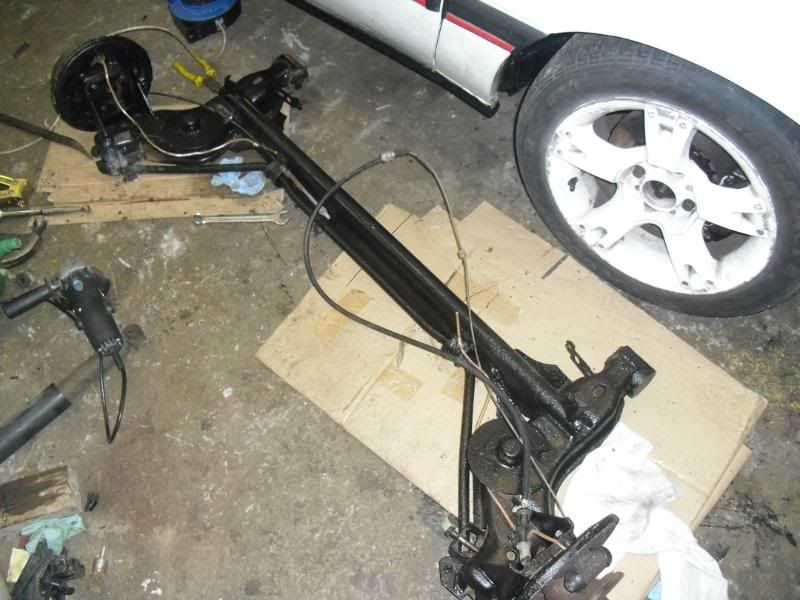

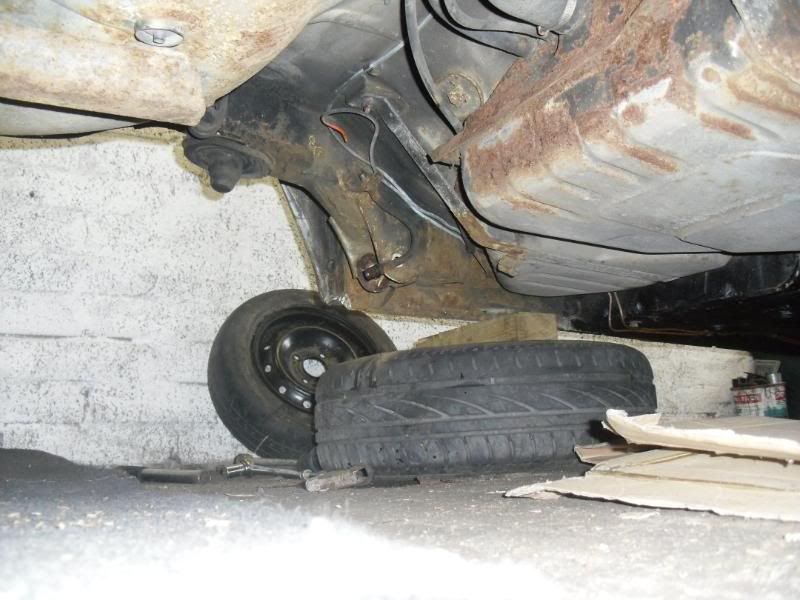

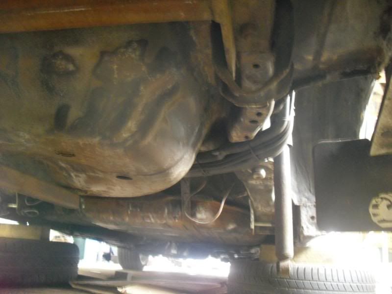

With the front looking a bit fresher I decided to move to the back, It looked alot worse than it was with all the surface rust, but it was solid esp after having the spring top mounts welded for the last mot. I had a poke at it with the screwdriver before starting all the work on the front.

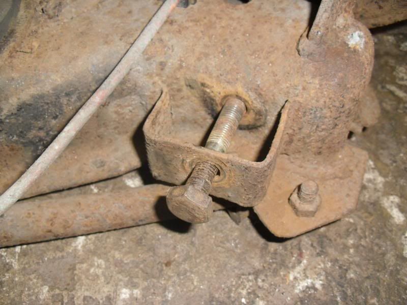

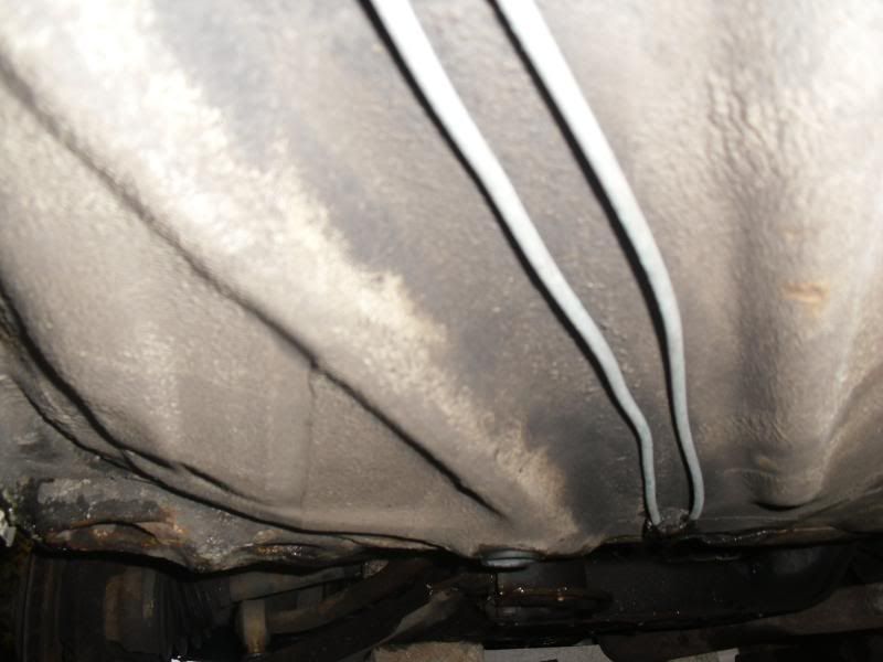

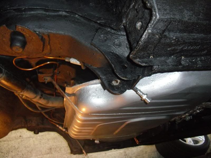

First snag, removing the axle to get some more access and to clean it up. The bottom shock bolt sheared so I had to cut the wee U shape inorder to weld a nut on and get it out.
The tank looking worse than it is, but after a few hours with the wire wheel, expecting pin holes and leaks it came up ok, I will probably replace it at some point.
This was all wire brushed back to remove the rust then a good coating of rust eater before it was undersealed...
Tank painted, the straps have since been painted black

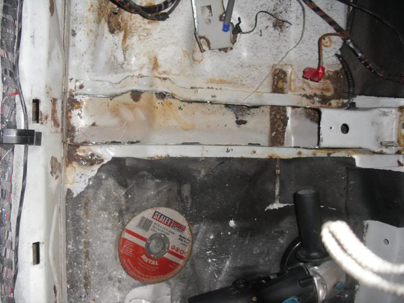

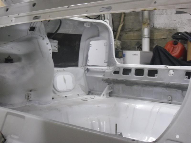

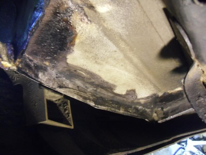

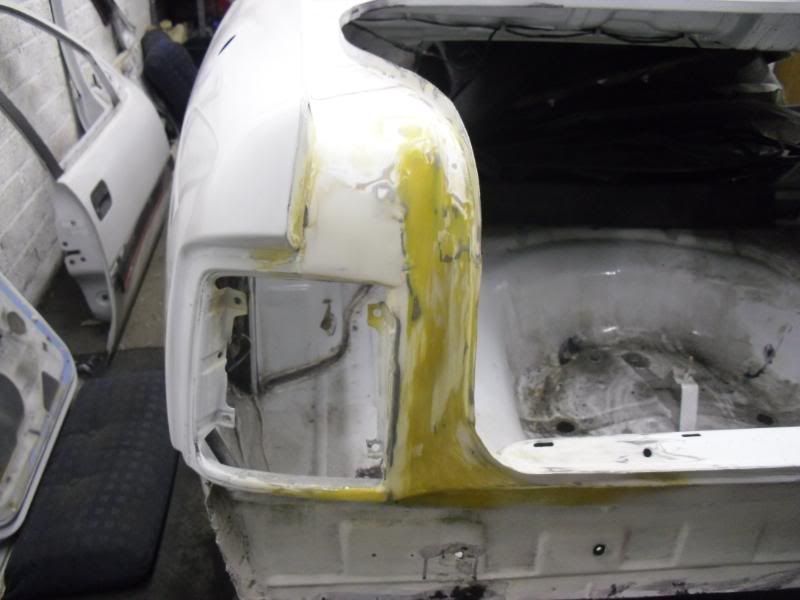

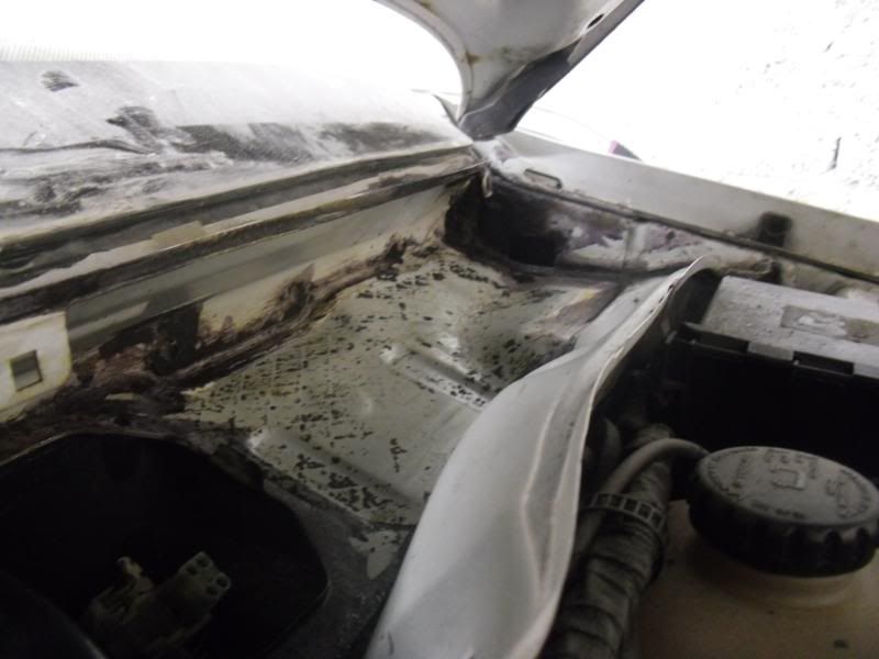

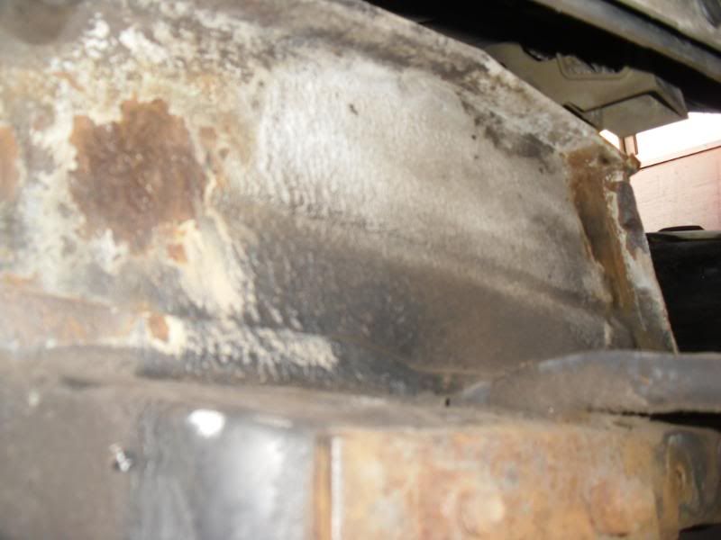

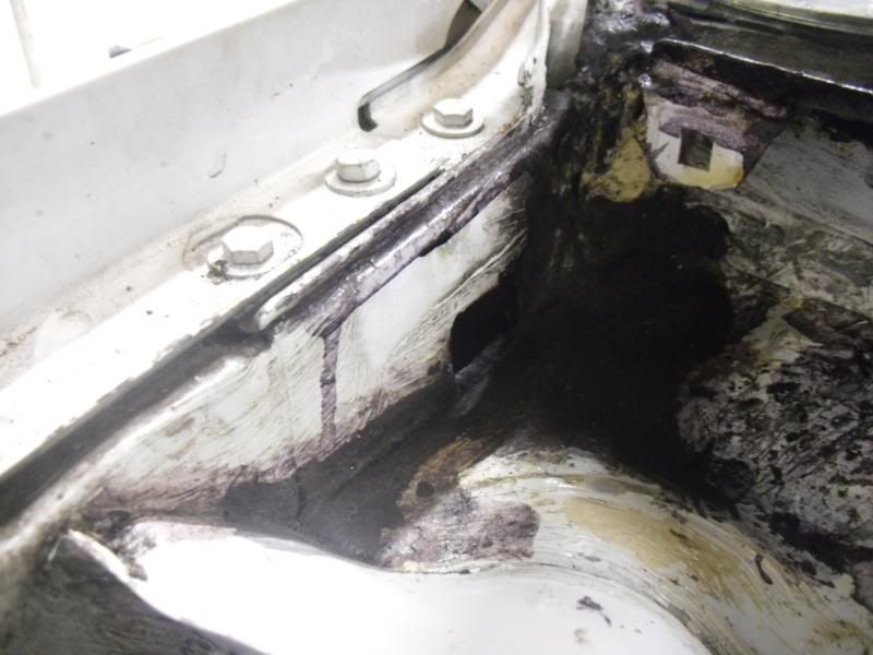

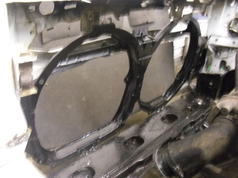

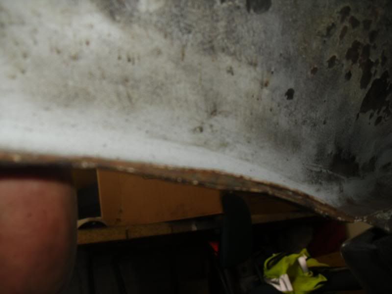

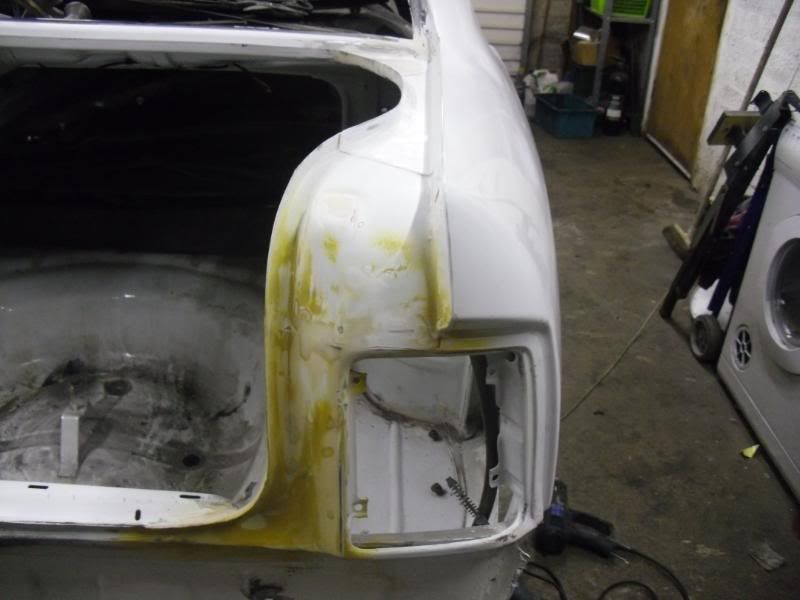

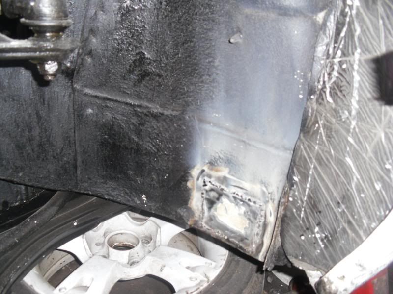

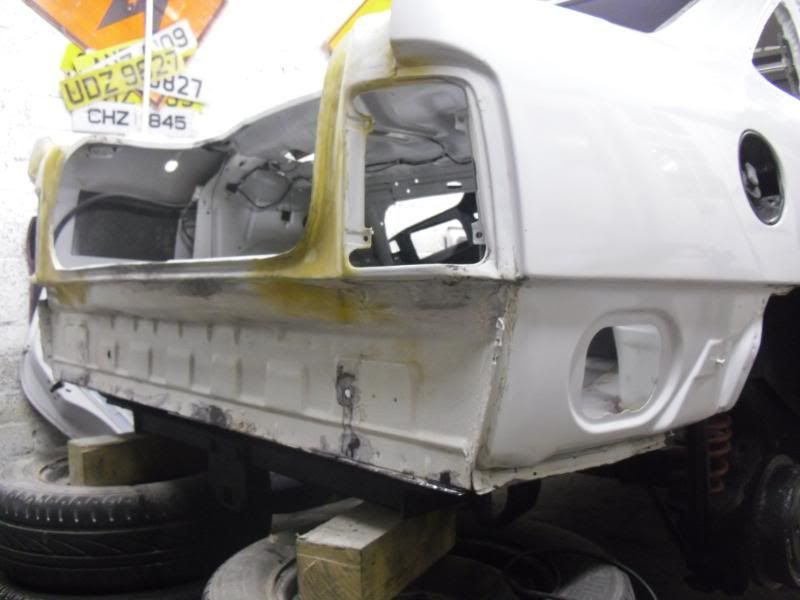

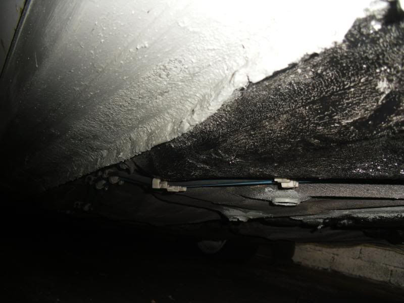

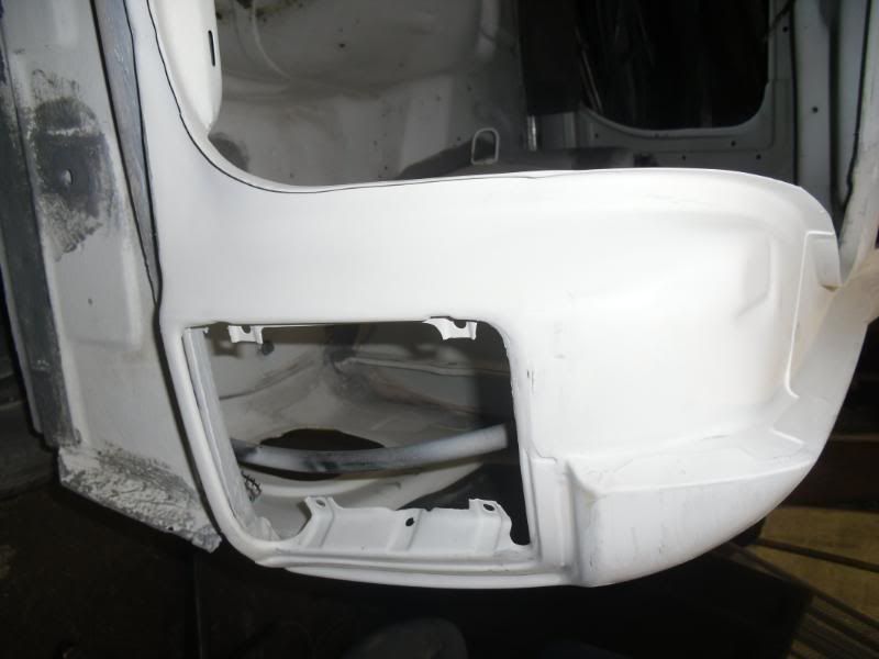

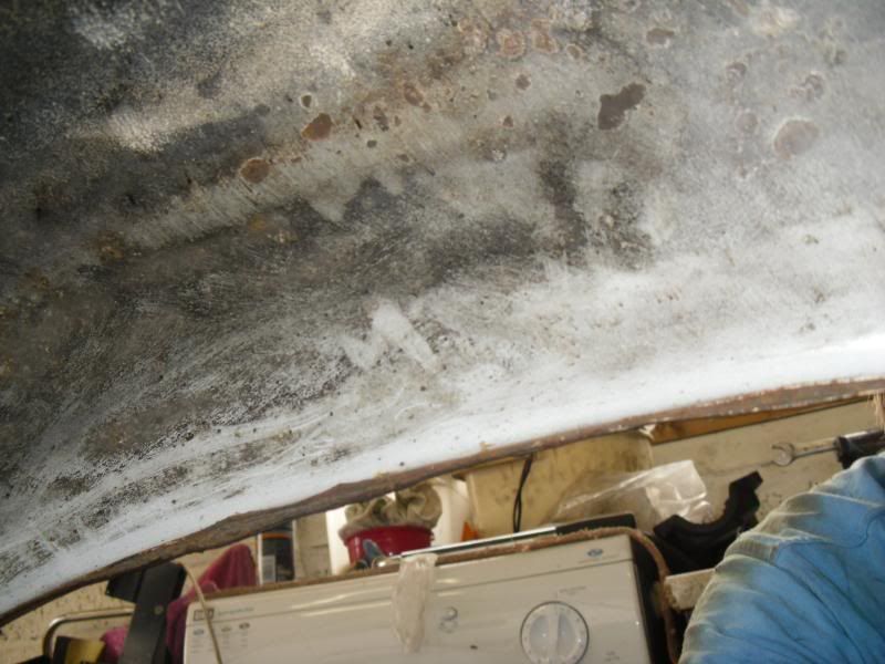

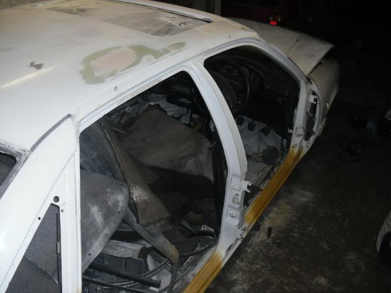

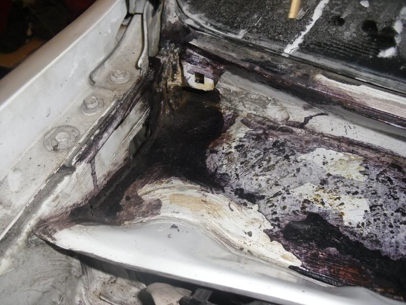

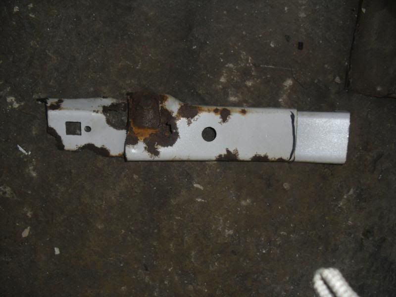

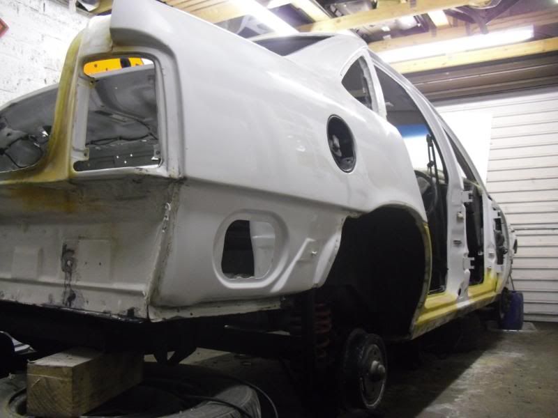

With the underside nearly done I moved on to rot removal and a bit of welding. I noticed the passenger floor was always a bit damp and when I removed the sponge part it was still soaking after 6months in the garage. The water was getting in through one of those drain holes I posted earlier, so that was plugged and what damage it had done was removed and replaced. I also stripped back all the sealer in behind the scuttle panel to make sure it wasnt rottin, Was all solid so was treated with rust eater, sealed and a code of hammerite to smooth it a bit.
I had repaired around the lights before as it was rotting here too. It was all cut out and new metal welded in. Took age but atleast this time it shouldnt return. Boot floor with the ugly bolts for the tow bar that were rusted.
The doors and sills got a bit of treatment too, every chip and bit of surface rust taken back to the metal.

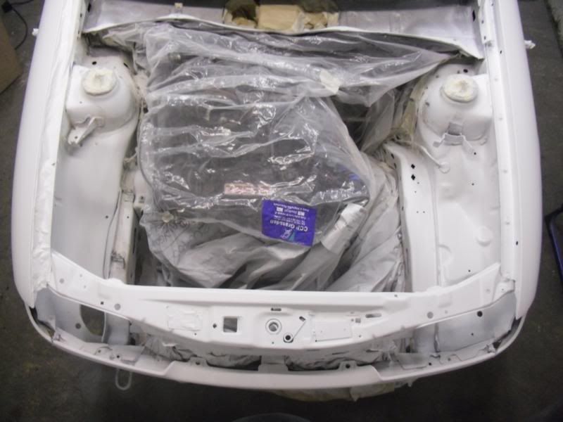

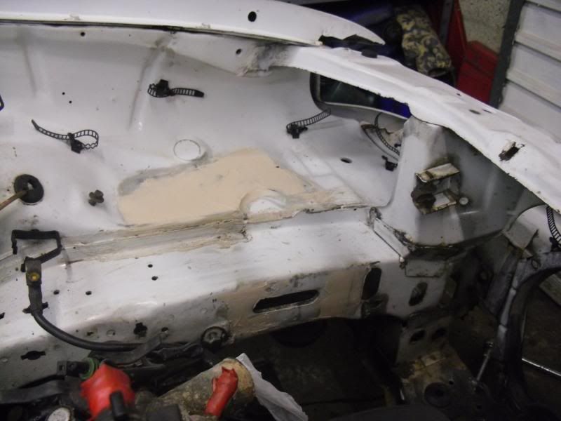

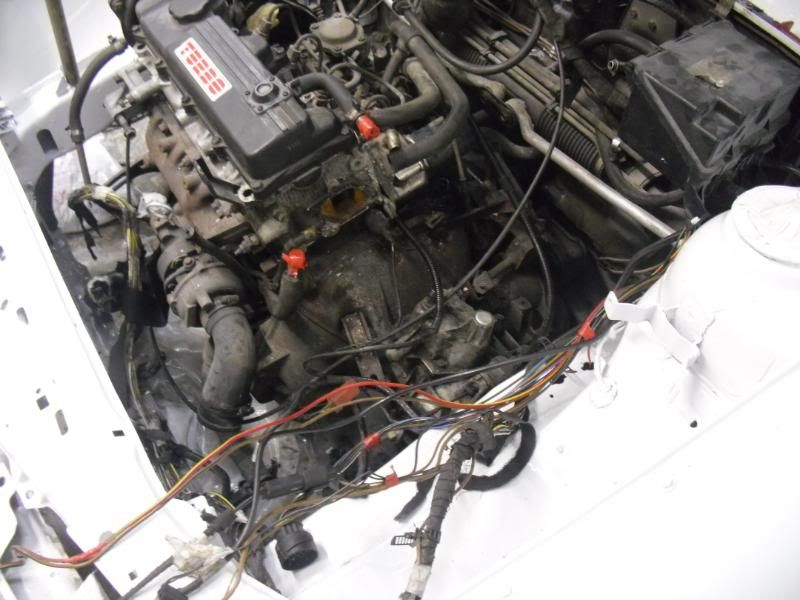

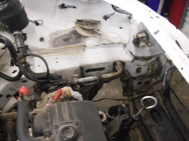

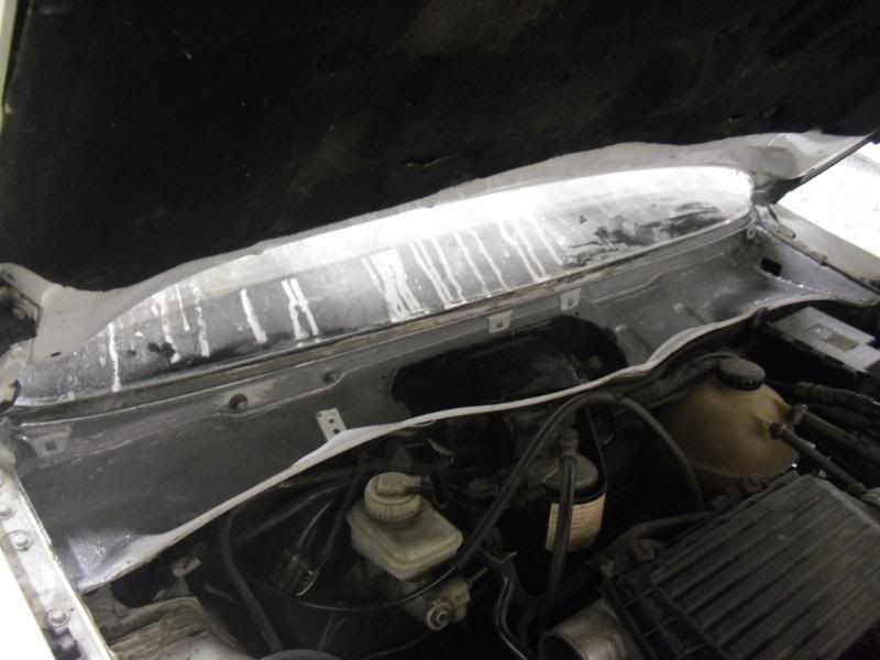

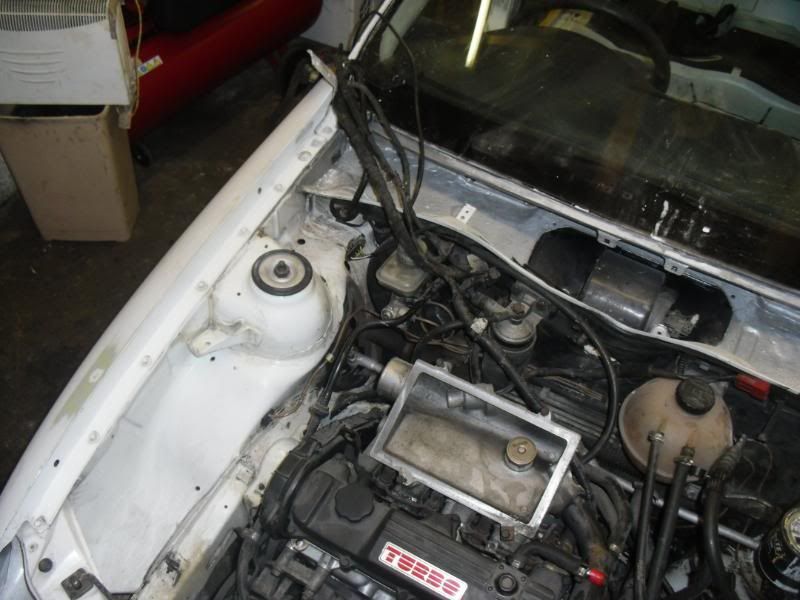

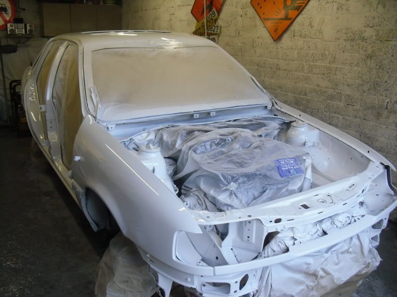

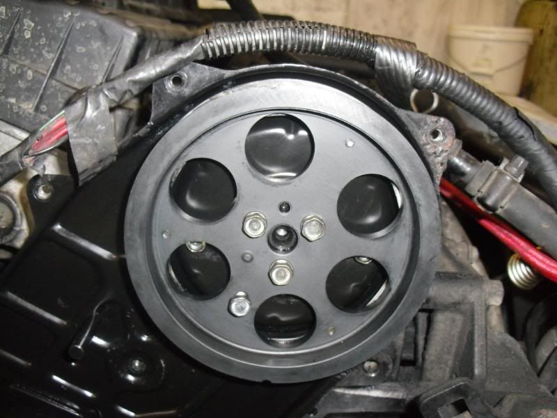

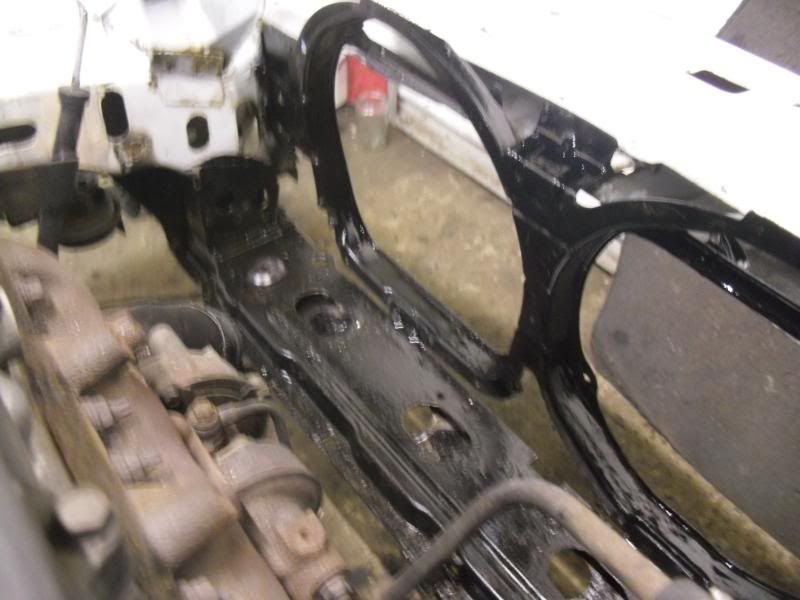

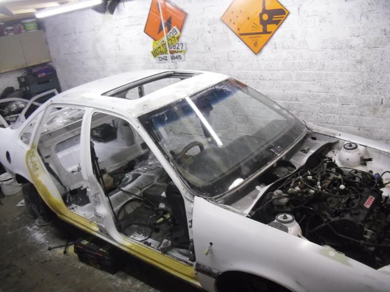

Well on to the engine bay for a bit of a tidy up and a lick of paint. Battery will be moved to the boot so I cut out the tray, I was going to smooth the lot but with the engine in its not very practical. If the engine ever has to come out then I may do the bay again.
Ive been doing everything myself up until the spraying and a little bit of help with getting the fillers right, after all the prep its not worth the risk of ending up with a shitty paint finish so my sisters fella who is a time served bodyman is doing the spraying. So invested in a a compressor and a bit of plastic to prep the garage and masked up the car.
Everything has been primed now except the bumpers as ive no more room lol. Ive most of the car wet sanded now, just taking my time to leave it perfect before the paint goes on. Just a couple of pics from last night...

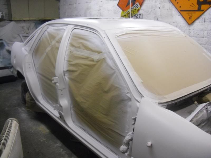

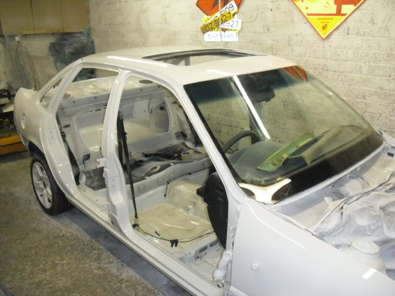

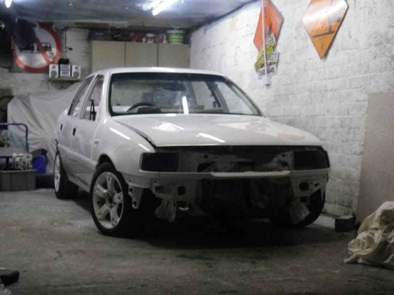

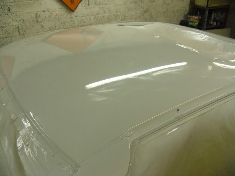

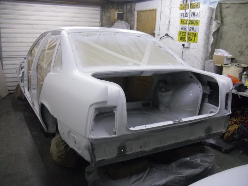

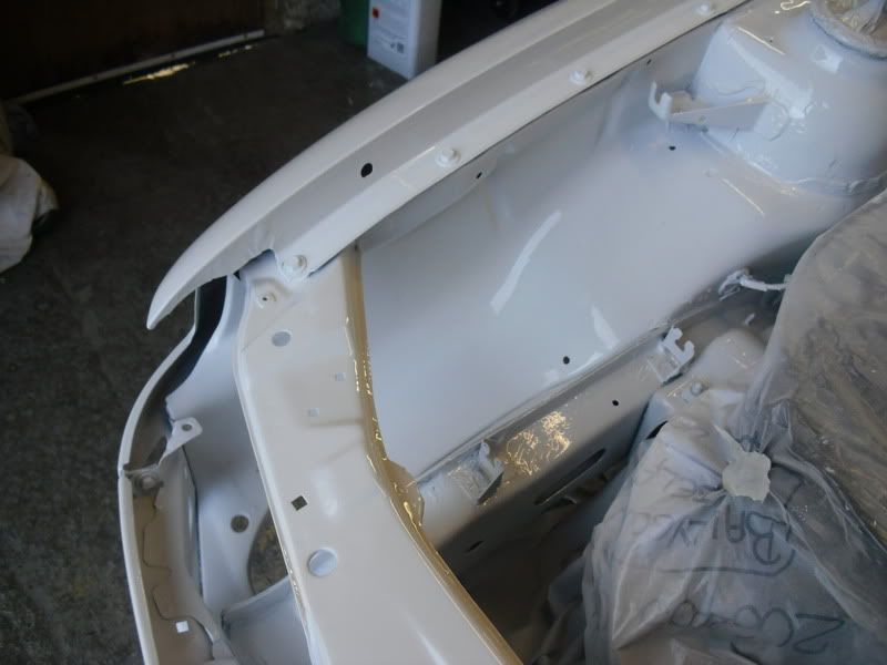

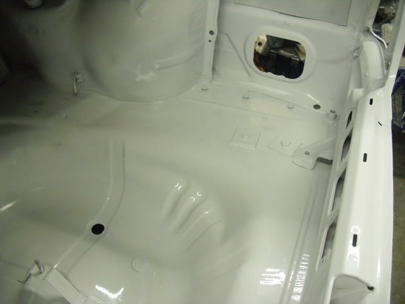

Thanks lads. Tired of having cars half done so decided to do this one right as it'll hold its money, id never get it back out of a 406. But im not doing it for the money or to sell on, just making sure it'll last another few years.

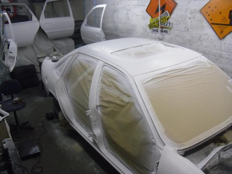

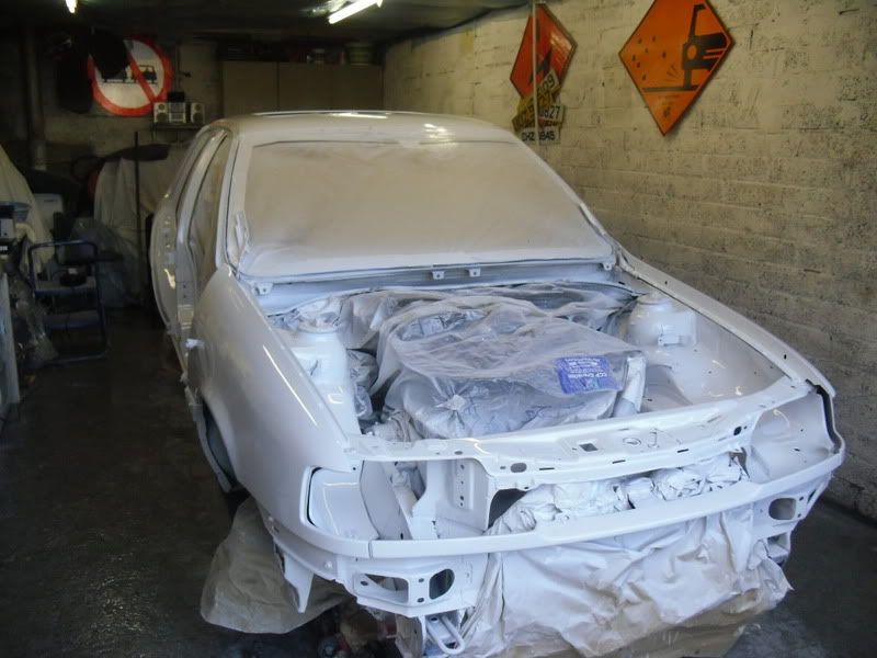

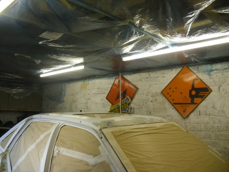

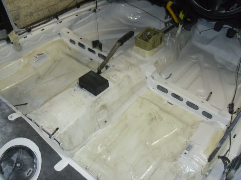

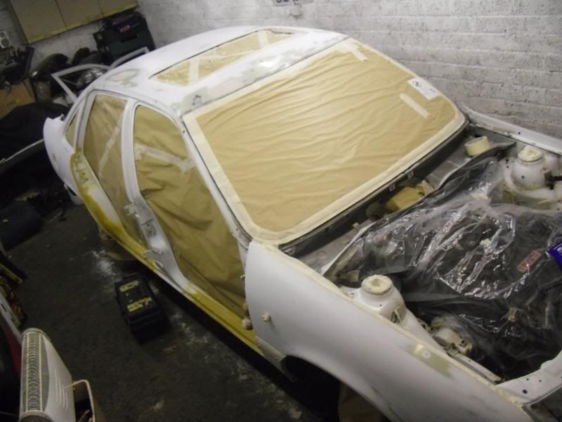

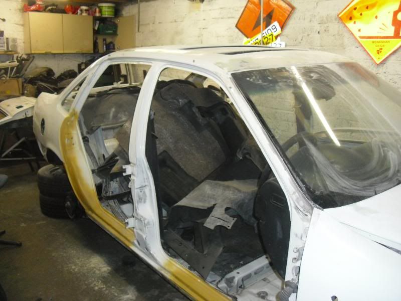

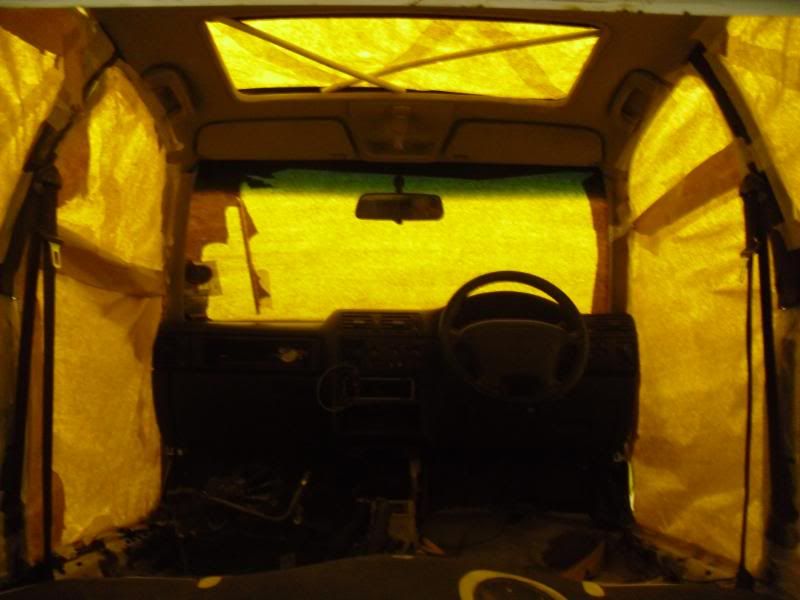

So after alot of time wet sanding cleaning and tiding up we decided with the limited space we would do the car 1st and then do all the other parts together when [TEXT SPEAK] cars rolled out.
So got a lend of a good heater which made for a comical sight on the road, and was added to my list of things that dont fit in the boot of a saloon. :L This was just before it was lifted out, it was well tied in and was a 5min journey....
Then after a morning of remasking, cleaning and spraying...

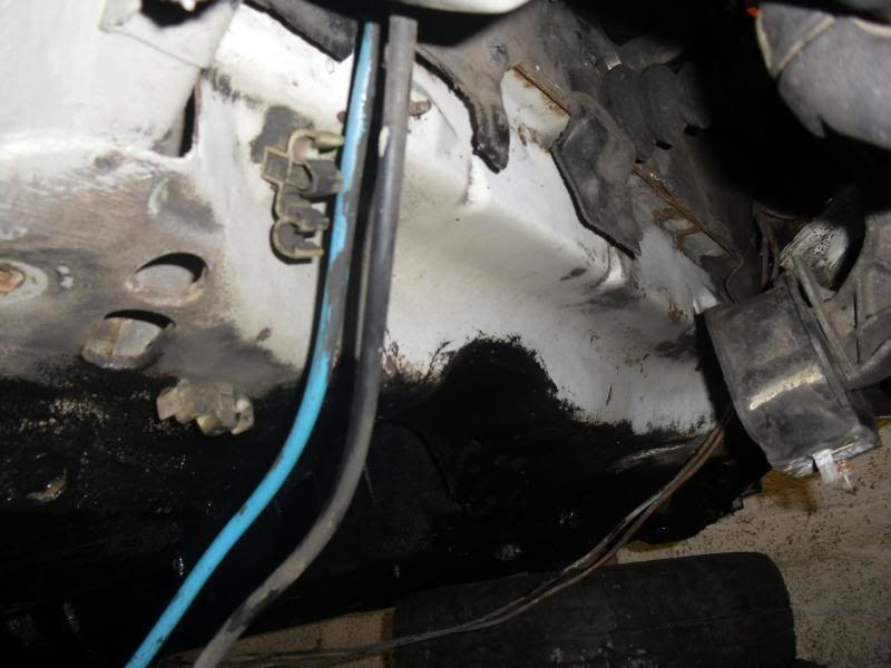

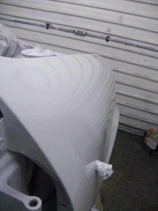

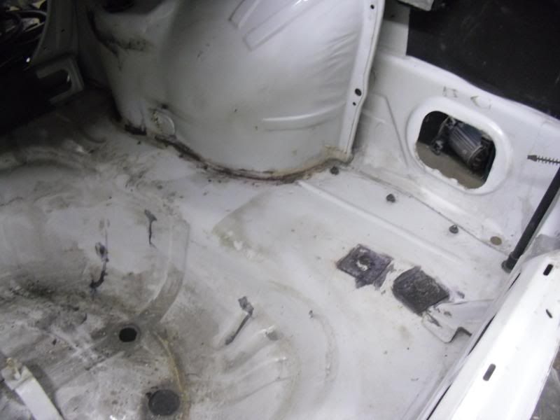

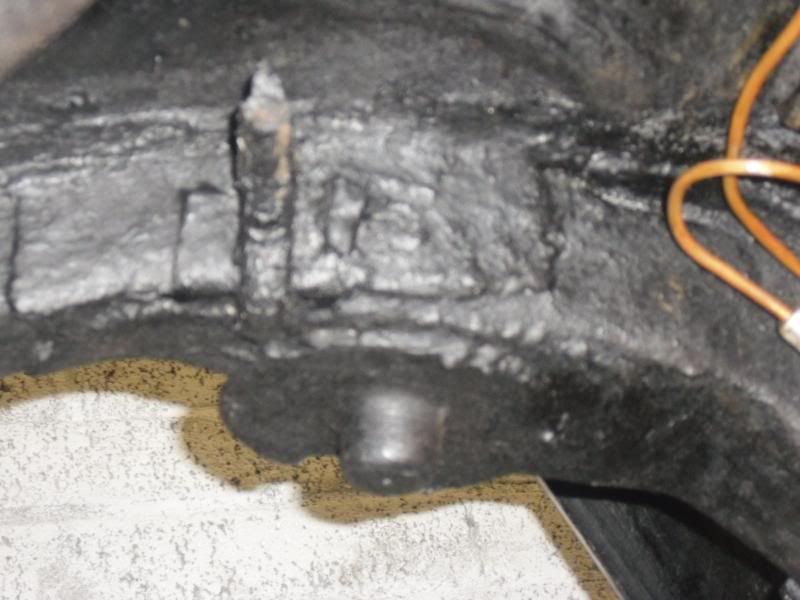

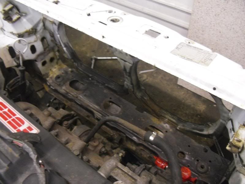

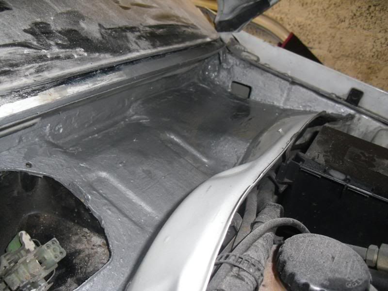

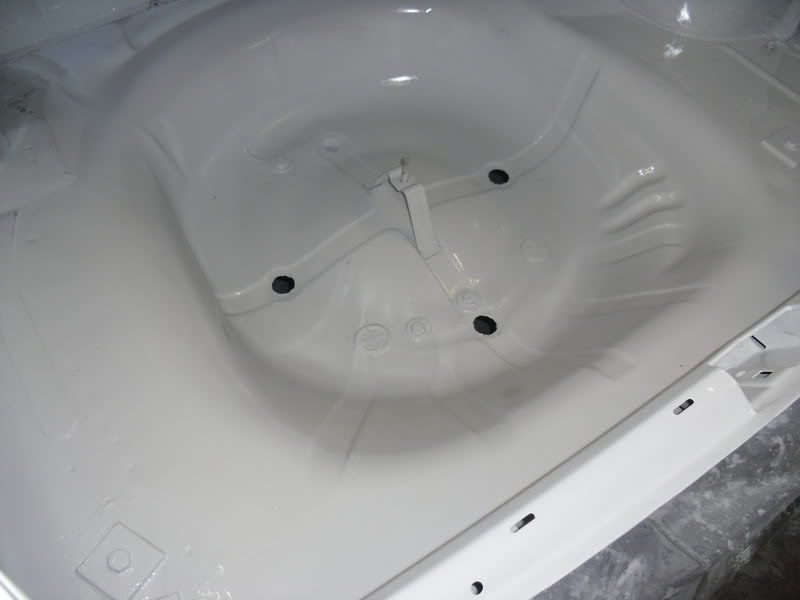

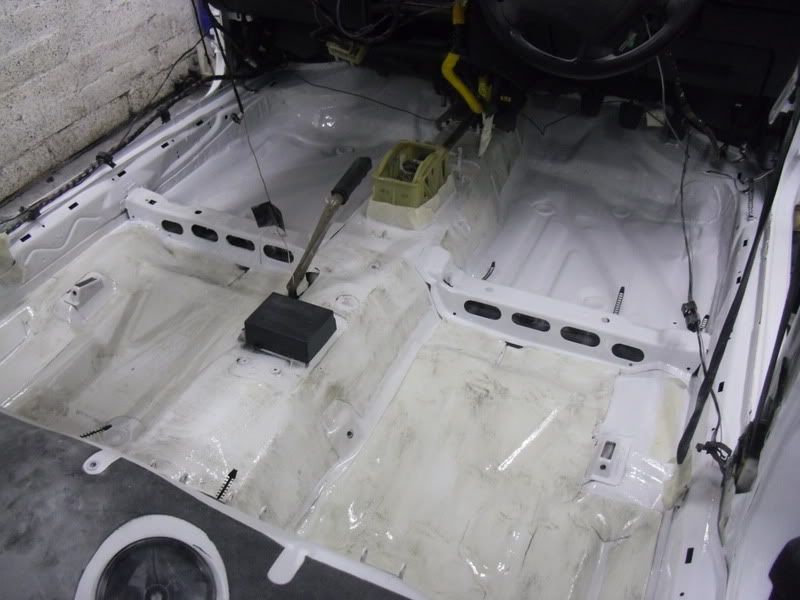

Stripped the masking paper off today and thought to myself that'll not do. lol I know it'll never be seen but I wanted to freshin up the inside floor too. If nothing else it'll help keep the rust back.
After a coat of hammerite im happy with how it turned out so far, except the sound deading. It reacted with the paint so il see if it drys and give it a few more coats, failing that if i can find somewhere that sells it cheap il strip it all out and replace it.

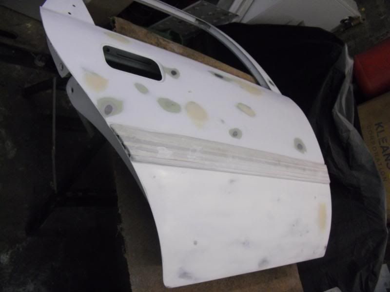

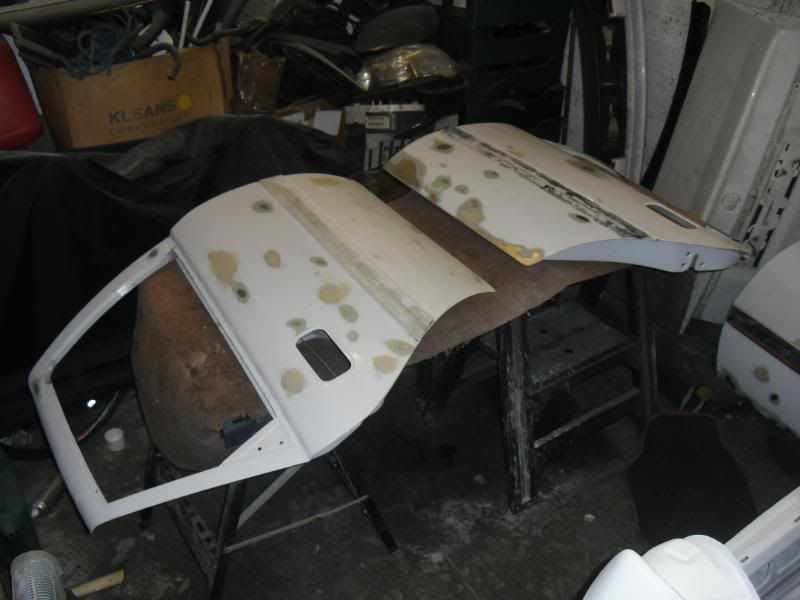

Update.

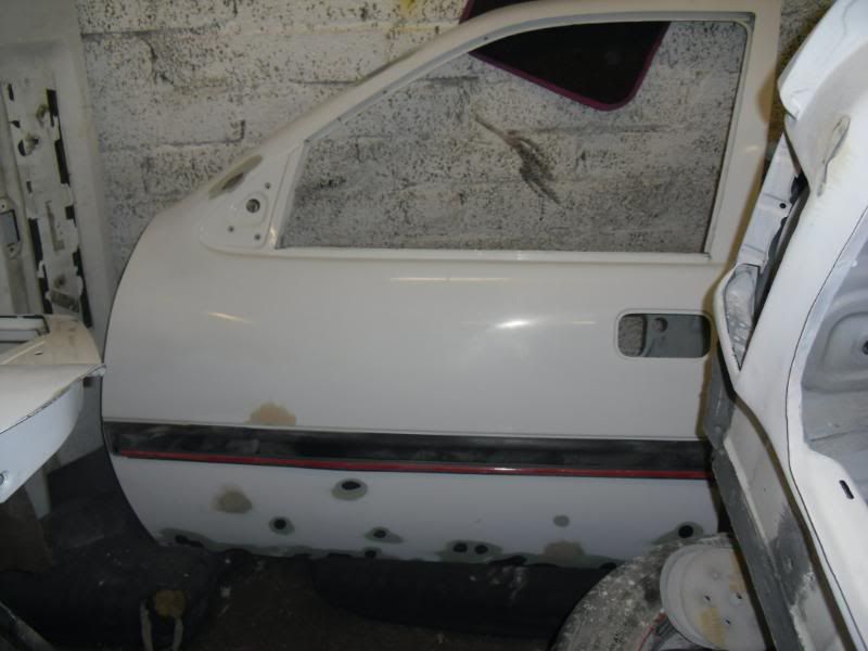

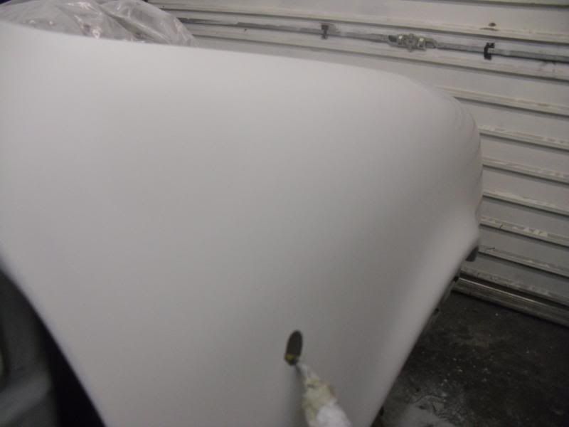

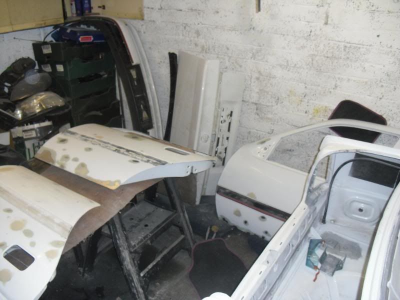

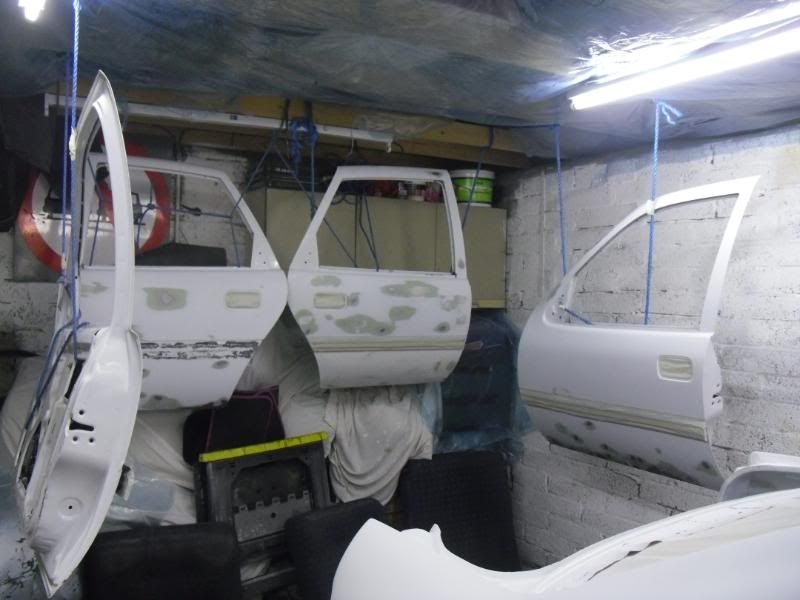

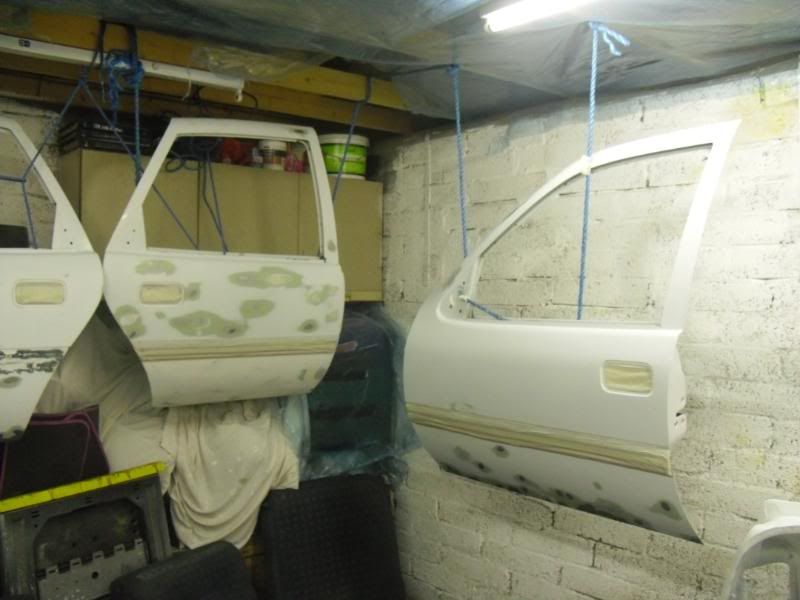

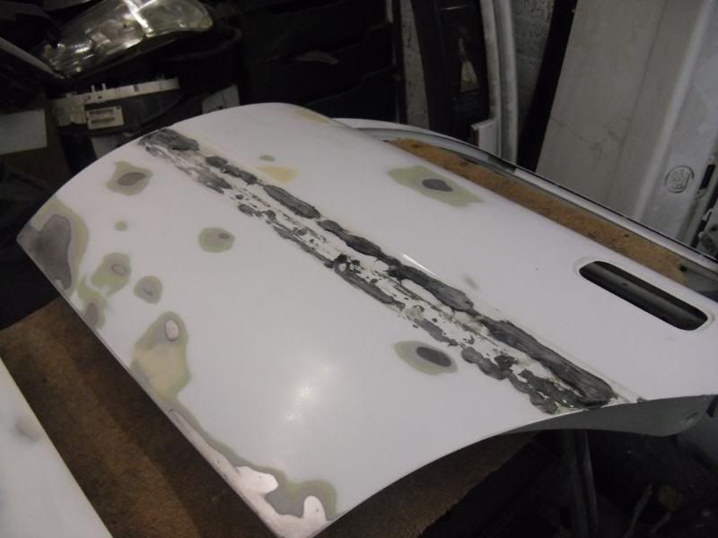

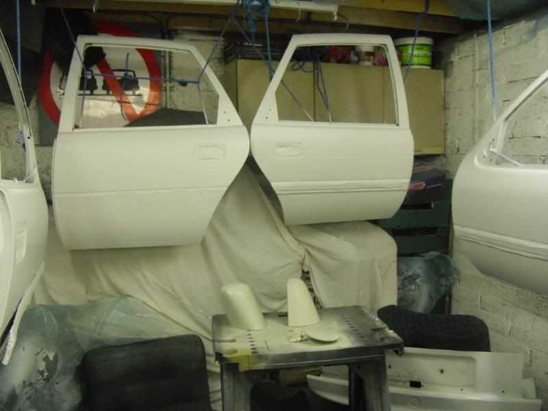

Got a few more panels flattened, cleaned and hung up last night. Handy tip from the bodyman to use brazing rods and hooks to hang them up.I honestly didnt think they would support the weight, but they work well. Alot better for spraying and makes it really quick and easy to put up and take down the panels.
Should have them sprayed and lacquered tonight. Also got the car back on the ground for the 1st time in 4 or 5 months....

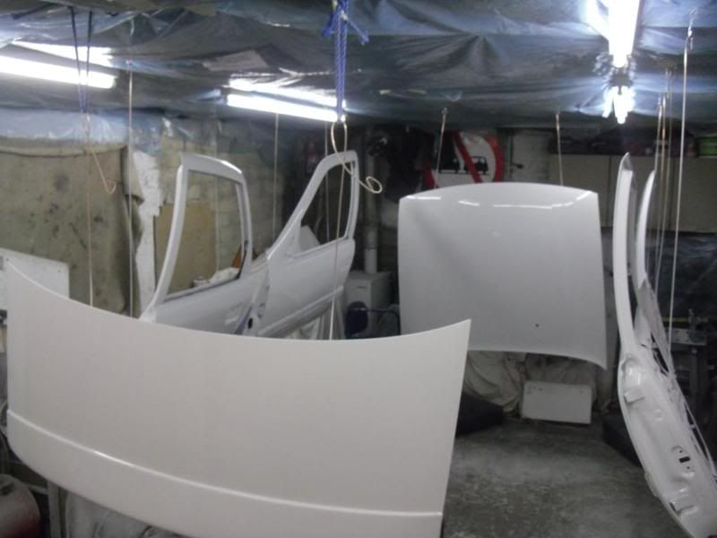

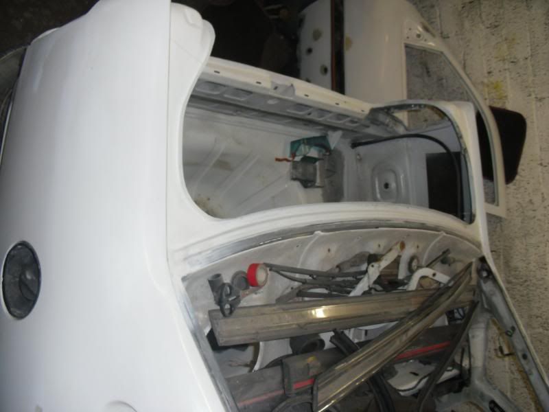

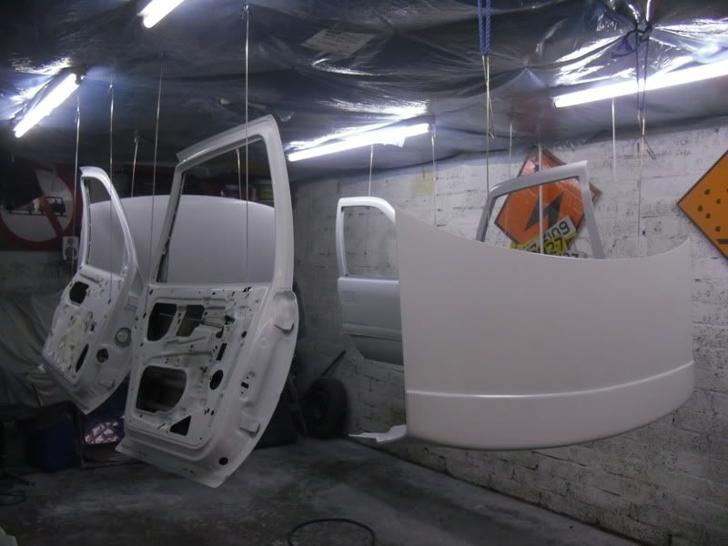

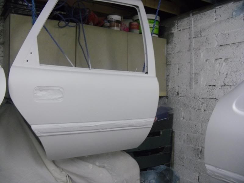

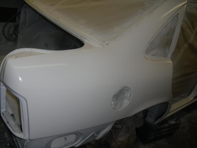

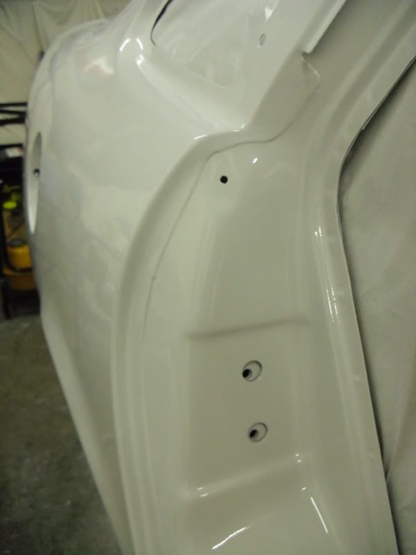

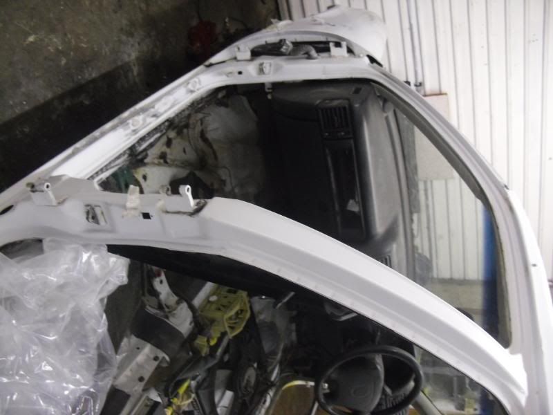

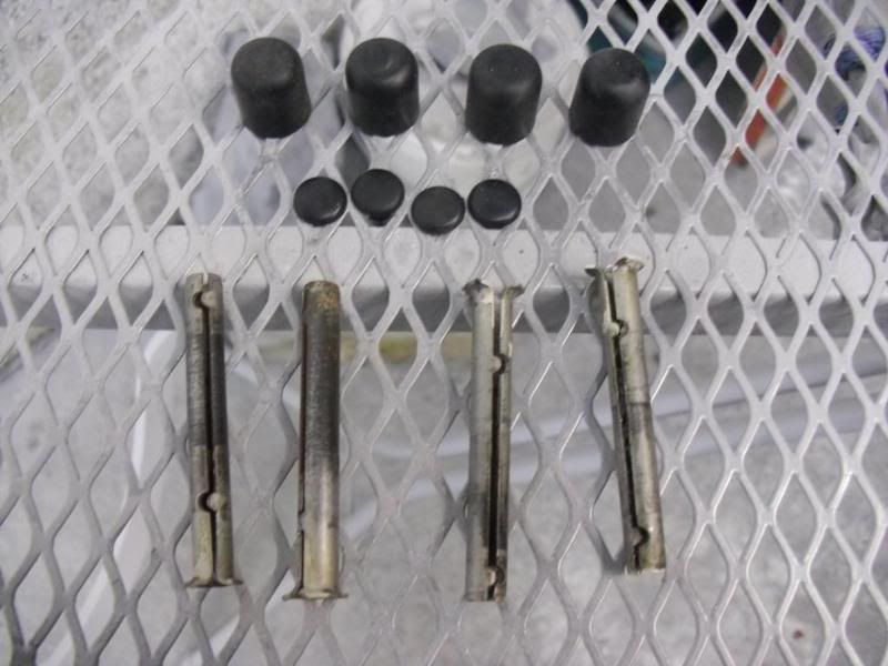

Well after painting the panels and letting them set for a couple of days, I went about fitting them last night. 1st task was trying to remember what order they came off, then work out which box the little bags with all the parts would have ended up in. lol Opening the boxes of screws/bits & bobs was a bit of brain teaser moment but as soon as the parts are going on it'll come back to me.

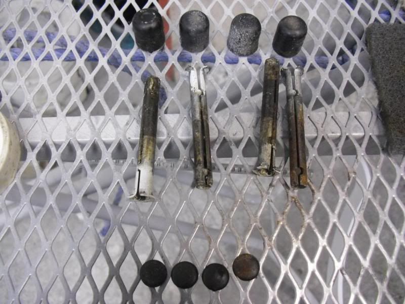

Door pins were cleaned up and packed with grease down through the middle of them. Makes a big difference to how easily the door swings and should stop rust from running out of them. Everything has to be wet sanded and buffed yet before I tweak the alignment as I will need the rubbers on to do it right.
Panels painted…
Door pins before and after…
All panels on…

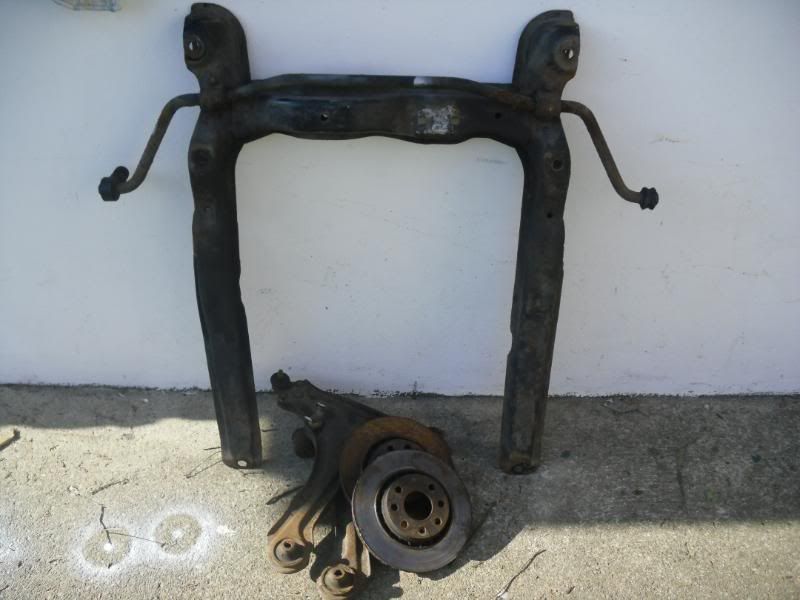

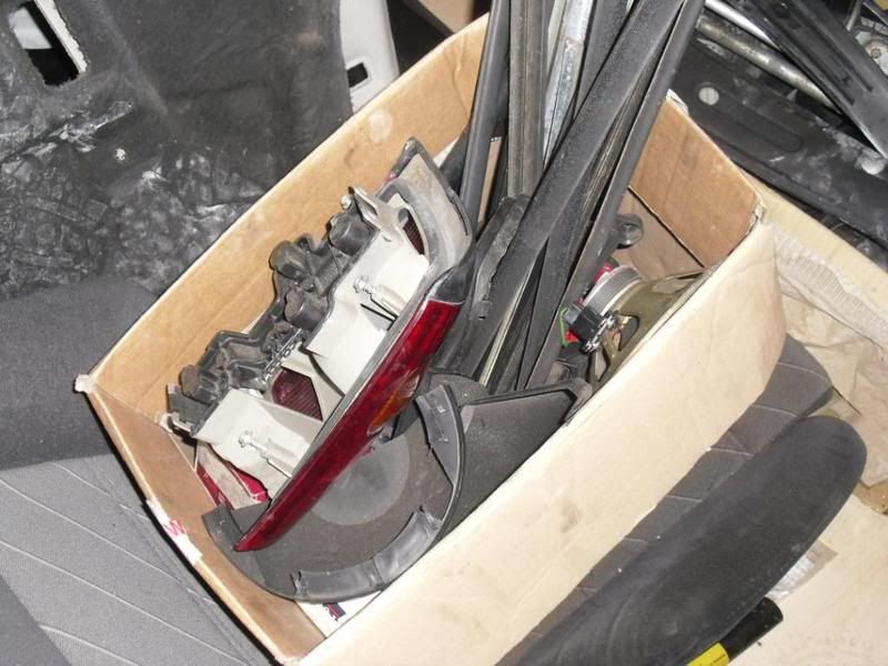

Just some of the parts to be cleaned and put back on...

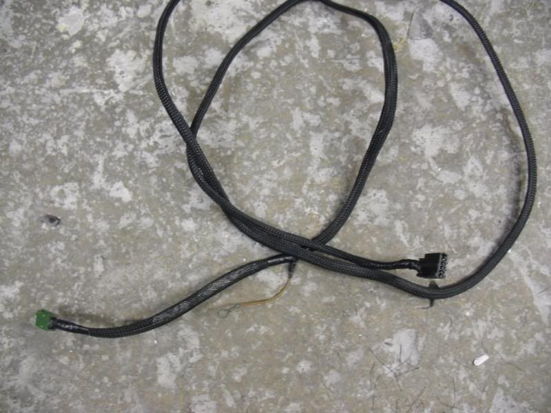

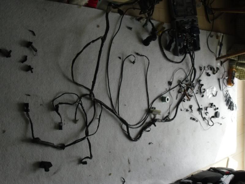

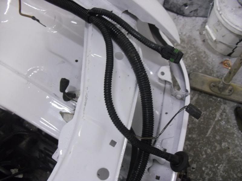

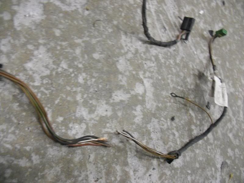

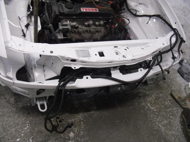

Cheers lads, appreciate the comments coming from fellow cavalier enthusiasts. Ive been on a few times but havent commented as ive been distracted by the 'How 2' threads, each time I have a read through them its another thing added to my list. lol Progress is a bit slow atm, not that im not doing anything, just its taking a bit of time to get a few things sorted before it goes back together.

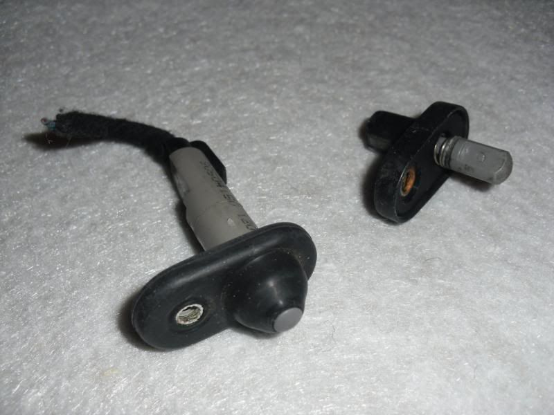

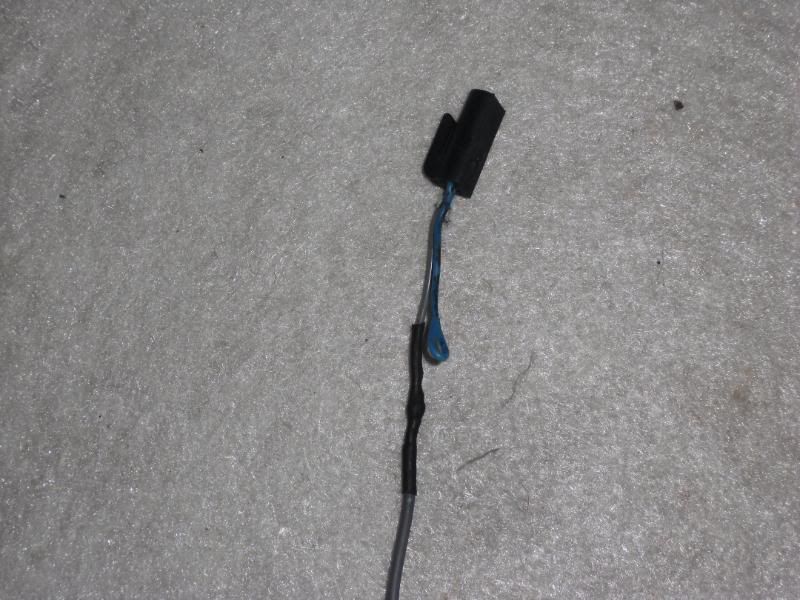

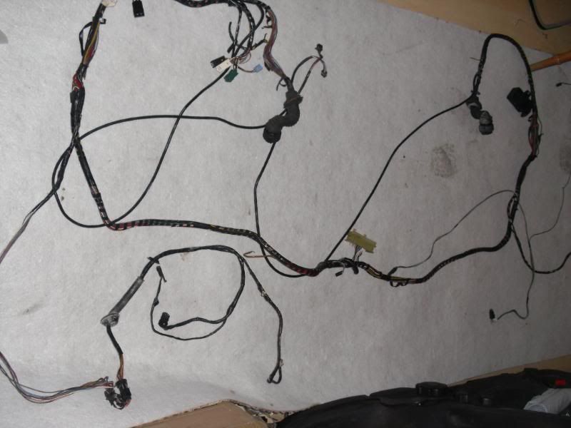

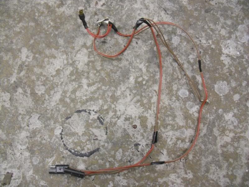

Mainly wiring...
-Recovered the engine and boot loom.
-Cav turbo interior floor loom for the rear windows and wing mirrors
-Upgraded to vectra B door switches
-Electric sunroof live feed
-Reading light and sunvisor power feeds
-Rear grab handle lights and tweeters on the roof.
-Battery tray bolted to boot and cable run to engine bay
Few repairs made to the loom and fitted a couple of connectors so I can simply plug in live and ignition live feeds in the future with out the need to strip and solder again.
Still to do...
-run a few wires for the digital temperature (outside/inside/engine),
-run boost gauge hoses/wiring
-make up + battery connector in engine bay
-Shorten + battery feeds in the bay.
-Make up a few extra earths inc. battery negative
-run the speaker cables for the amp.
-a few extra interior lighting features. upgraded boot lighting
-fit variable omega wiper stalk
-fit vectra b steering wheel with finger tip controls.
-Remote central locking.
Photos of this type of work isnt all that exciting but il throw a couple of for future reference...
Engine loom stripped
Recovered
Floor connecter ready to recieve the new wiring thanks to carls turbo cav.
New loom
Sunvisor loom
Door switches
Damaged Boot central locking loom repaired and covered

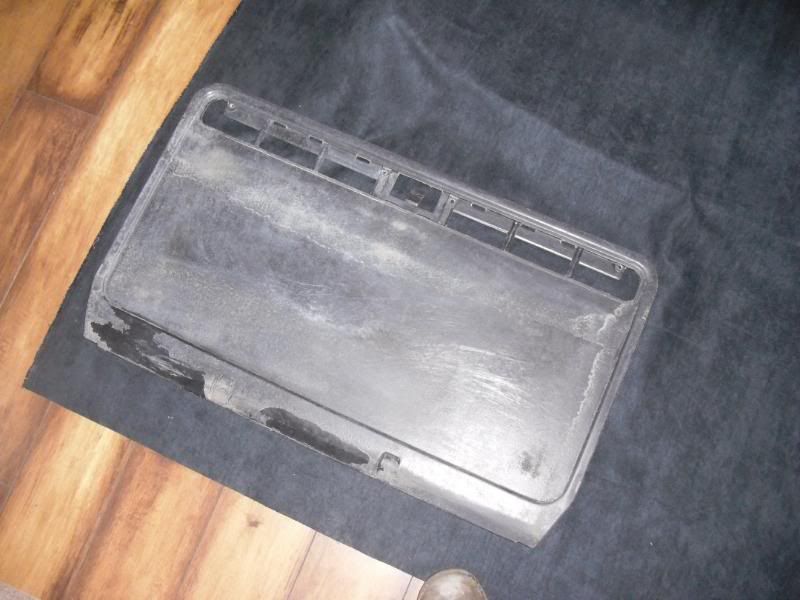

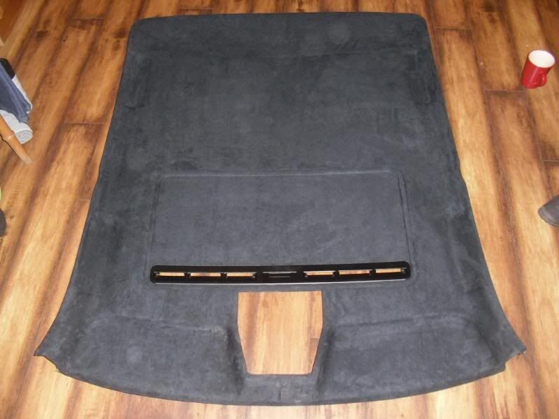

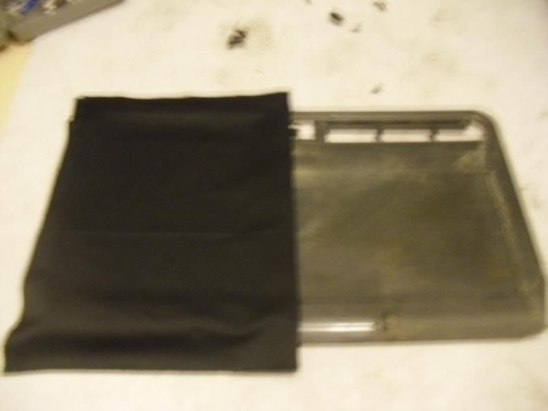

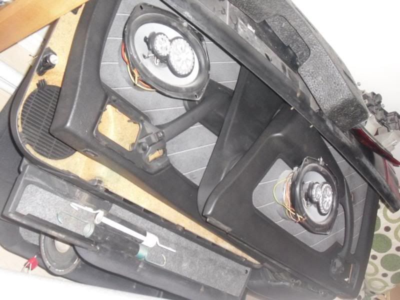

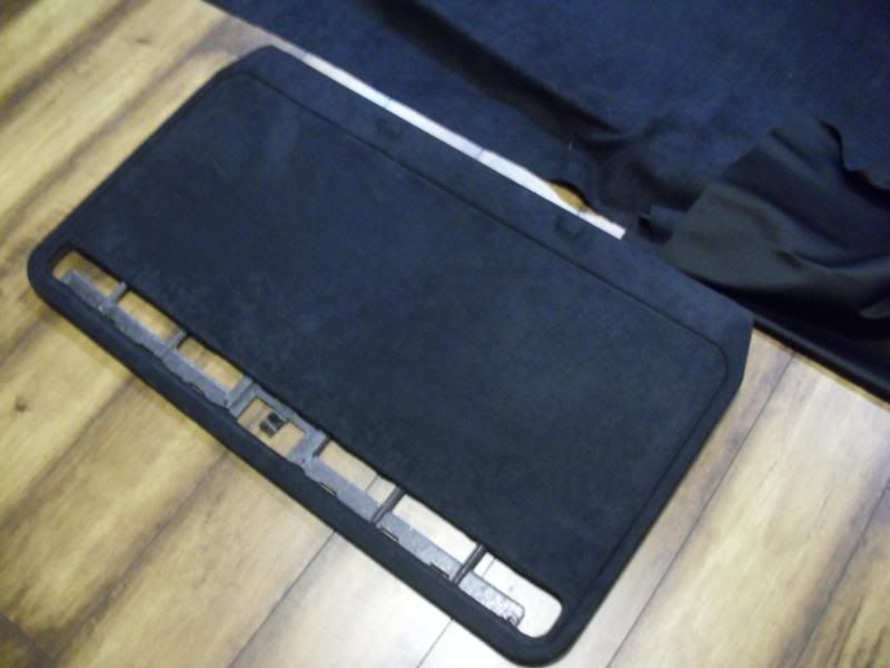

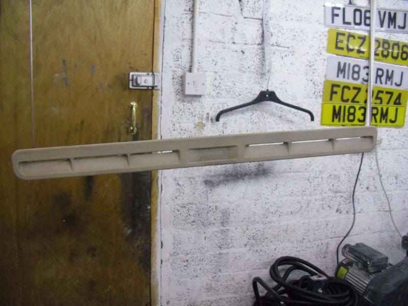

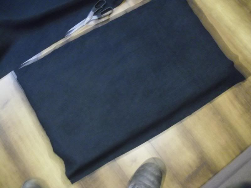

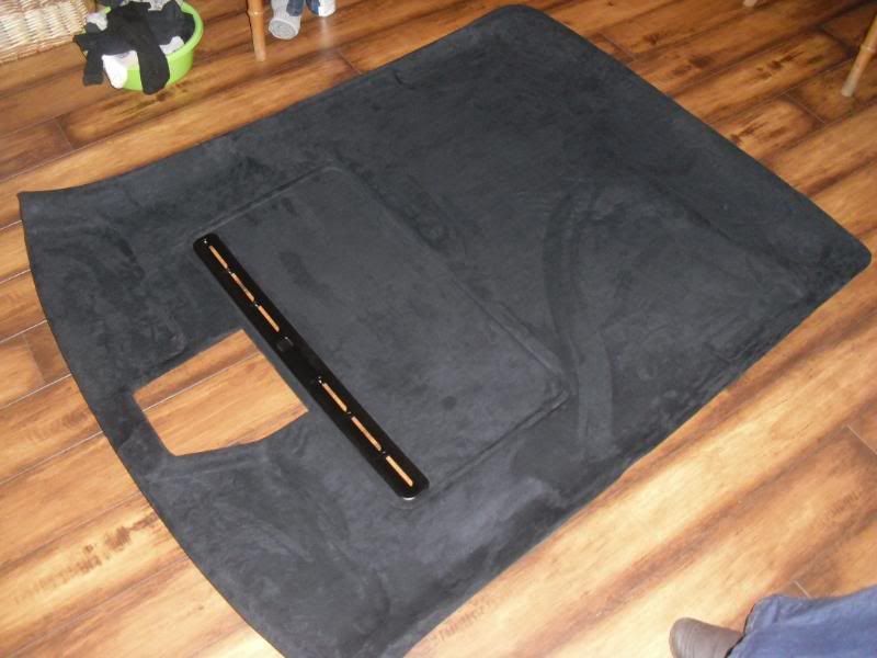

Well ive taken a break from the wiring till I get a junction box for the engine bay. The material arrived for my headlining so I got stuck into that instead. I have the sunroof out to clean it and grease the runners, but more so so that I can recover the sliding cover. Ive no pictures of dismantling it but when I put it back together I will take photos of how it goes together incase anyone decides to do theirs. Will need some plastic primer and satin black today for the plastics.
Panel after stripping the old material and an hour with thinners and a scrapper to remove the foam. 2 Meters of Black faux suede is perfect...
Cut roughly to size with about and inch extra all round...
Then laid on top and folded it in half. This allowed me to spray both the fabric and the panel with contact adhesive. Next get an assistant and both take a corner in one hand and start folding it over while pressing it down, working from the middle outwards to ensure no creases or air pockets. Like turning a page while pushing along the spine working towards the edges. Then repeat for the other side. Allow to set for a 5-10mins then flip it over and trim the edges so that there is about 15mm all the way round. Then repeat as above.

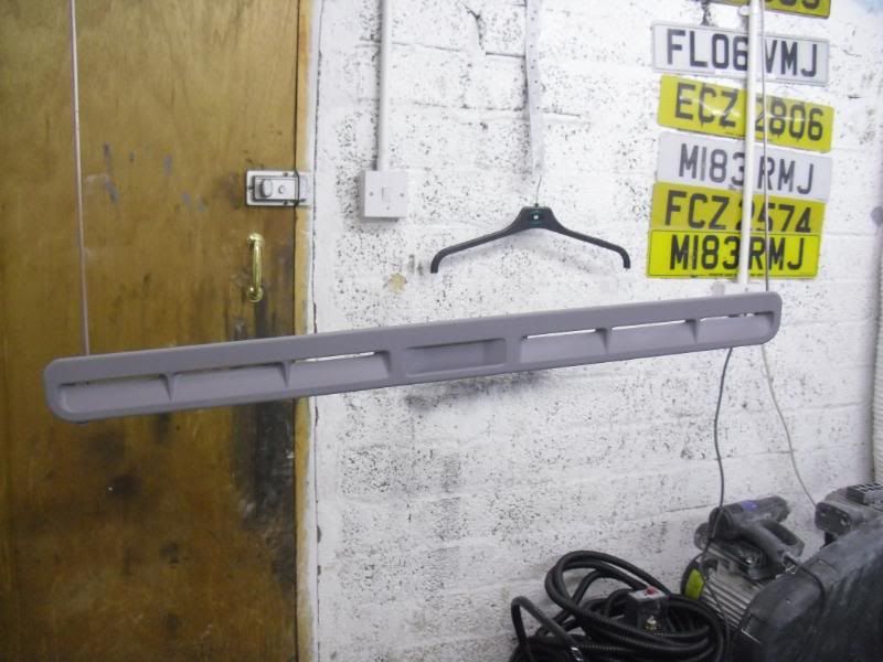

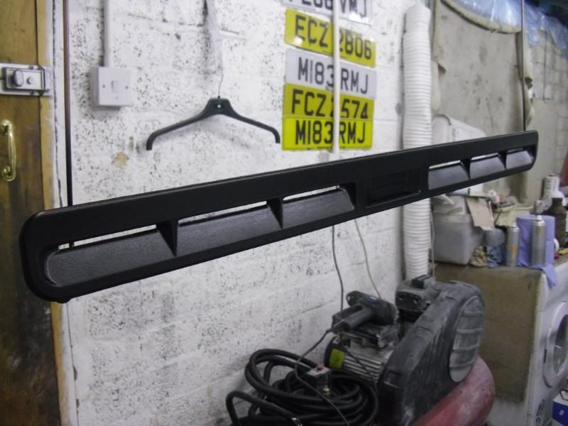

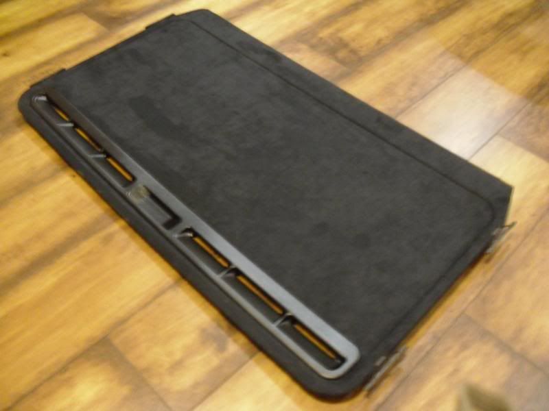

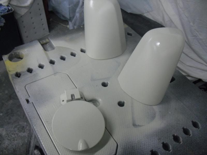

Another step forward. Plastic piece plastic primed and painted satin black. Also Stripped the material and foam from the headlining and recovered in the same way as the sunroof panel. Was a bit harder to do and ended up with a wee smudge of glue seeping throught the material in around the sunvisors. Raging as it was the last bit, but it shouldnt be seen in there. Im happy with how it turned out considering it was my 1st go at it.
