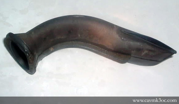

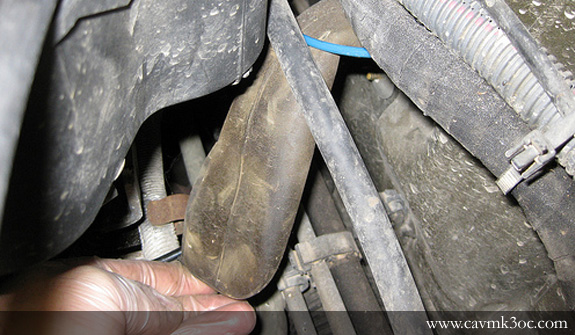

At the back of the engine bay, in the middle against the bulkhead, you will see the scuttle drain. Commonly referred to as the 'Elephant Trunk' it is a rubber tube going from the scuttle designed to channel water etc on to the road below. To prevent anything going back up the tube it has a tapered end, but this is what can get blocked and sealed shut. To clear it, simply squeeze the rubber tube, stick your finger up it and pull out all the old crud. Some people then snip the tapered end off to prevent it from blocking again, but as long as you clean it out regularly enough then you shouldn't experience any further problems. It takes just a minute or two and should stop your car from filling with water.
A couple of pics of the scuttle drain itself:
