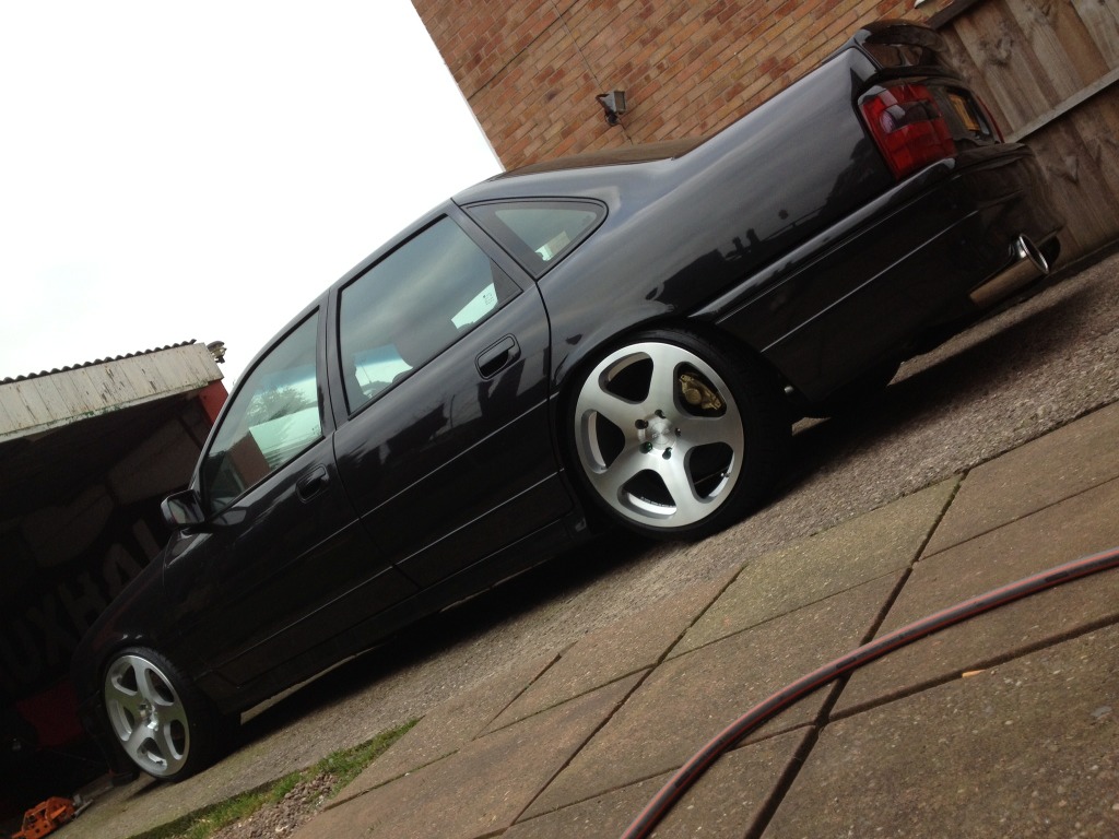

Where to start lol I think I've got reasonable experience in this , first thing il say is cav arches are tiny and wheel manufactures make naff all euro wheels in decent offsets for cavs , it can be done though , I've had lenso's and rotiform s on recently
. The lenso's were a nightmare to fit , extensive wheel arch mods inc rolling ,flaring, and cutting and custom offsets that lenso were not happy about doing at first. Look the nuts though. . Then rotiform s. awesome wheels but at 18x8.5 all round I just felt they were a bit to big for the car. Not to mention the fact that at et45 on the front. They only just fitted with all the arch work done, they where level with the outside of the arch and a fag paper away from the strut ,Re: Wheel size and ET advise

Yes mate that's my car . It's not just the 18,s being too much work I just felt the looked too big for the arches , 17s just look so right the lenso's are 17x7.5 et 30 on the front and 17x8.5 et25 on the back , I've ordered another set of the lenso's but with black centres this time

Ive got on 17x8 et 38 and its very close on the front atch with no liners. Rears are modded with tons of room
