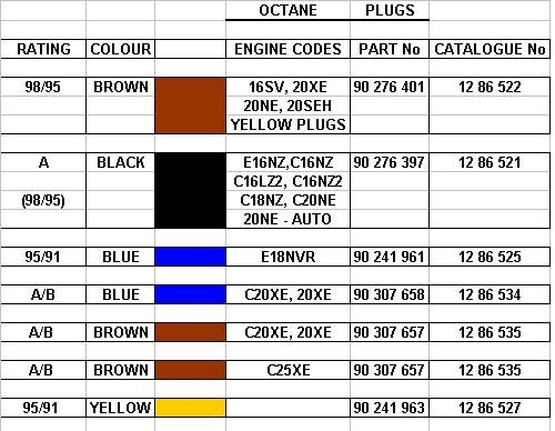

97/98 Ron plug - Where do you find/buy them?

You can turn your Octane Plug over - it is 95 on one side and 98 on the other.
Unclip from holder, unplug, flip over, plug in, and clip back in.
The result of doing this though is that you will induce pinking when driving at anything more than minimal load.
