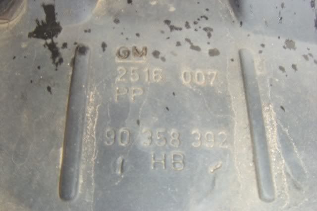

heres the photo of the engine i said i would put up,
am i being a total tit or does this mean its a gm or does that stand for something else?
Re: diesel tuning
Thats the part number stamp for the plastic bit at the back of the bayblaqkaudio009 wrote: am i being a total tit or does this mean its a gm or does that stand for something else?

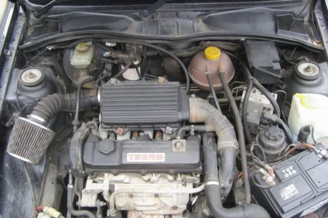

Hi mate.
I noticed in the pic that you have a universal filter there. Just thinking of getting one fitted in my 1.8 petrol. Do you reckon it'll do anything, even a small difference? I'm not thinking about the cheap ones, i want either a K'n'N, or a Pipercross filter. Cheers dude.

Re: diesel tuning
hey, well it didnt feel any different in mine, but im going to bring it futher to the front.
it would make a difference on a petrol. not a huge change, but my mate put one in his petrol astra and he recons you could tell.

Thats an Isuzu lump so its safe to tune.
If it was the Vauxhall TD (which i dont think came in Cavaliers iirc) then the rocker cover and physical looks of the engine are simular to a Petrol 8v.
Its also the same engine as Rich C's on Vxon which has turned up fueling and boost and it also runs nitros (I have pictures of this somewhere too when it was on the rolling road at Jamsport in Northampton.)
What you need to do is remove the white collar from inside the pump and you need the above (boost gauge and control valve) to increase the boost which will up your BHP slightly. This is a known and guaranteed way to extra power. It shouldnt cost you more than around £50 to do either.
A custom exhaust is a good way to go too but this on its own wont achive many extra ponies
If its seems complicated or expensive, id walk away from tuning tbh. As the saying goes, nothing comes for free.
