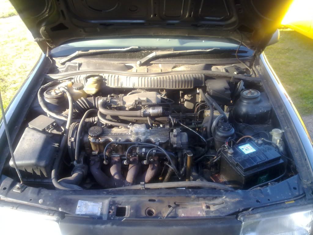

Re: a blonde question
If your engine looks like that, its the silver can thing thats attached to the pipe coming off near the throttle body, pretty much dead centre of the picture

nice one GAZ but alas no it doesn't mine is a 1.8 single point injection in a 95 expression .
its the small black cylinder attached to the throttle housing sort of D sized battery thing.
