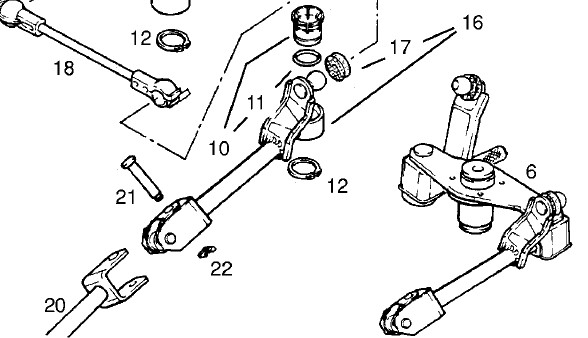

Anyway I had a look today, and I found that the linkage in the drawings below, had become damaged / worn-out.
There is a spring steel 2 piece hollow pin that joins the two parts together.
Part number 21.
One end has a flange, and the other end is tapered to take a captive circlip.
The tapered narrow end upon which the retaining clip was meant to sit, had broken off.
This was allowing the joint to move quite at the point where the taper sat.
Now the original split pin is no longer available, and I didn't have the time to wait for my dealer to order an equivalent one in!! This is my regular work horse!!
Now the fix!!
I cut off the remnants of the taper - as shown by the red line. Using sharp tin-snips.

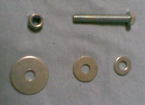

It is then possible to push an M6 bolt through the joint, inside the split pin (in the direction of the blue arrow..
Now I know we all know what nuts bolts and washers look like, but this is just to show the range available.
I had three sizes of washer available...
a standard M6 washer is approx 13mm ( 1/2") across.
the middle size is approx 16mm (5/8") across and
the large washer shown is 25mm (1") across...these are often called Sella Washers or Penny washers.
I used a middle sized M6 washer under the head of the screw (to retain the split pin) and also fitted another washer on the other end along with a Nyloc Nut.
The result, is that my linkage is firm again (no excessive movement) and my gears all select cleanly.

nice one, how long is the m6 bolt though?
Posts: 11034
Re: No 1st & 2nd Gear - Now fixed
Sounds long, but I used a 50mm long bolt (just three threads showing through nylon ring of nyloc nut).
