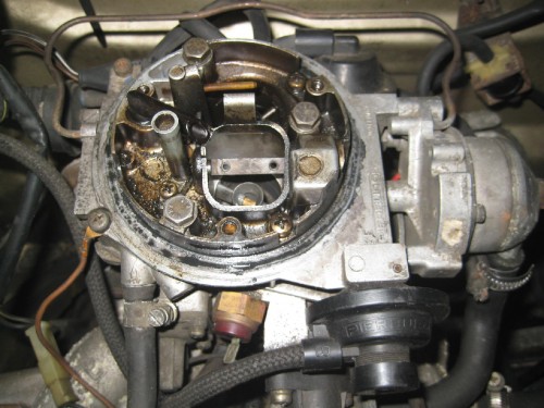

Re: Starting Problem
marksmith wrote:
planetc wrote:Does the starter kick in and turn the engine over? Think we all assumed it did until those last couple of posts, if it does then it is not gonna be an inhibitor issue. Again, if it does, I just read back through the topic, it might be worth looking at the choke mass.
Can you tell me where to find the choke mass, what to check for and how to rectify it if it is fauly please mate ?
My mechanical knowledge is very low :-(
On the side of the carb, the thing with the pipes going to it in this picture
It is held on by three screws, mark the domed casing so that you can refit in the same orientation as it was removed, remove the screws and pull off the assembly (sometimes it needs a tap). Inside there is a flat coiled bimetallic spring that locates over a lever arm to operate the choke on the carb. Behind this is a fine wire heating coil that sits in a ceramic holder. All these parts should be firmly attached to the metal casing and if they are not then you will have random choke operation and hence poor starting. It can give choke when it's not needed and equally none when it is needed. They can get really bad sometimes and when you remove the 3 screws it all falls apart. The cure is to replace the unit.
