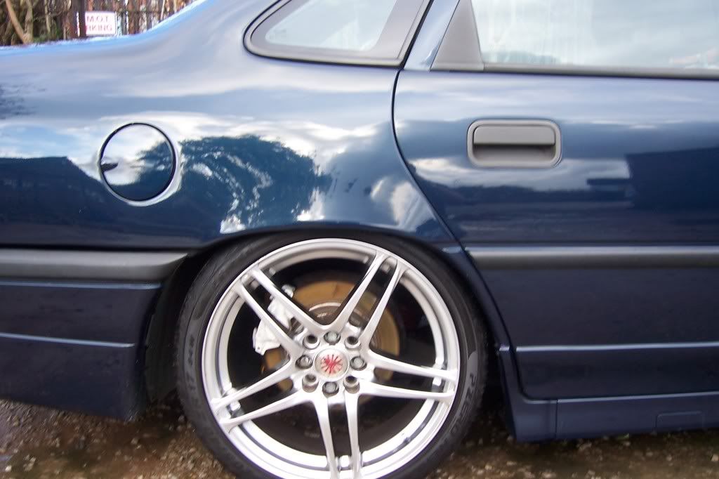

Post by diddygsi »
Pimpvehicle wrote: :shock: Thats stupidly low, your camber must of been mad lol. Got any piccies?
the camber was mad the rear tyres used to last 4-5k max

Post by Pimpvehicle »
Oh thats sexy lol, The BTCC Cavalier Cleland and Thompson had must of been nearly 150mm lowered!, surely when you get that low tho the CV joints are under immense strain, bushes etc.
