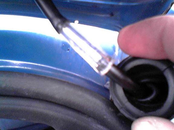

Attempted another fix up of the rear washer hose which was the culprit in the water entry... This was the problem...
Split into two, for no reason whatsoever.... I assume somebody previously either replaced the grommet and cut the hose or it split itself..
Before I stuck a WD-40 straw in both sections as a bridge and taped it up. Worked for a while.. did it again... de ja vu.. so I got an idea today...

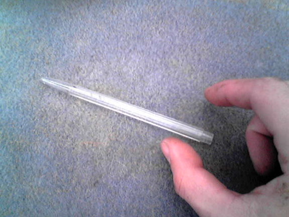

The most readily available bit of solid pipe I could find was a pen...

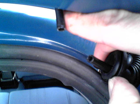

I cut it down to size, and wedged the hose sections onto it...

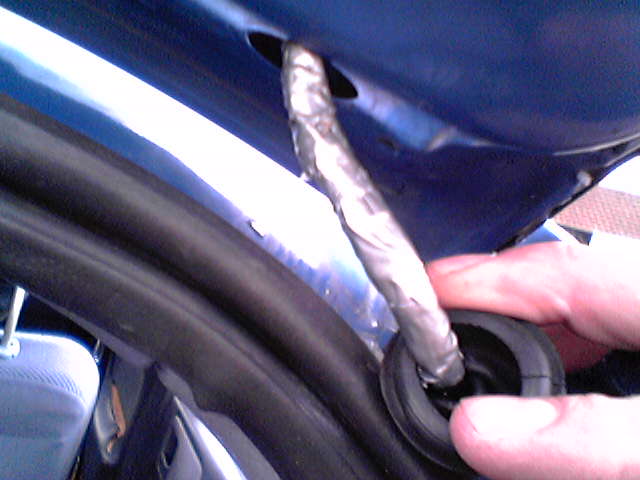

Then gaffer taped it up... the tape is supposed to be waterproof so should work.... before I used electrical tape..
Tested it, no leaks so far, hoping that it's sorted now. Was a bit fiddly but got there in the end. I'll keep an eye on it.

Andrei, The tape will be water repellant, but I doubt the glue will be, you may find your self back at square one in a few months. A section of brass tube from a hobby/model shop would be ideal as you can get a snug fit and shrink wrap around the out side would seal it better.

Not a bad idea Gaz
might pick one up from halfords or wherever. Cheers.

if the pipe is the solid stuff you might need to heat it up a bit to get it to take right but its not an issue
Re: Water in the boot...
Ye, just need the right diameter that's all
