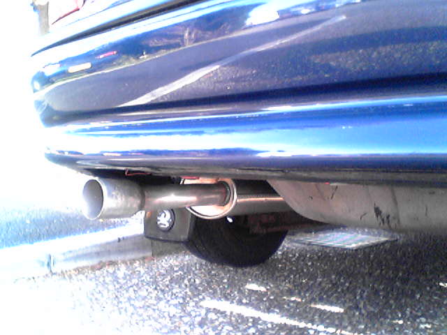

Here she is :D
Its nice to see some shiny stainless steel in place of the old corroded grimey box with a fat hole in it.
