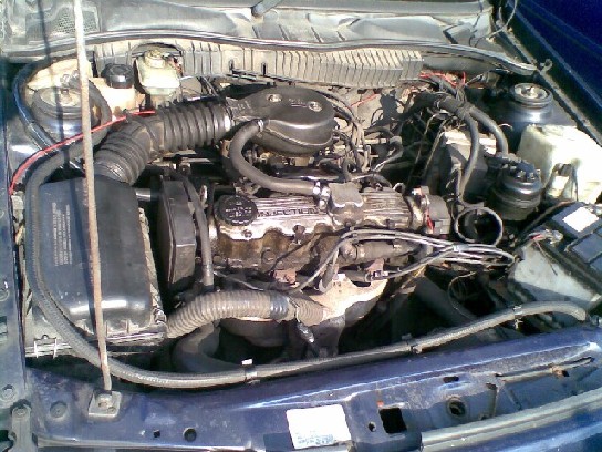

It is more than like a single point injection unit, referred to as a C18NZ.
It is Vauxhall's "Economy" engine, but only gives about 89 bhp.
Here is my rather mucky engine, which is also a C18NZ.
Yours will be 1000 times cleaner than this!!

Robsey wrote:It is more than like a single point injection unit, referred to as a C18NZ.
Why? mine isn't any cleaner :shock: :o

I take it then, you didn't look at my embarrassingly oily cam housing.
It isn't leaking now, but it is still caked in oil and dirt.
The rest is quite clean-ish apart from an oil leak at the bottom of my bell housing - leaking rear crank seal.
And if you look at the cam-belt change How 2 that I did, then there is oil spattered on the wishbones / subframe.
