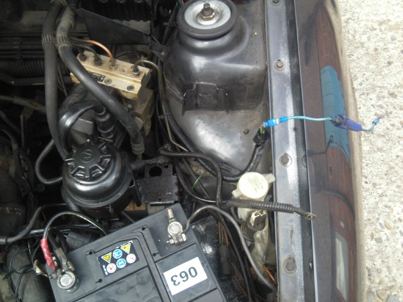

Howdy again, another day, another problem lol
Ive been looking around today while putting the abs box back together for anything else out of the norm, and there are two wires here, connected to nothing, the black one has my attention as it seems to go down to a wire, and part of that wire goes back to the abs.
Now as you can see from the pics the last owner had some fun with the black battery wire so it is now all connected to the side of the car wing with another wire stuck in the connector.
Where could these wires go? and with any luck could it help my abs problem?

what colour is the original loom wire ? cant make it out properly
Re: Some Unconnected Wires Under the Bonnet
as branny said. Is it connected into a plug or just onto wiring its hard to tell

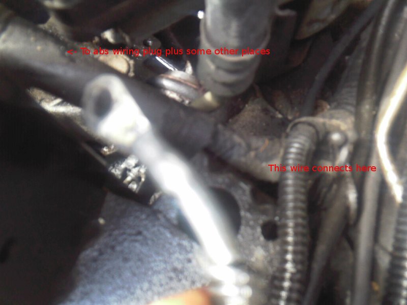

Well, went back out and took some more photos, the black wire is really go me thinking, inside the cover its a black wire all the way, and connects to a bigger pipe below (the first pic) and then that pipe goes all over, including the the plug that goes into the abs black box
The blue wire is connected to a green wire that then runs right up past the diagnostic towards the back of the dash (the green wire in the second photo)

Was looking in this showroom thread and noticed in the engine shot of this thread with the same engine, the black wire is seen going up to the positive battery, so i thought, why not?
viewtopic.php?f=22&t=2546
Well super, my abs light has now gone out!!!
No more warning lights to worry about now, time to get it up to date with maintenance now, then get the bodywork sorted!

Should have really added too, the other wire (the blue connection going to the green wire is still a mystery too me, im going to have to follow it and see where it goes, dont really want to connect it yet in case i blow something else up lol

im sure the rev counter wire is green.
id trace any non standard wires back to where you can. I always try to get rid of wires that someone else has bodged in.
