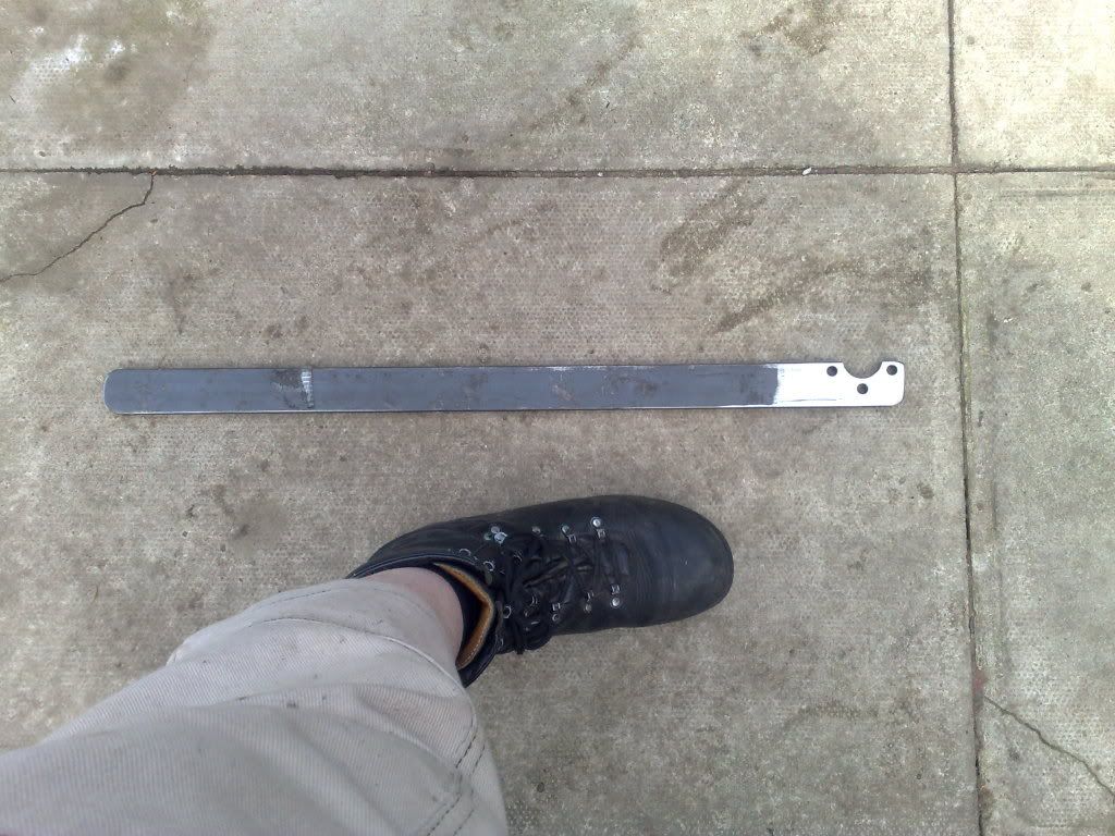

Realised after 5pm I was out of oil so not quite finished yet, but as far as I can tell she's done... didn't make the tool myself but a local engineer did it for me... not that I couldn't but they have pillar drills which I don't so it was easier to pay someone this time.
The tool they made thou is obscene
two and a half foot of 10mm steel bar... you could lever the mini off the ground with it!

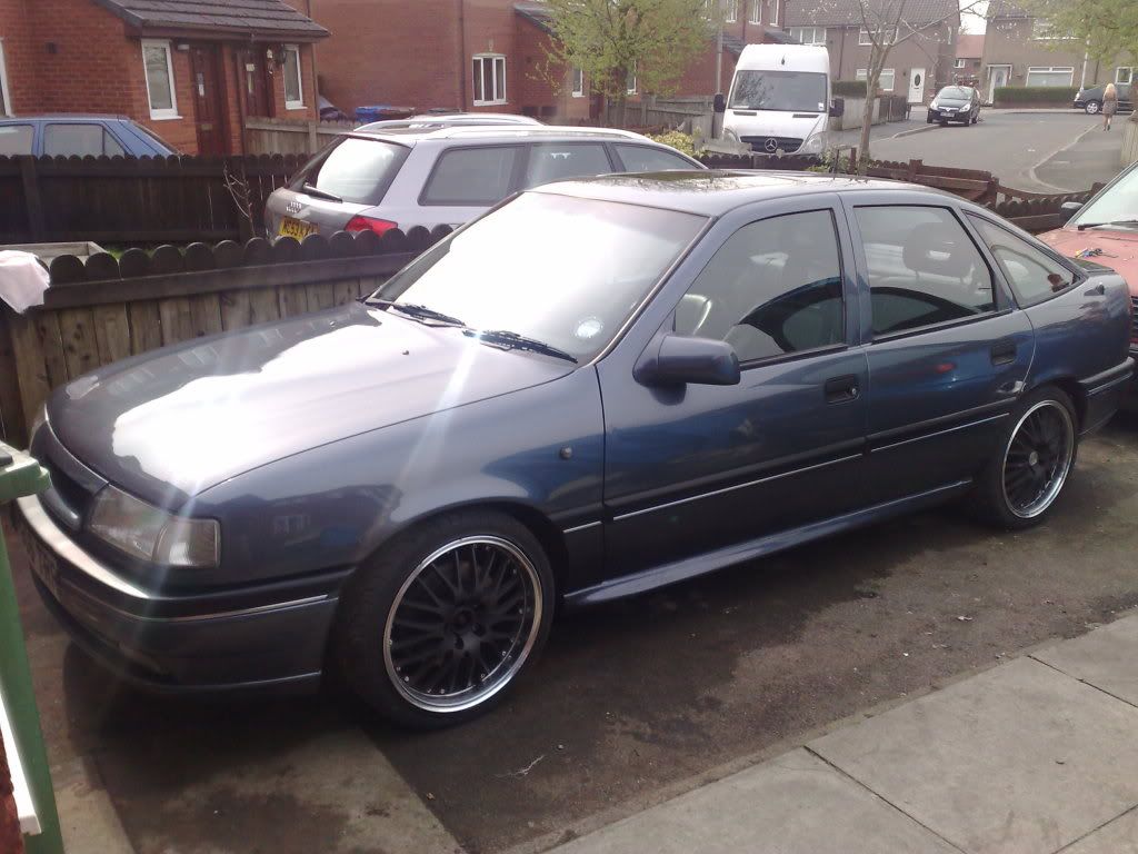

Gave her a quick clean today/yesterday took it nice and slow relaxing in the sun... photos have been taken on a camera phone so they look a little dull and not as sunny as it actually was... not been polished yet thou.
Shiny...

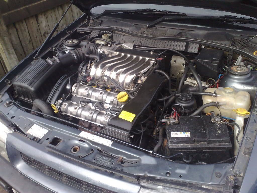

The engine bay prior to a clean... not that it has been cleaned yet, that's for tomorrow if it stays nice...
...and the tool I had made...
Left my foot in the picture to show size... I'm in size 11's...
Shiny...
Re: Squig's CDX v6; WIP
Car looks nice and shiney!

The tool you made is a bigger version of the one I made. It makes the job of doing the big crank a lot easyer. Your car is looking very good too
