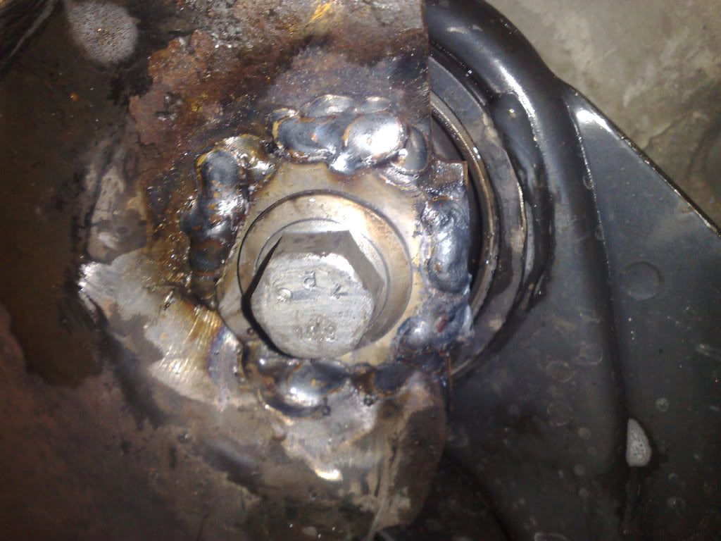

So the garage I like using fixed the issue with two chunky washers welded in place on both sides and the result was a massive handling improvement. However the knocking I'd associated with the wishbone issue wasn't a wishbone issue but a steering rack bushes issue.

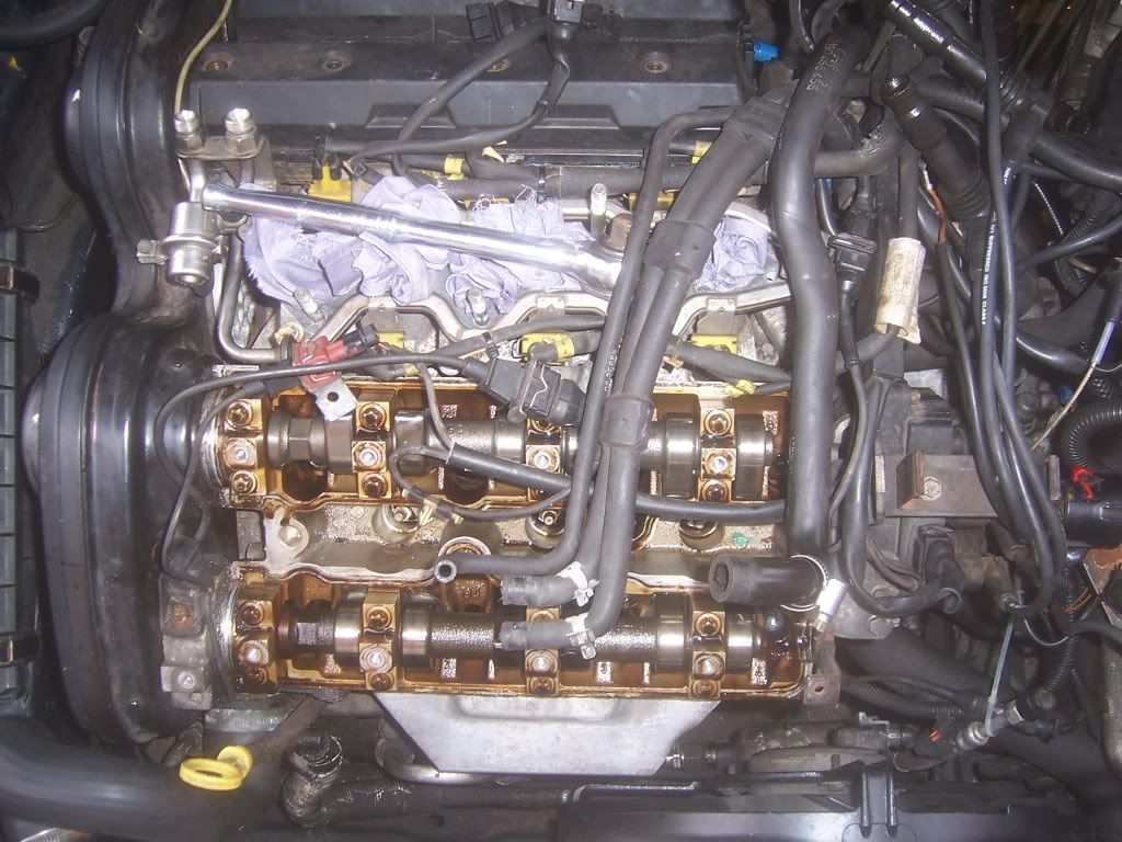

Some of the coffee-like remnants after the quick jet wash

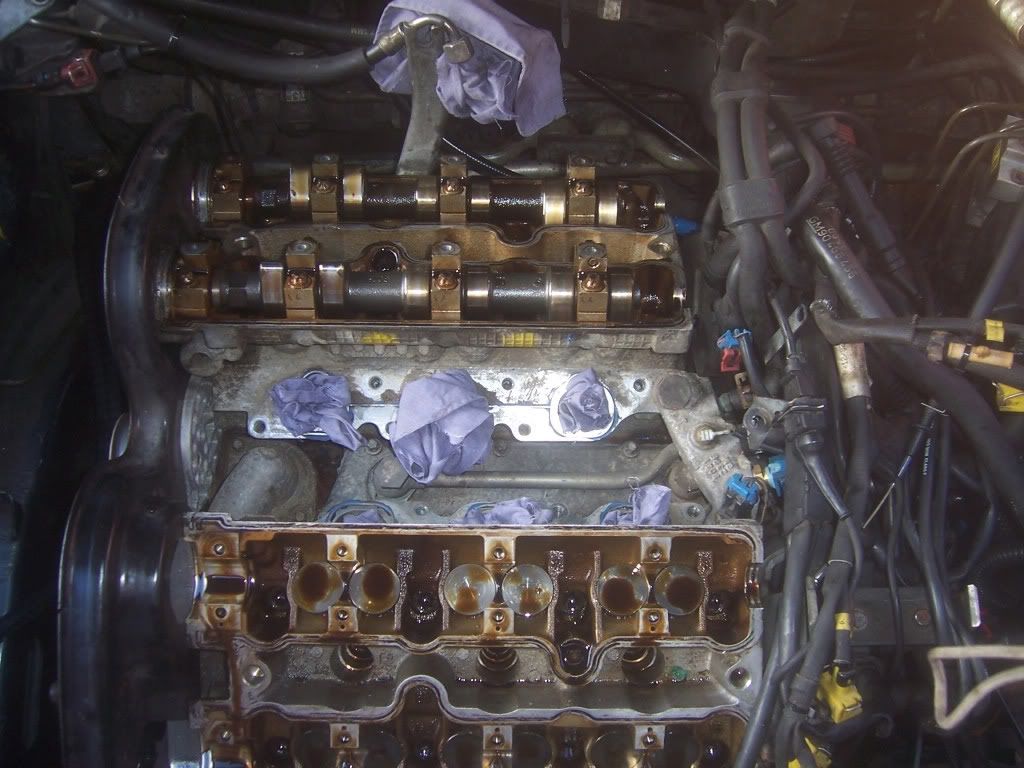

The other 4 images are shots taken during the strip down, needless to say the heads are ready to come off and be skimmed (£57.50 total inc VAT at a local place reputed to be very good and also pressure tests the results) and new gaskets have been bought and are ready to be fitted (£44ish) then the plan is to have the radiator fixed, flush the coolant system with some specialist fluid and run some cheap oil with some Wynn's or better then to replace the fluids.

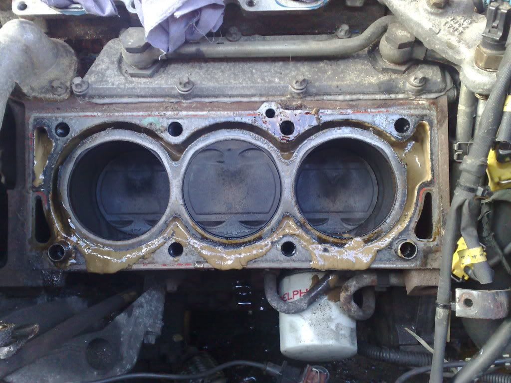

well I've only taken the front head off today (owning to breaking several tools on a headbolt
, replaced with teng
) and all the oil ways all look clear, however judgement to be witheld until tomorrow when I take the other head off... got a picture of the state of play with the head off.
Look at that goo...
And found some other pics today I took at the garage of the welding and the general underbelly.

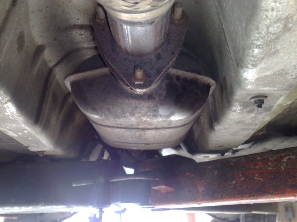

The movement in the center box as a result of the gearbox change...
This looks a bit messy, but I said I'd tidy it up to keep the bill down...

Looks like a caramel chocolate bar has been melted in the engine.

Nah it's fairly easy with the heads off... but seems fine. With respect to this I'm almost 100% sure of the situation... a hole has been located at the bottom on the front facing side of the radiator and discolouration on the heads connecting the oilway and waterway indicate that the car has lost most of the coolant then overheated causing the reduced pressure in one system and higher pressure in the other is the reason, so I whip off the header cap and the pressure released sprays the resulting mix out in a Pompay effect. But most of the oil seems clear of contamination so I think put her back together and a flush of both systems...
